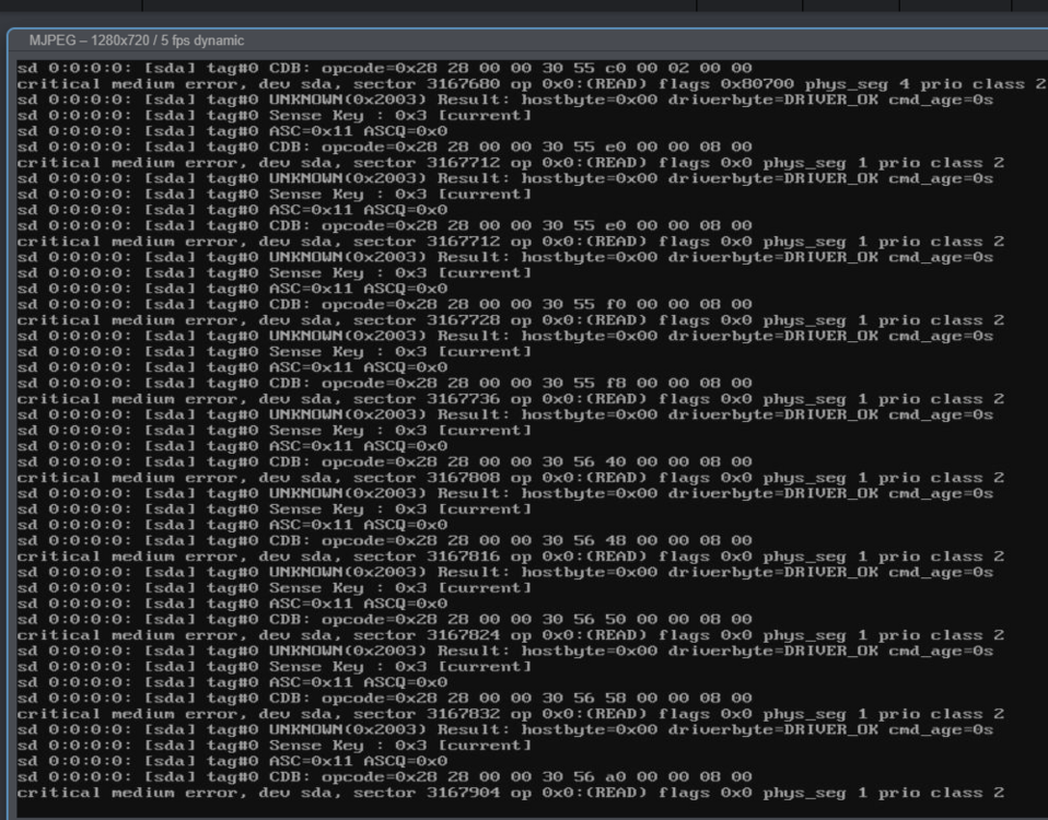

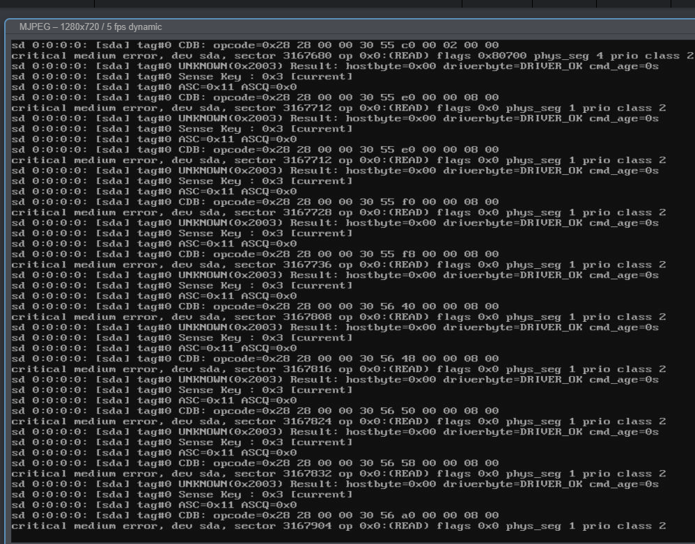

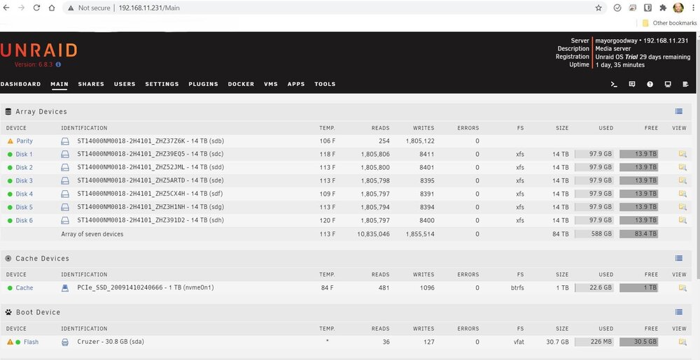

Critical medium error, dev sda
Got a pretty good error this evening, looks like it's hardware related.

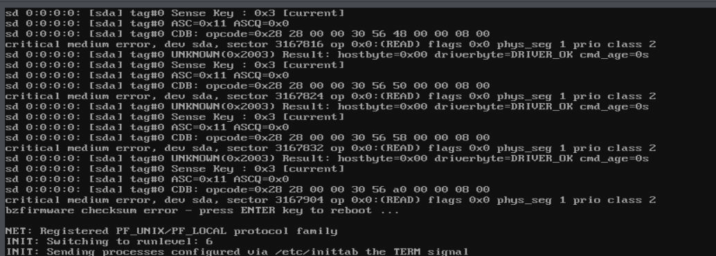

Went to boot to safe mode, GUI no plugins, got the same error.
It looks like it hates drive sda, I suspect that's what I'll need to pull to get this back up and running.
I hope I snapped a screen shot of the Main screen with drive assignments!... <fingers crossed>
Edited by rutherford

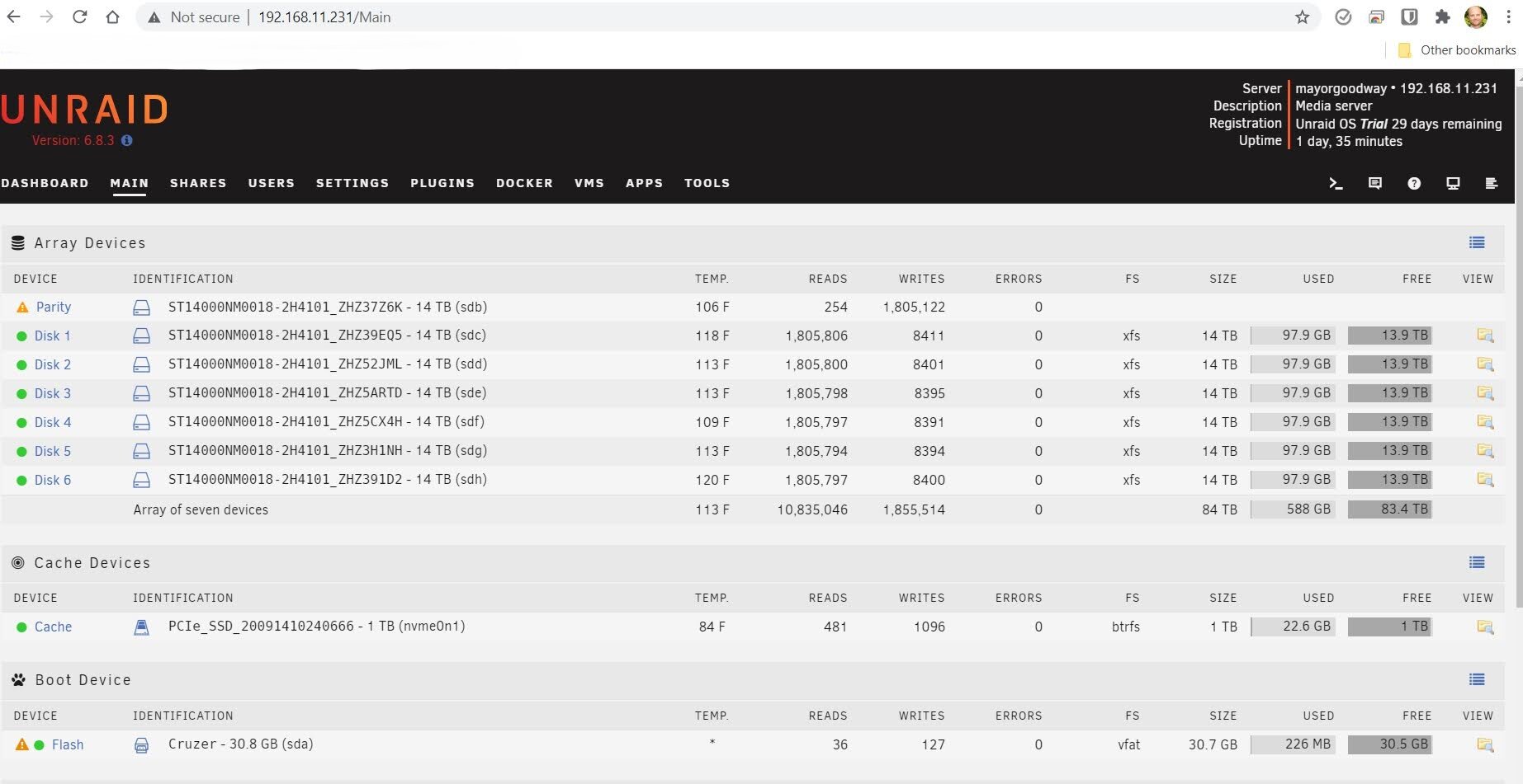

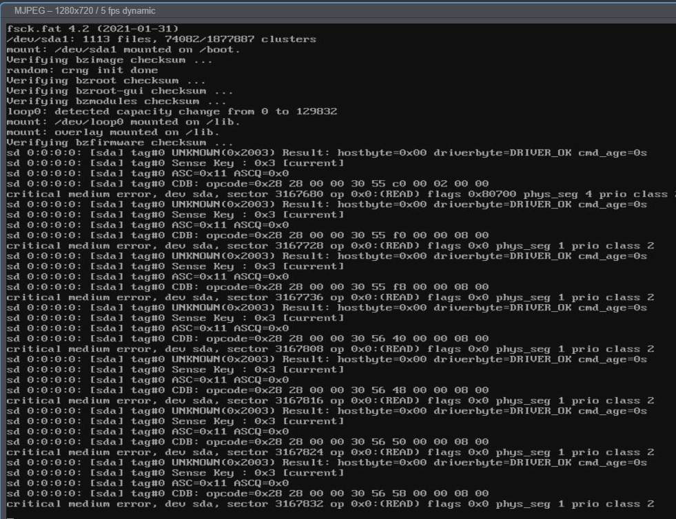

sda is my flash drive, derp! Hope I was backing that up. Now to figure out how to restore it... let's try the slick new unraid.net backup thing...

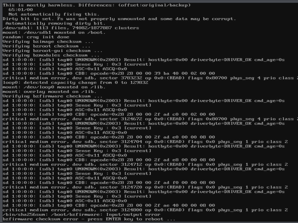

tried a different USB A outlet on the motherboard, errors, says sdb this time. That's one of the drives, my parity drive ending ZHZ37Z6K. I'll try pulling that sata cable.
swapped to new usb flash device, came right up. Guess that was the issue. Now if I can get back to where I was!...
