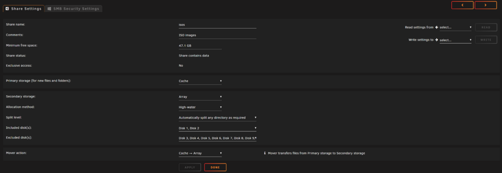

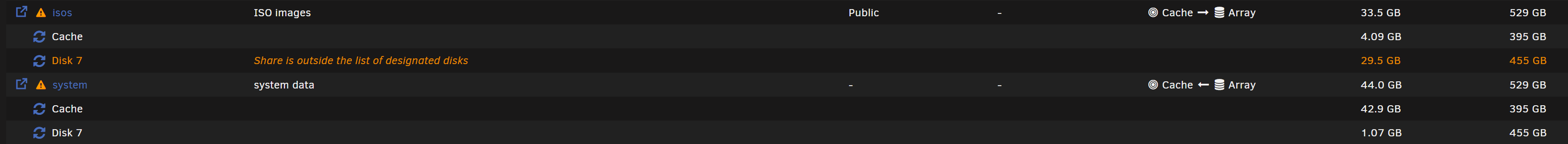

  • I use the default 'isos' share to put some OS isos. This share was configured to only use 2 little 32 GB SSDs. But, unRAID wants to use an another disk? What I don't want. The'system' share is doing the same. If I change these shares configuration, unRAID yell at me saying that "Share is outside the list of designated disks". I searched for tutos, but I don't understand what to do.

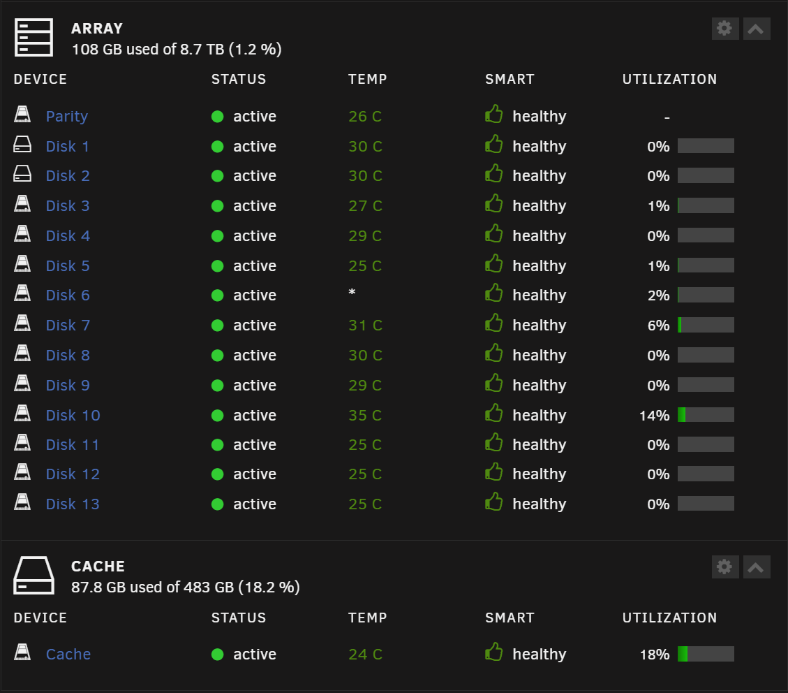

Here is my array, parity and cache:
As you can see, I don't really use the server as it is supposed to. I'm just testing if it can hold my purposes.

Here, the "isos" share configuration:
I would like to know how to move what is on the Disk7 to an another one, and manage the shares like I want:
  • ISOS = on the 2 PNY 32GB SSDs only (Disk1 / Disk2)

Normally you would only use Included OR excluded disk setting on a share.   When you change the share settings then this will apply to new files - it will not cause existing files to be moved automatically.
If you already have files for the share on other drives then you need to manually move them.  The Dynamix File Manager would be the easiest way to do this.

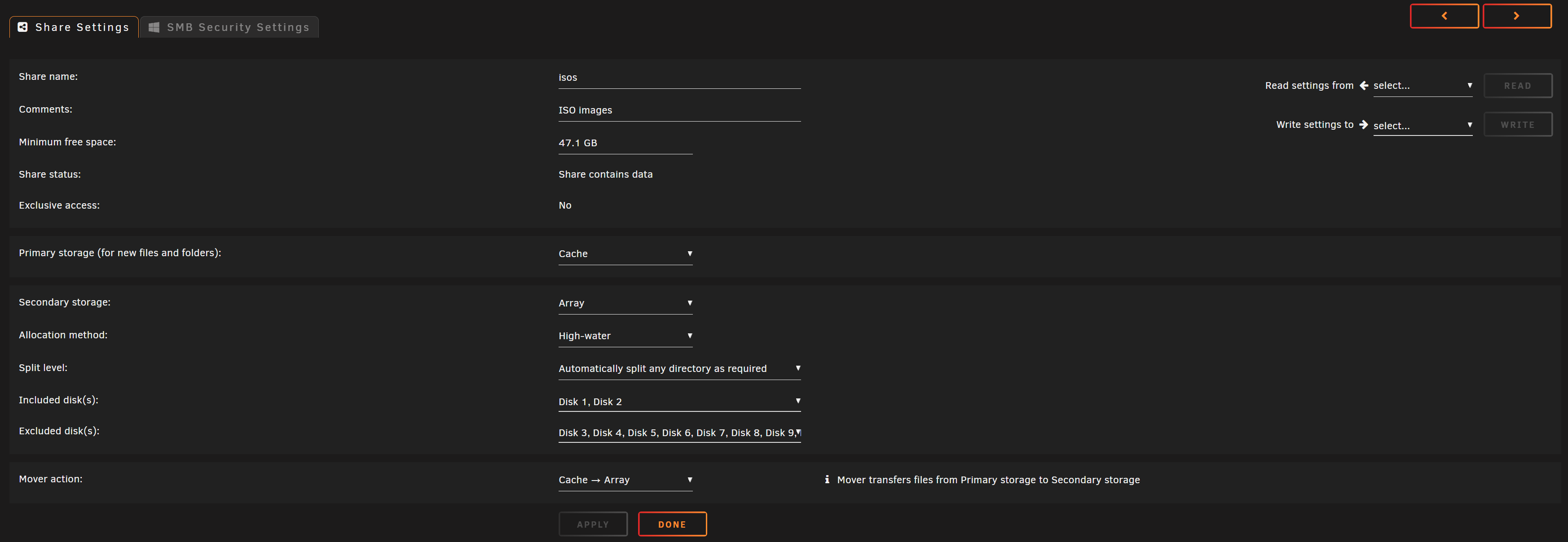

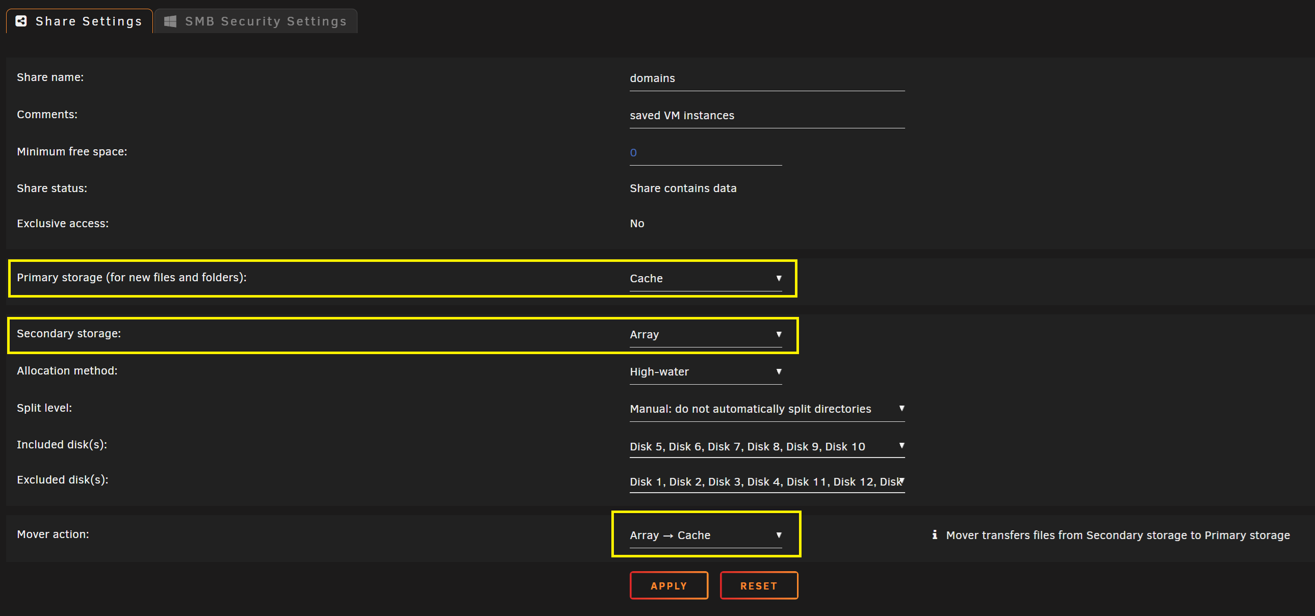

- and... all my stuff moved from the array to the cache! Oo'
I think it's not a normal way. And I think I found why:
So, I changed some parameters, and launched a 'mover' once again... and some of the stuff moved to the array again. Great.
Then, I used your app "Dynamix File Manager". I had to create some root folders and give permissions to move exactly as I would. And it seems to work. I can laucnh normally my instances.

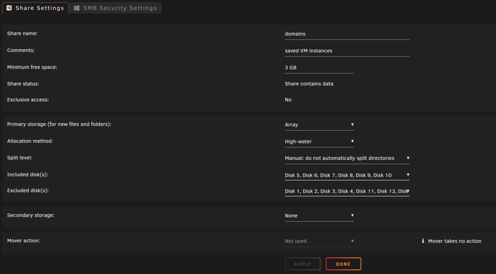

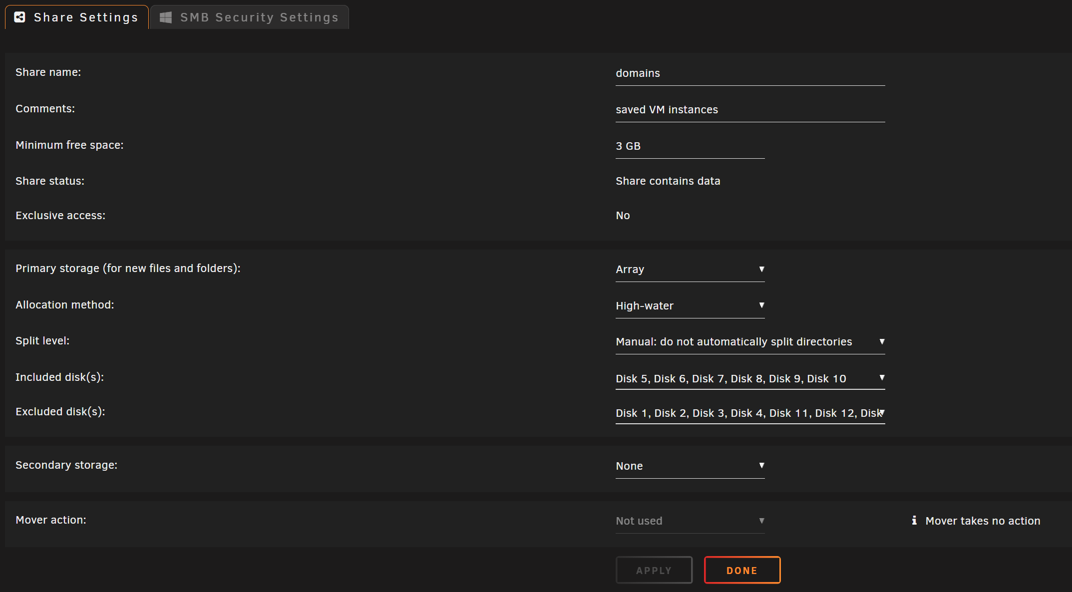

And finally, I modified shares parameters, to make stuff only on the array, except 'appdata' and 'system'.
Example for 'domains':

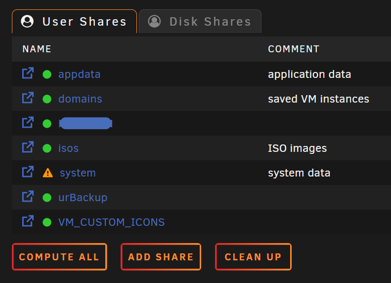

 And all my shares are happy:

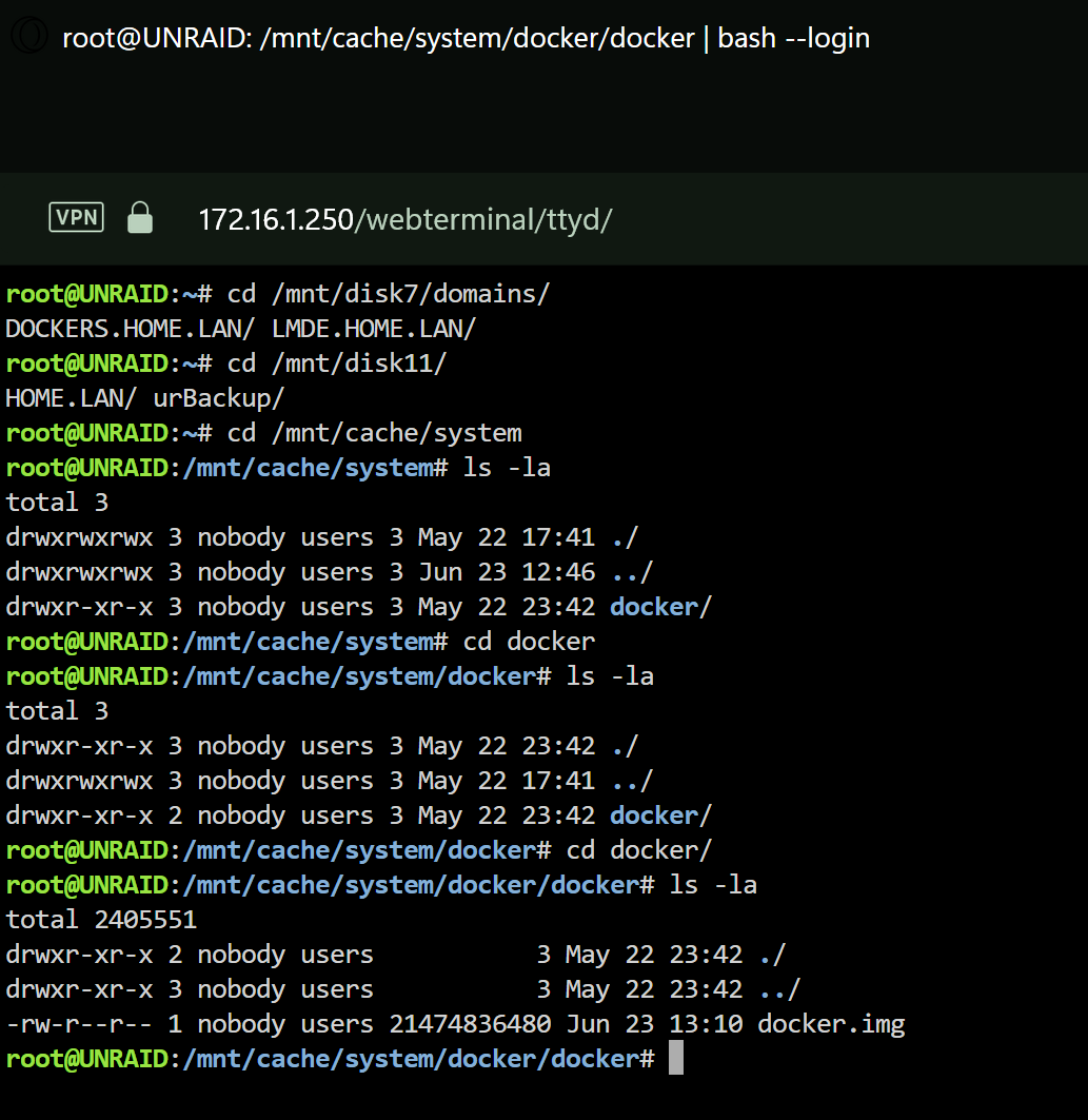

Except 'system'... after some searches, I found some files in a 'docker' folder, caintaining itself a second 'docker' subfolder':
What should I have to do with? As 'mover' seems not doing anything...
