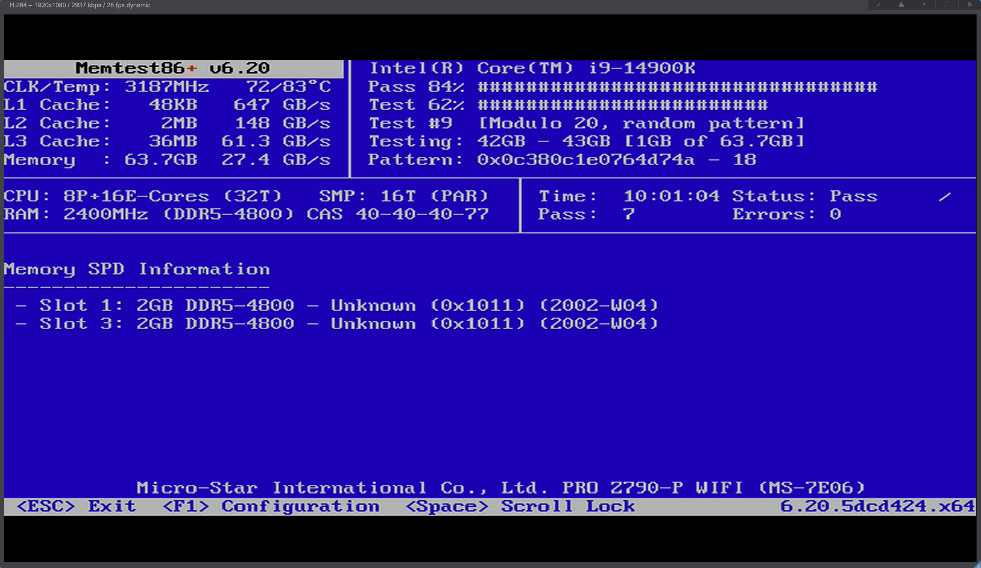

June 13, 20242 yr Author I appreciate the prompt response, Jorge. I ran memtest overnight, as I thought that was probably the best place to start. No errors. Are you saying I should run memtest again with each one of my ram sticks individually, even though I didn't get any errors? Just wanted to make sure I understood.
June 13, 20242 yr Community Expert 2 hours ago, Zacaronii said: Are you saying I should run memtest again with each one of my ram sticks individually Nope, run the server with just one stick or RAM, if the same try the other one.

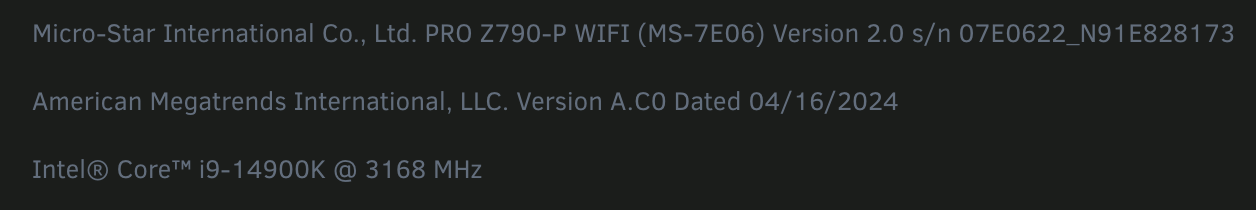

July 15, 20242 yr Author Okay, so the only thing I haven't done at this point is replace my CPU/Mobo. HOWEVER, I'm becoming pretty convinced my CPU is the root cause, at this point. Just to recap everything I can remember that I have done, so far. It's sort of a random list of things, but I have been trying everything I come across that I think might help. It's been a tough problem to pin down. - I replaced my ram - I replaced sata expander with LSI 9300-16i - I ran checks/scrubs on all my drives - I deleted my docker.img and rebuilt it (made it a docker directory, as well) https://wccftech.com/intel-13th-14th-gen-cpu-gaming-stability-investigated-chips-being-returned-in-korea/ I've been seeing more and more sources talk about these issues with 13th/14th gen k series intel chips. I am running an i9-14900k. What really got me about the video, above, is they discuss reports from game server providers running linux servers with these chips. Anyways, I'm not sure what I can do at this point. I'm going to continue to dig and see what I can do to stabilize the system if this really is my problem. Just want to try to catalog things here for posterity. Edit: The more I read about this stuff, the more certain I get that this is the root cause of my issues. Especially as I see some people saying that they ran theirs for a couple of months until issues started to appear. That's pretty much my situation. I installed this thing back in February sometime and I started having issues at least in early May. I'd love for someone to prove me wrong. Going to keep trying to look at potential solutions around this for now. Edited July 15, 20242 yr by Zacaronii
July 28, 20242 yr Author Solution Just a little update. I think I am going to mark this as the resolution, but I will follow up if I find that I have any valuable info to provide after this. Intel has confirmed the issue on 13th/14th gens. They are going to be releasing a microcode update in mid August to mitigate the issue. https://community.intel.com/t5/Processors/July-2024-Update-on-Instability-Reports-on-Intel-Core-13th-and/m-p/1617113 However, they have also confirmed that this is a preventative measure, and that affected CPUs won't be "fixed". I will say, my mobo provider had a more recent bios update that I applied the other day, and I haven't had a crash since then. I'm sure intel's board partners are doing whatever they can while they wait for intel to implement the microcode patch. I'm weighing whether I am going to attempt to RMA mine at this point. I think I'm going to wait for the bios update in August for now. This article touches more on the potential permanent damage to affected CPUs. https://www.techradar.com/computing/cpu/intel-admits-damage-to-unstable-14th-gen-and-13th-gen-cpus-is-permanent-incoming-patch-is-a-preventative-not-a-cure
