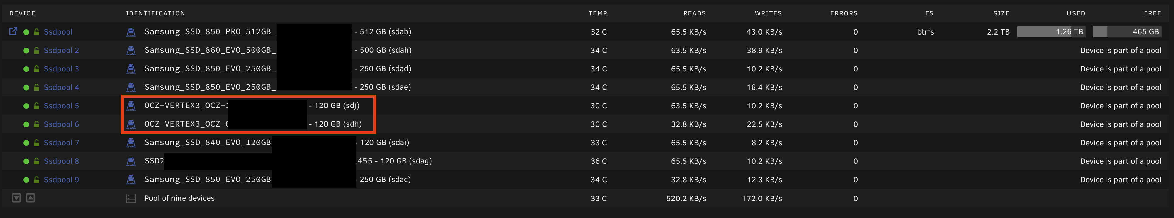

Hello, how can I access data (mount?) on a single disk within a pool without removing them from the pool or stopping the array?
I have an "ssdpool" which is a secondary pool to my primary. I have two old, nasty disks and I wanted to replaced them. I wanted to first mount them and move the contents off so that when I insert the replacement I can move the data back. I was hoping to be able to browse the data on these specific devices while the array was still on but I cannot figure out how to do this.

I'm trying to replace 2 drives with 1 larger drive. Those two vertex drives out and one 2tb ssd in. I get the replacing of one drive at a time but how to rebuild it after I permanently remove the second drive? Thanks again for your help.
