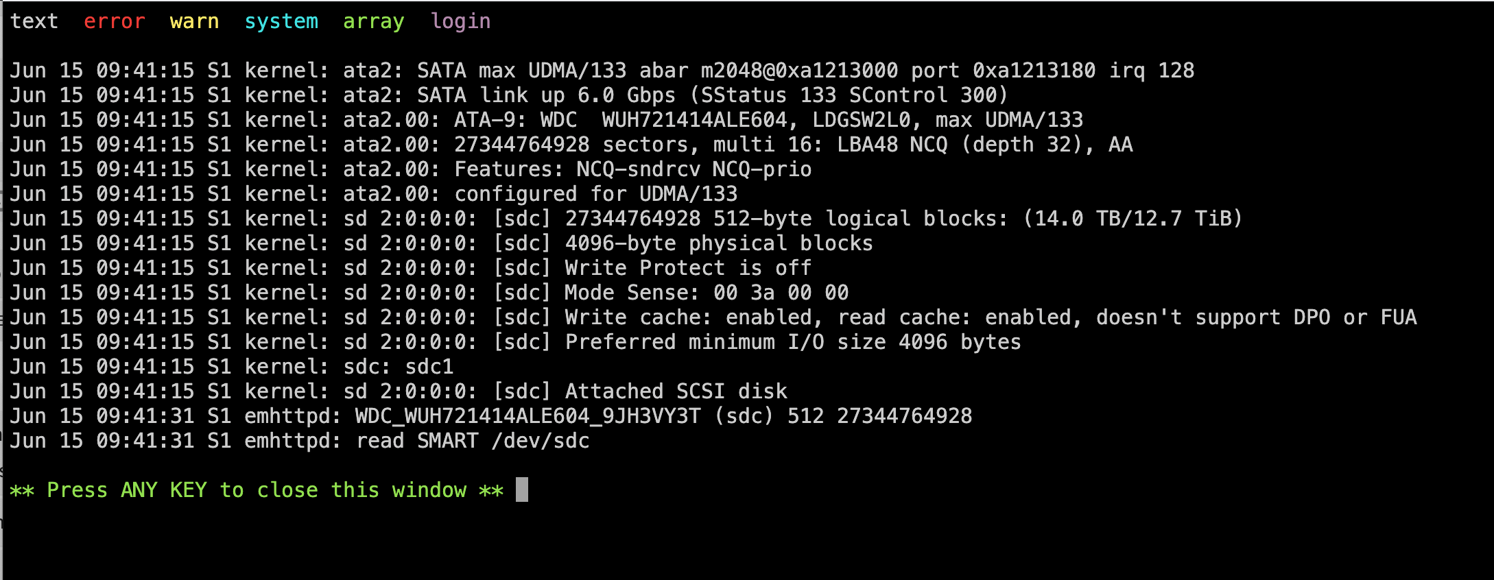

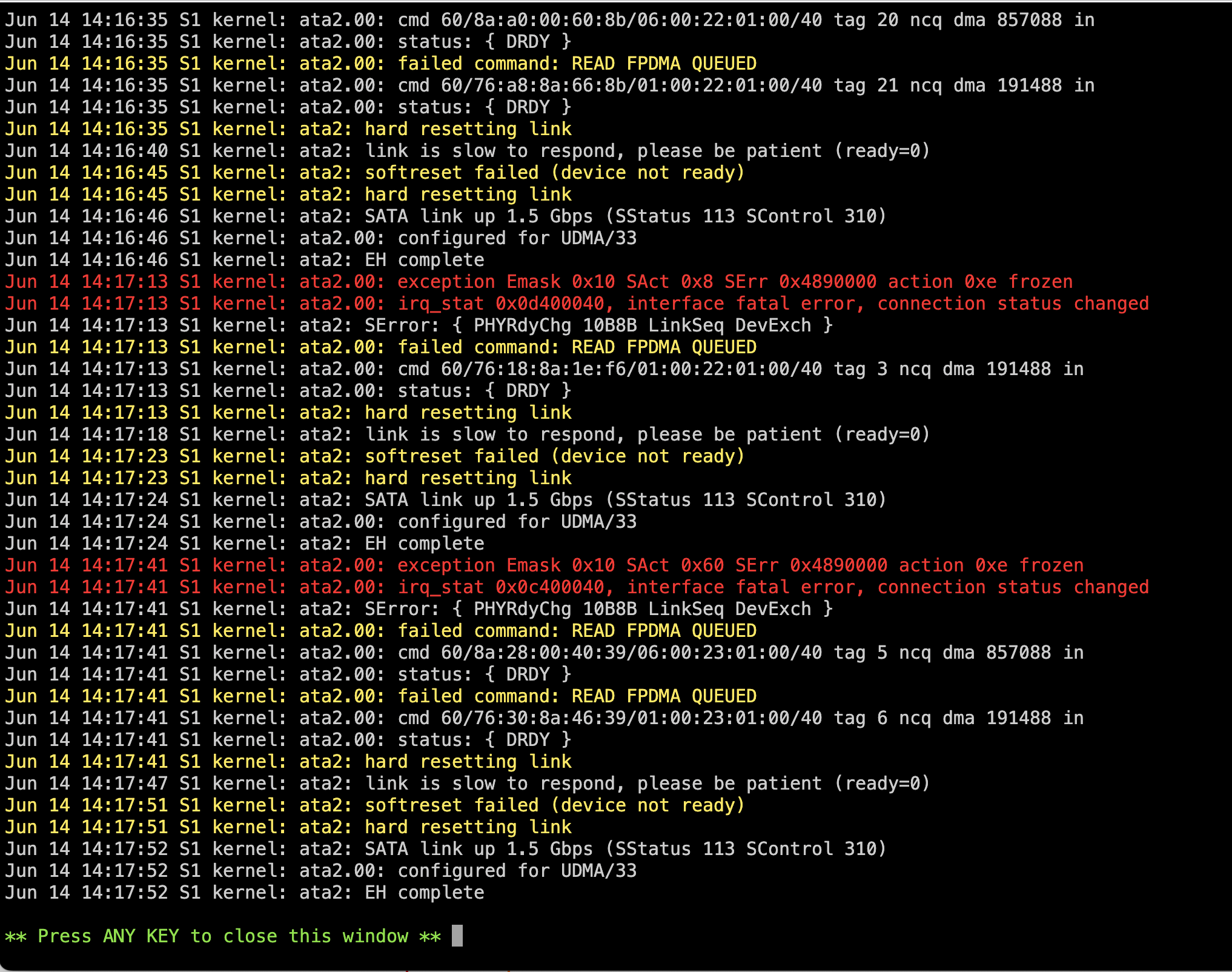

Quick update: I've been running xfs_repair -L on the new 14TB hard drive (sdc) that I previously attempted to add to expand storage. The drive is currently not mounted and not part of the array (marked as "not installed" with a red X). Unfortunately, I'm back to being unable to write to the array. The screenshot bellow is what I get from disk log information.  image.thumb.png.8bdfc57c2dd5b469bca430820fb8d21f.png
Edited by denyson
There are constant ATA errors for all 4 disks, since they use two different controllers it should not be that, could be a power problem, any power splitters? Unlikely that there are 4 bad SATA cables.
I don't have the necessary equipment to test this at the moment, but I've ordered a new power supply that should arrive overnight and will be here by morning. Should I cancel the ongoing xfs-repair operation?
I would not recommend trying any repairs without first fixing that issue.

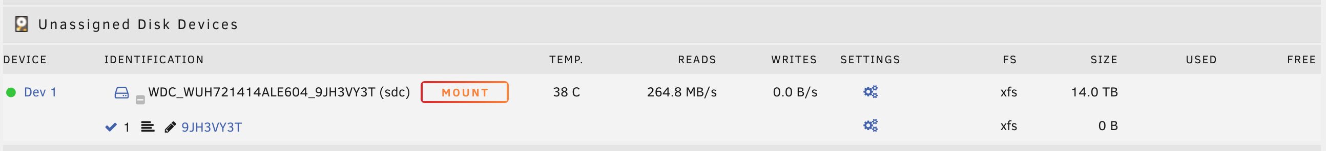

I've replaced the power supply and all cables, and I'm no longer seeing ATA errors. I'm currently running xfs_repair -v on the new 14TB drive I plan to add to the array. If everything goes smoothly, I'll proceed with adding it to the array. Screenshot2024-06-15at9_54_28AM.thumb.png.5832d3ac98967dd43e3d233653314b3e.png

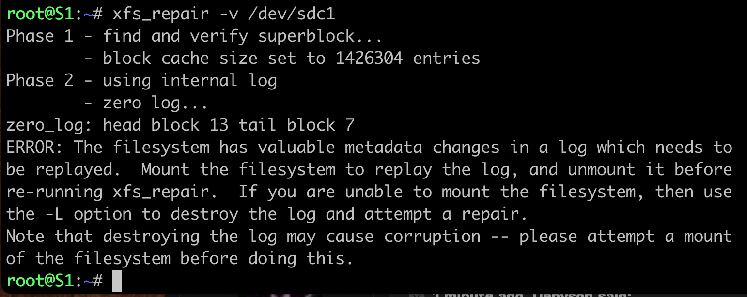

The disk is currently showing up under Unassigned Devices, and I'm unable to use the GUI to run xfs_repair. Instead, I'm using the command xfs_repair -v /dev/sdc in the terminal. I've followed the instructions in the Unraid documentation  https://docs.unraid.net/legacy/FAQ/check-disk-filesystems/. Please review my progress and advise if there are any additional steps I need to take. image.thumb.png.da539676d00524d5216ce845aa50ca9d.png
I'm also concerned that the repair process is taking a very long time, but I suppose it's to be expected given the large size of the disk.
Edited by Denyson
You are looking at obsolete documentation!   That command is incorrect as you need to add the partition number (/dev/sdc1).
Still do the -v but add the partition number?  Like this: xfs_repair -v /dev/sdc1
Yes.

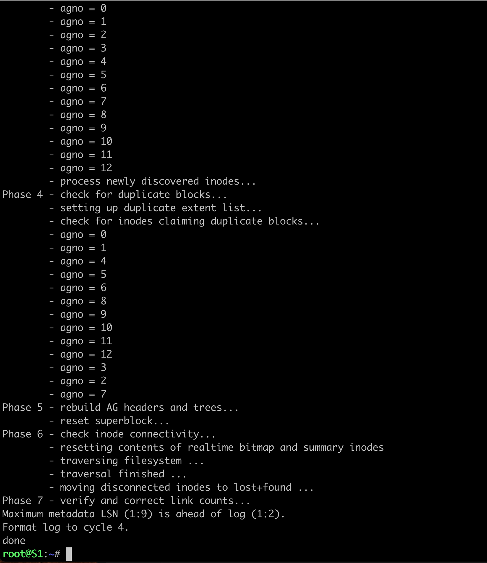

No, it is telling you to rerun adding the -L option.
This is what I got. Can I add this back to the array or what are the next steps that I need to take.

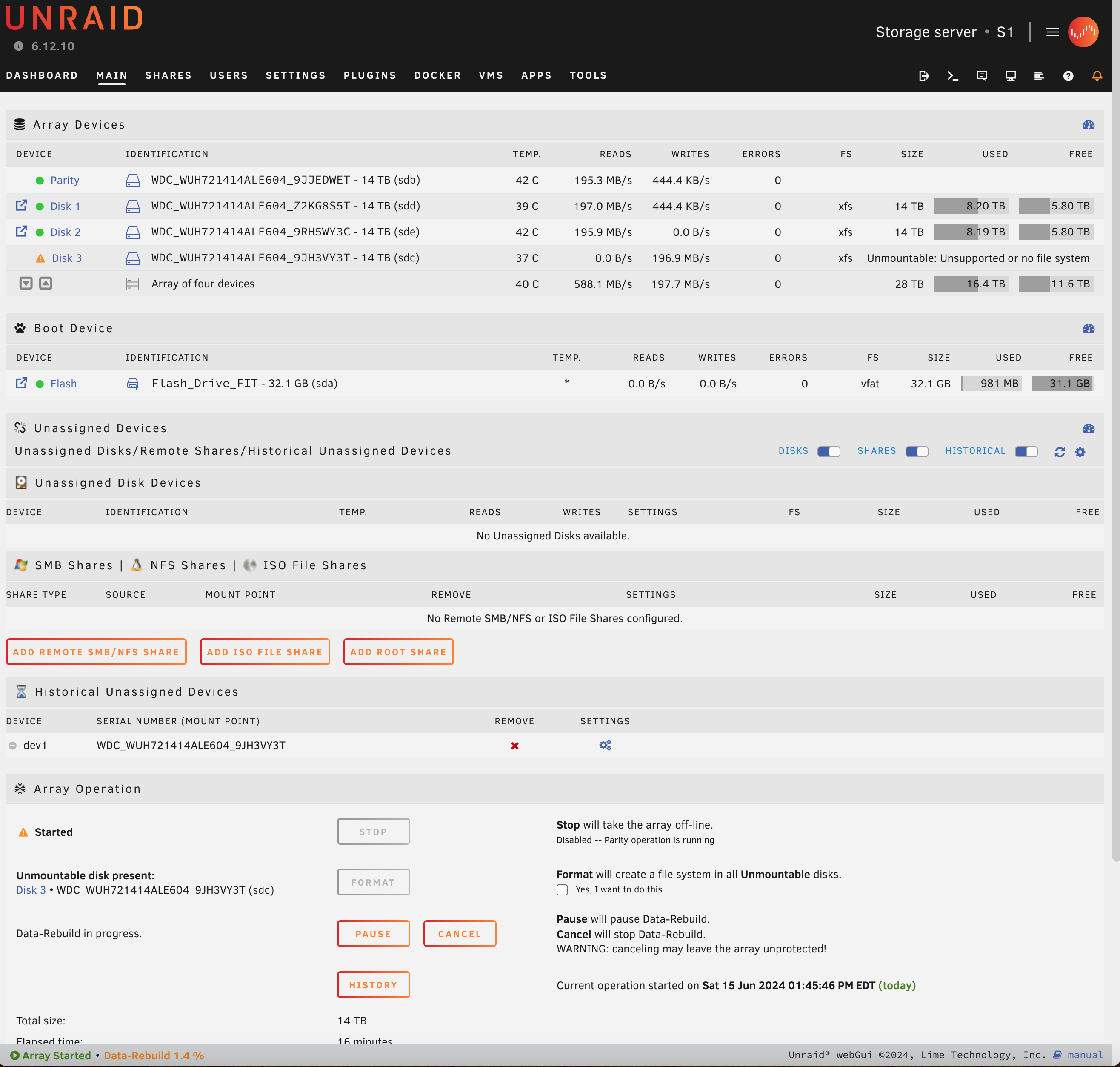

I've added the drive back to the array. It says the array is rebuilding but the drive still shows up under Historical Unassigned Devices. Im also concern on the Size Used Free says "Unmountable: Unsupported or no file system" Please advise if there are any additional steps I need to take.
Did you use the New Config tool to add the drive which is what you needed to do to keep the data on the drive intact. If not then Unraid will be clearing (zeroing) the drive to avoid invalidating parity.
No I did not. What I did its stopped the array and added the drive as disk 3 from the drop down menu. Started the array back up. I don't think there was anything on it. Is there any documentation on how to use this new config tool? I'll need that procedure to add another drive in the future.
If there was nothing on it then you do not need to do anything, but when the Clear finishes you will need to reformat the drive to get it ready for use.   If you did not want the data I have no idea why you were trying to run xfs_repair as the rebuild process deletes any existing content.
The New Config tool is covered in the online documentation accessible via the ‘Manual’ link at the bottom of the GUI or the DOCS link at the top of each forum page. The Unraid OS->Manual section in particular covers most features of the current Unraid release.
Looks like you are rebuilding on top of the old disk, this will rebuild the emulated disk, not the repaired filesystem from the actual disk, so this was not the best option.

I attempted the repair by following the Unraid documentation from the link above, which I now know is inaccurate. Moving forward, after completing the zeroing operation, the plan is to not format the drive and see if it gets added back to the array. However, if it doesn't get added to the array and still shows as 'Unmountable: Unsupported or no file system', what steps should I take next?
Any time you add a new drive to an existing parity protected Unraid array it will show as unmountable until you have formatted it from within Unraid after adding it.
