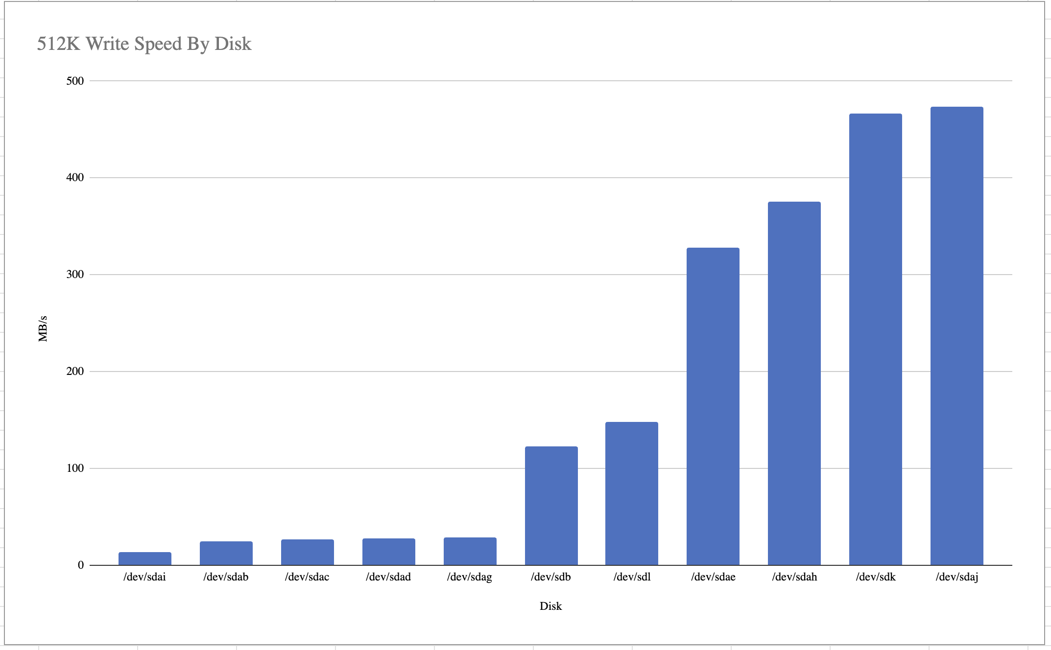

Hi, I have several ssds that are to be added to an ssd pool. I did a perf test on them to see if I had any slow disks...and uhhh...it seems I have some VERY slow ssds. They start off writes around 500MB/s+ but then get down to 20MB/s or lower after a bit. I realize there is some slowdown expected but this is very slow and it's not across all disks. Some of my oldest, cheapest disks have no issue sustaining writes of over 100MB/s, any ideas?

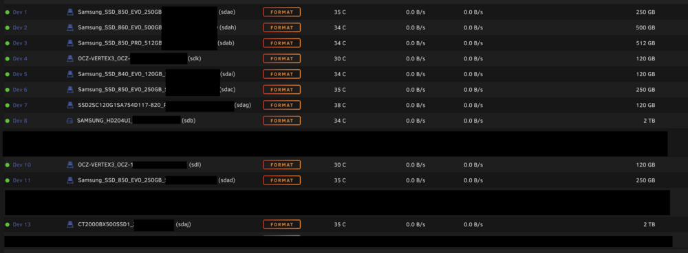

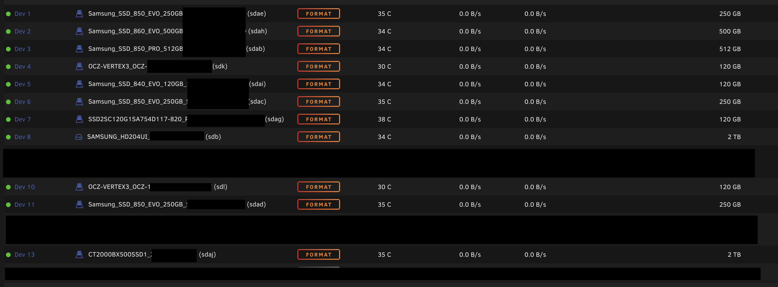

Attached the full output and the script used to test the devices, along with a screenshot of the device IDs and models so you can see which drives are so slow.

Gonna do some testing with the SAS connections. Perhaps I have a bad cable or rail or setup. Will double check. Here's a pretty telling story
