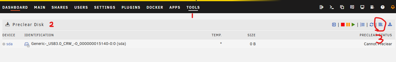

I have unassigned my parity drive and already installed preclear app. Still can't see where I'm supposed to go to erase the disk...
What am I missing?

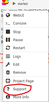

You should be asking this in the support thread fro the Plugin/Docker that you installed.  For plugins, the link for the support thread can be found on the 'PLUGINS' tab.   For Dockers, go to the 'DOCKER' tab and left-click on the Docker Icon.  Then look for the link:

It's working now; Turns out that it wasn't installed correctly.

I didn't see anything.  Lets see if there is a preclear log.  Look here for that:
