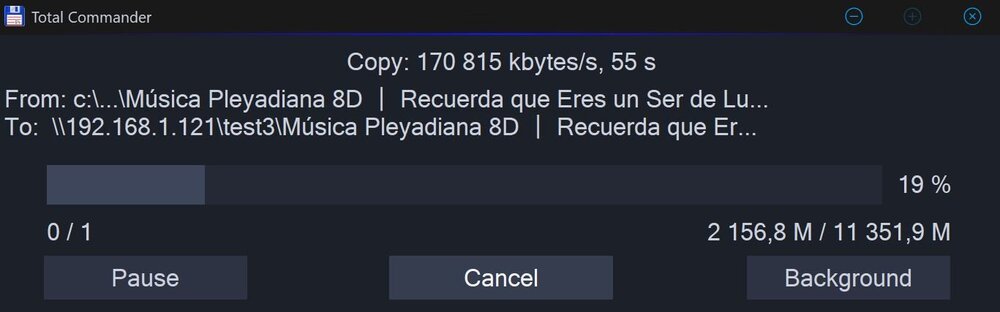

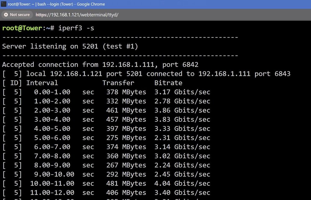

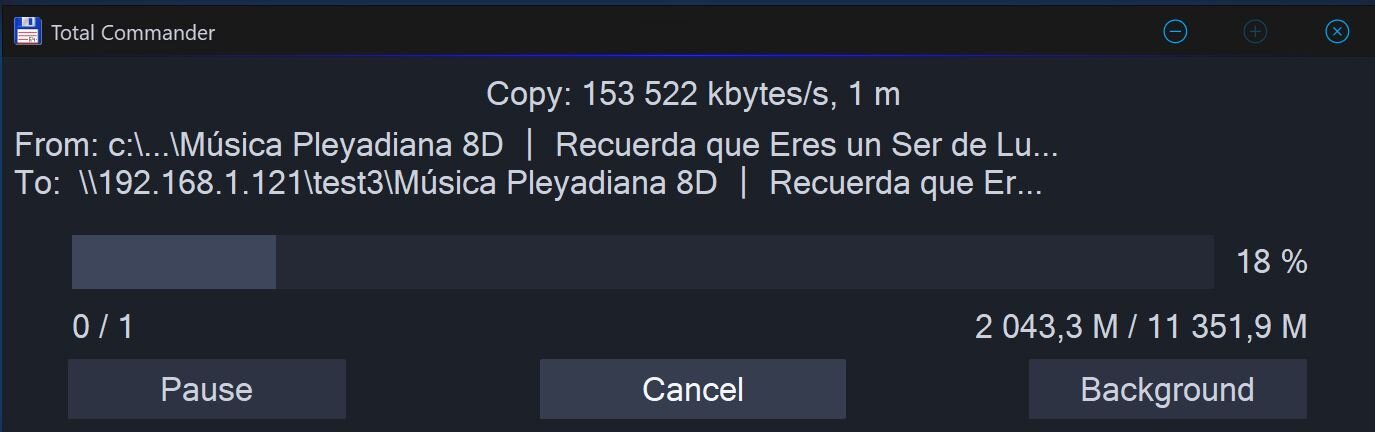

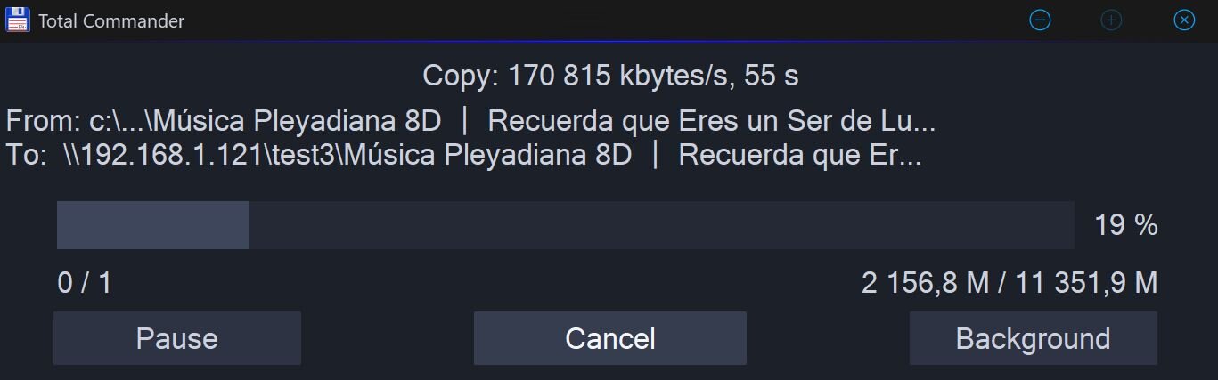

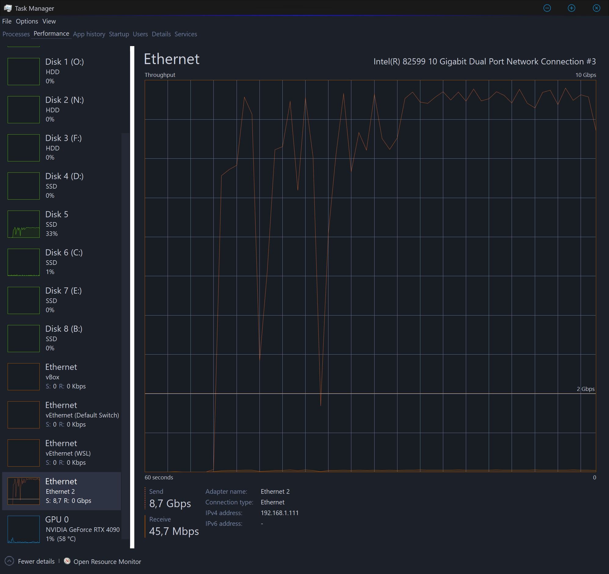

Hello, I have moved my unRAID server to the new hardware but got strange issue with 10gbit LAN:

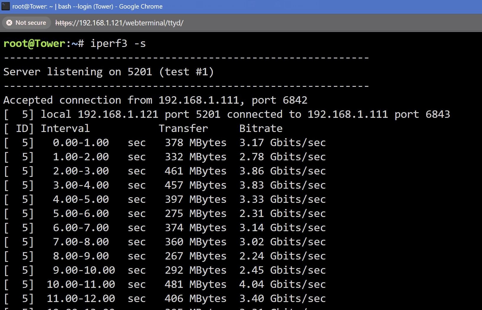

- iperf3 shows only ~2.66gbits/sec on the test;
- copying files over lan to nvme share also slow as ~170-210mb/second.

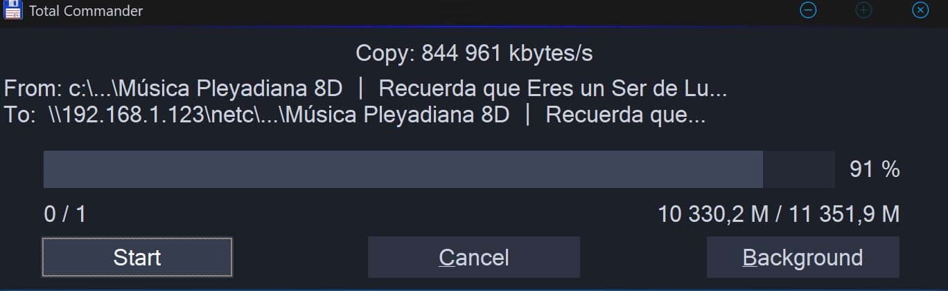

At first - before moving the HDD's - I have installed on that new server hardware Windows 10 pro - on internal m2 nvme SSD (Samsung 990 pro 2tb) - and checked everything including my network and ssd speed - and it worked just fine:
- I had copy files speed ~1+gb/sec (10gbit)
- somewhy iperf3 showed half of my connection speed - no idea why (mb bugs?), copying files over the lan were fine
After these tests I plugged in my unRAID HDD drives and booted from the unRAID flash, network still connects 10ggbit full duplex but performing speed is low. So by these tests I'm assuming that hardware is fine and there is some unRAID miss-configuration, Is there anything I can do to find the root of the issue?

If the iperf test does not give you the speed you expect then you have a network related issue constraint performance and that needs resolving first.
iperf is just standalone piece of software that I expect could have many bugs.
Did you mean that I need to post bugreport to the iperf github first and wait for resolution before accepting the proof of work with direct files copying on windows and debian?
Actually I was thinking about posting a bugreport to them but I got deleted Windows already so I will be unable to do some additional tests they will require for sure.
Do not force the switch to 10G!
If autonegotiation does not work correctly, there is something wrong with your hardware.
Go and investigate!
Also, there maybe a problem with the Intel Driver (my faith in Intel cards is limited, I prefer Mellanox), see if you can find a special one in the App section.
Iperf is usually ok, it does not lie much.

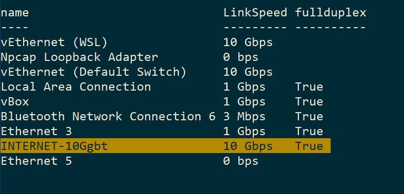

You should check the iperf result at client side and not on server side, your windows show TX near 10Gbps.
at my side iperf3 shows same speed no matter who is client and who is the server - I though that it should work like that by it's nature?

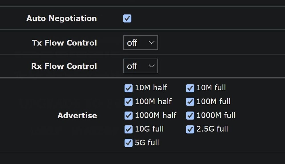

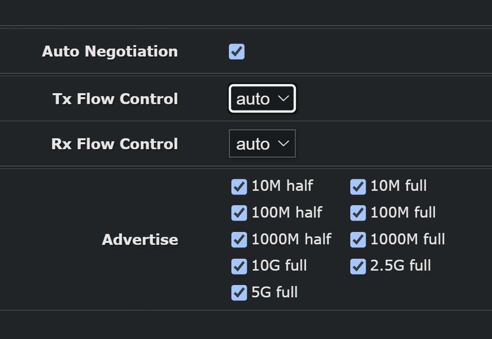

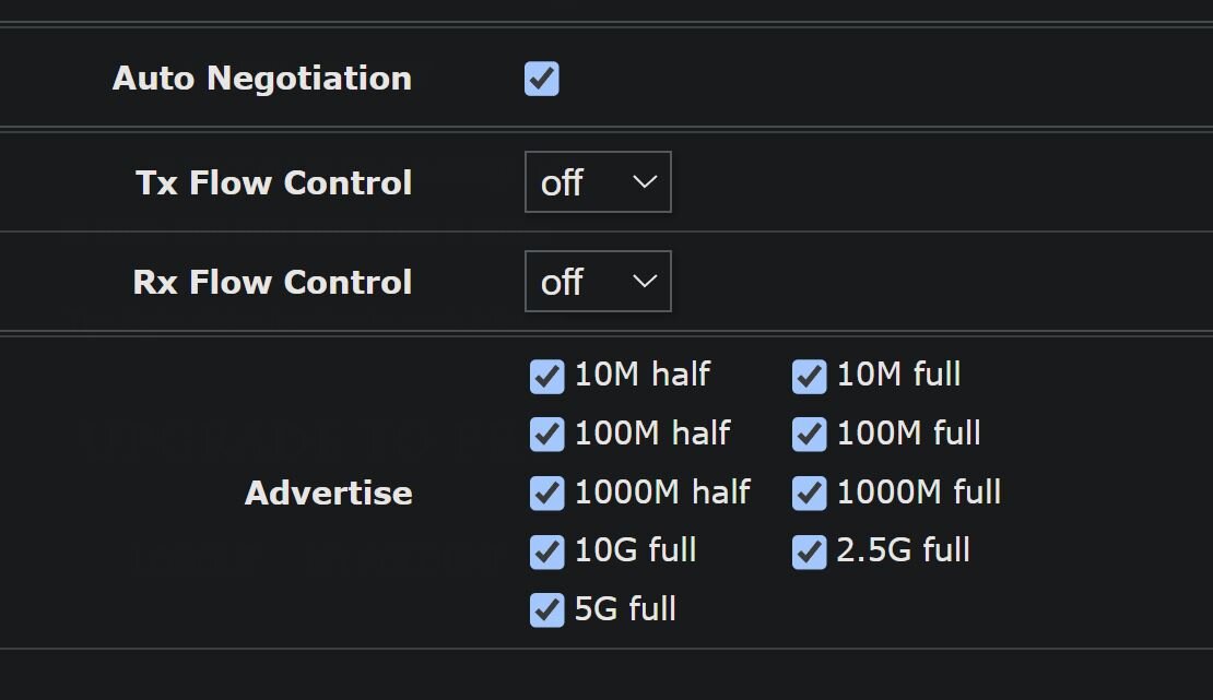

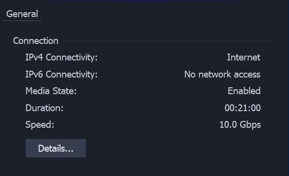

I tried turning on the negotiation on the Mikrotik switch and restarted both - switch and unraid server, but it still saying there is no negotiation and connects 10gbit full duplex.
2024-06-15 18_32_58-NA - Interface _sfp-sfpplus5_ at admin@192.168.1.44 - Webfig v6.49.7 (stable) on.jpg

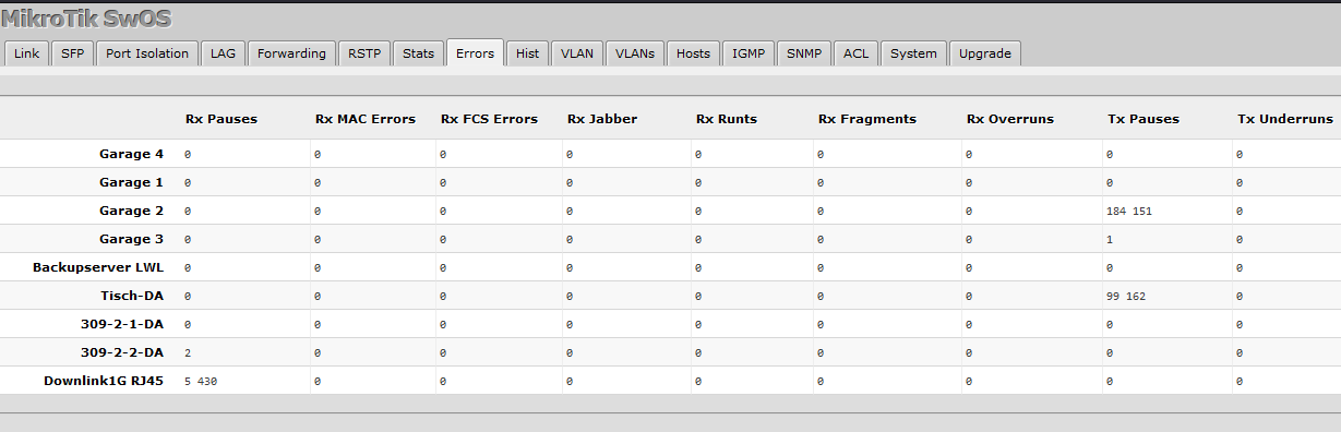

You need to allow flow control in both directions (btw, where is that screenshot comeming from? its neither windows, nor unraid nor mikrotik ???)
Do you run the switch with SWOS or RouterOS ?
yep it's RouterOS - at first I tried direct connection with LAN adapters between Windows <-> Windows w/o switch and it worked with copying files at 10gbps, then I added that switch and it was working fine too.

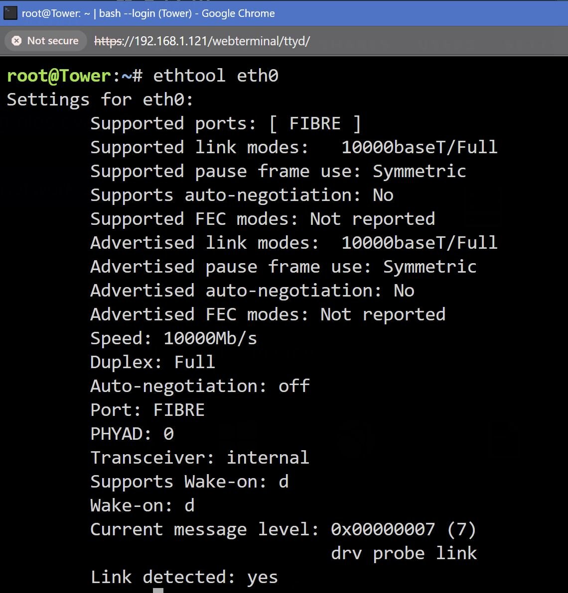

I changed flow control to auto and restarted switch - still same image on the unraid side:
root@Tower:~# ethtool eth0
Settings for eth0:
        Supported ports: [ FIBRE ]
        Supported link modes:   10000baseT/Full
        Supported pause frame use: Symmetric
        Supports auto-negotiation: No
        Supported FEC modes: Not reported
        Advertised link modes:  10000baseT/Full
        Advertised pause frame use: Symmetric
        Advertised auto-negotiation: No
        Advertised FEC modes: Not reported
        Speed: 10000Mb/s
        Duplex: Full
        Auto-negotiation: off
        Port: FIBRE
        PHYAD: 0
        Transceiver: internal
        Supports Wake-on: d
        Wake-on: d
        Current message level: 0x00000007 (7)
                               drv probe link
        Link detected: yes
2024-06-15 19_11_32-NA - Interface _sfp-sfpplus5_ at admin@192.168.1.44 - Webfig v6.49.7 (stable) on.jpg
With RouterOS I am out, too complicated for me. I only use SWOS.
Maybe your card only can run at 10G with this SFP+ module?
It only annouces 10G and negotiation is done with 10G, nothing to worry about.
You do not want less anyway :-)))
And Flow Control is essential for 10G Operation because there need to be a way to stop 10G from sending if it overruns slower ports. Also, the now becoming common 2.5G is only "10G with pauses". It depends on flow control. Without it packets use the wrong time slot and are lost at the (non)receiving side.

I purchased this network adapter because of many other forums confirmations/recommendations on it, like these - that is very sad I can't get it working with unraid:
and here:
9 hours ago, Ariloum said:
the main problem is still unresolved - unraid declines to work at 10gbe speed with that Intel X520-DA2 network adapter and barely hits 2gbps...
You may try test in parallel streams by option "-P". With two streams it reach 9.37Gbps for my X520. All my Unraid use X520 and a ConnectX-3 with Windows, so far so good.
I like OpenSpeedTest docker more then iperf3, btw both available per the need.
For Unraid network sharing not reach 10Gbps, this is other issue and you may not fix by change different type NIC.
[  4]   6.00-7.00   sec   686 MBytes  5.75 Gbits/sec
[  4]   7.00-8.00   sec   691 MBytes  5.80 Gbits/sec
[  4]   8.00-9.00   sec   691 MBytes  5.79 Gbits/sec
[  4]   9.00-10.00  sec   689 MBytes  5.78 Gbits/sec
[ ID] Interval           Transfer     Bandwidth
[  4]   0.00-10.00  sec  6.71 GBytes  5.77 Gbits/sec                  sender
[  4]   0.00-10.00  sec  6.71 GBytes  5.76 Gbits/sec                  receiver
[  4]   8.00-9.00   sec   583 MBytes  4.89 Gbits/sec
[  6]   8.00-9.00   sec   538 MBytes  4.51 Gbits/sec
[SUM]   8.00-9.00   sec  1.09 GBytes  9.40 Gbits/sec
[  4]   9.00-10.00  sec   582 MBytes  4.89 Gbits/sec
[  6]   9.00-10.00  sec   534 MBytes  4.48 Gbits/sec
[SUM]   9.00-10.00  sec  1.09 GBytes  9.37 Gbits/sec
[  4]   0.00-10.00  sec  5.68 GBytes  4.88 Gbits/sec                  sender
[  4]   0.00-10.00  sec  5.68 GBytes  4.88 Gbits/sec                  receiver
[  6]   0.00-10.00  sec  5.24 GBytes  4.50 Gbits/sec                  sender
[  6]   0.00-10.00  sec  5.24 GBytes  4.50 Gbits/sec                  receiver
[SUM]   0.00-10.00  sec  10.9 GBytes  9.38 Gbits/sec                  sender
[SUM]   0.00-10.00  sec  10.9 GBytes  9.38 Gbits/sec                  receiver
