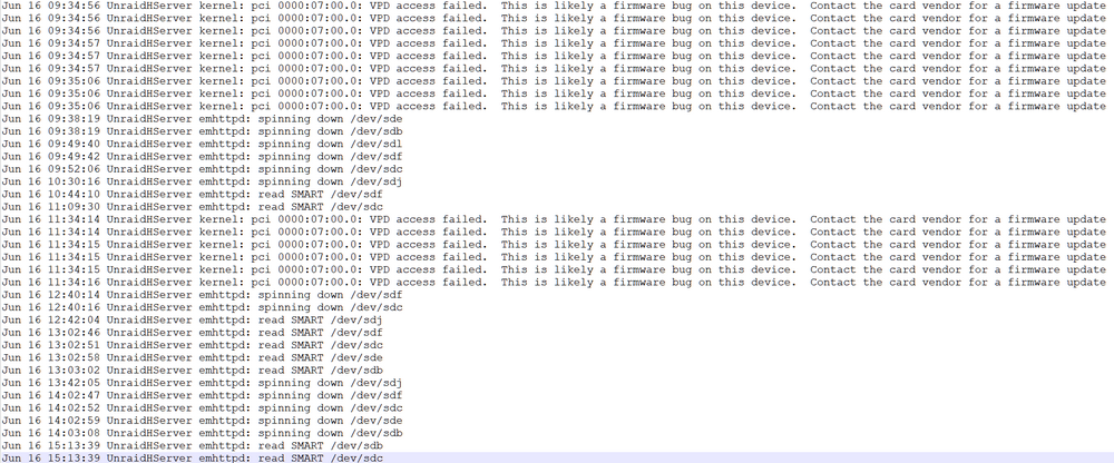

My unraid server been unresponsive randomly
Hi guys, need some help to see if anyone has encounter this before and if there are solutions available

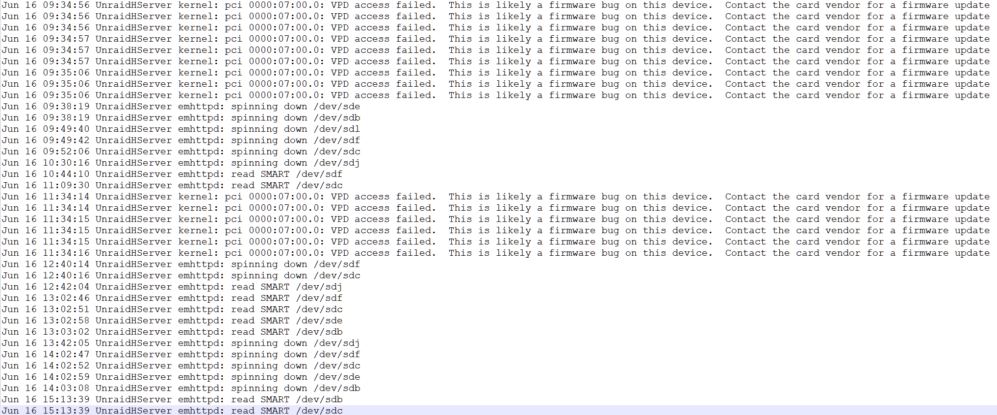

the last line is always Jun 16 15:13:39 UnraidHServer emhttpd: read SMART /dev/sdc but the device sdc is different each time. Not sure what this entails.
thanks for the help in advance
That's not relevant for a crash, post the complete persistent syslog.
hi i am not sure if i am doing this correctly but here is the syslog dump onto my flash
syslog
Which device is this?
Jun 16 11:34:15 UnraidHServer kernel: pci 0000:07:00.0: VPD access failed.  This is likely a firmware bug on this device.  Contact the card vendor for a firmware update
