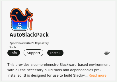

On 6/17/2024 at 4:46 PM, amix said:
As stated, I have no way to compile from source in the foreseeable future. Containerizing would still require to build a binary from source.
Have you yet seen @SpaceInvaderOne's container where you can easily build from source in a Docker container:
Now, that's interesting... Thanks for the pointer!
