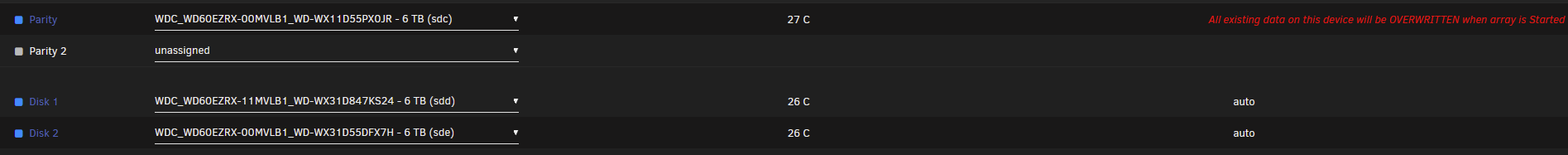

One of my drives (disk1) showed some SMART warnings so I returned it and got sent a new one. When I plugged the new one in, despite it being exactly same model of drive, it said the replacement disk was too small. After some poking around on the forums I saw someone suggesting to use "New Config" to fix this (I created a New Config preserving all current assignments). However, after doing this, it says that all existing data on my parity drive will be overwritten when I start the array and I don't want that to be overwritten as I'll lose all my data.
I haven't done anything after creating a New Config as I don't want to lose anything. Can anyone help me please?

New config cannot be used to replace a disk, it warns exactly about that.
Is old disk1 still connected? If yes, which one is it?

You can try this, but it will only work if parity is still valid:
-Assuming the array is still as the screenshot above, after the new config
-Check all assignments and assign any missing disk(s) if needed, including the new disk1, replacement disk should be same size or larger than the old one
-IMPORTANT - Check both "parity is already valid" and "maintenance mode" and start the array (note that the GUI will still show that data on parity disk(s) will be overwritten, this is normal as it doesn't account for the checkbox, but it won't be as long as it's checked)
-Stop array
-Unassign disk1
-Start array (in normal mode now) and post new diags.

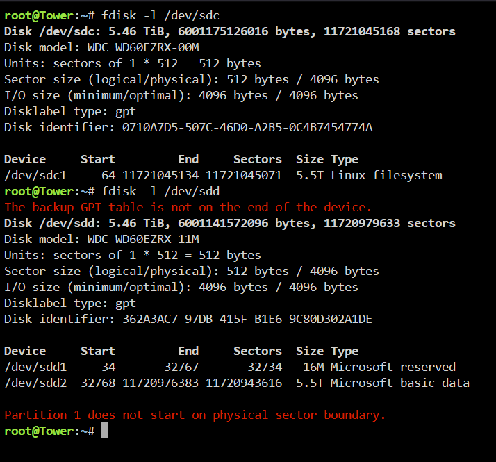

Looks like that disk really is smaller, post the output of:
fdisk -l /dev/sdc
and
fdisk -l /dev/sdd
So as you can see by the number of sectors, the disk is actually smaller, so it won't do, was this disk shucked? In any case you will need a different 6TB disk.

If parity is valid it should work, but cannot be larger than 6TB, that would require a parity swap, and for that you would need a place older disk, like the old one.
