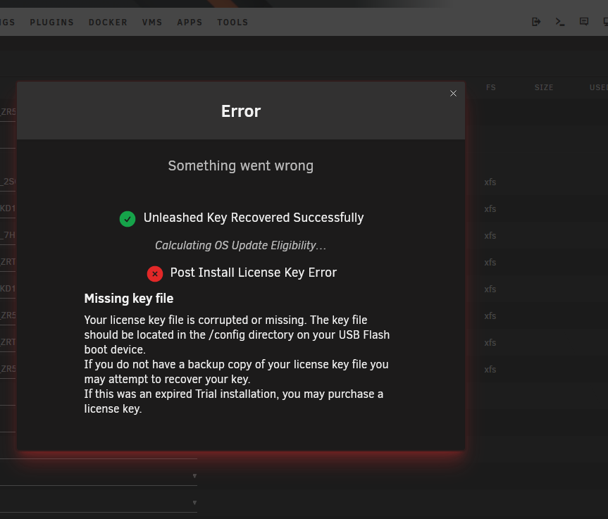

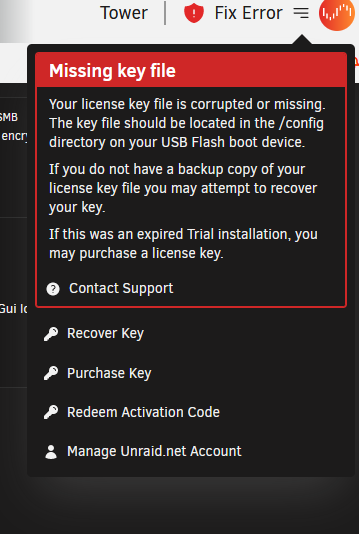

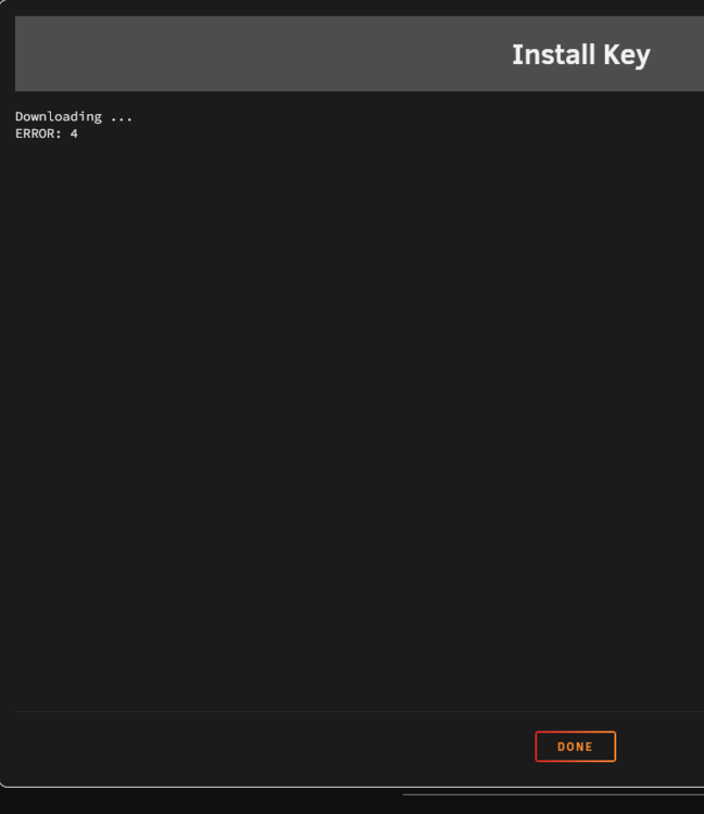

Then went to try again to reactivate my license but every which way i try and recover it I get some error, screenshots attached.
Once the server had regained internet access I figured I could reactivate my license and have even tried a new license but nothing works. really appreciate any help with this
You might want to contact Unraid Support for assistance.  Have as much detail about your old license purchase (registration E-mail address, GUID Number of the original flash drive and the new GUID number) as possible.  Explain what your issues are with the auto update process and request their assistance to resolve the issue.
       https://unraid.net/contact
