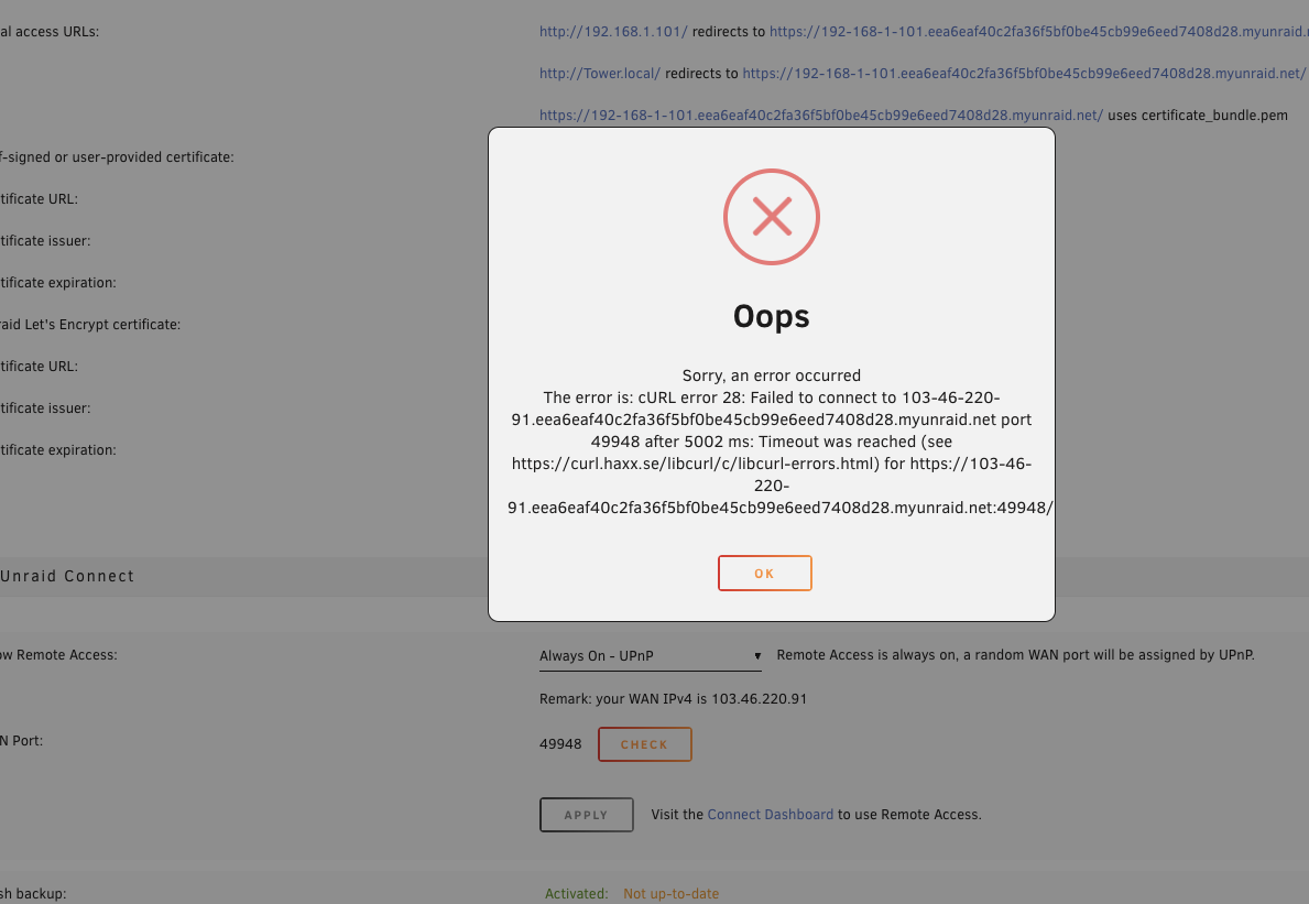

1. My IP Address- I tried to add DuckDNS and it says its monitored by Cloudflare and also used Unraid Connect - earlier at 192.168.1.111 and now has changed to 192.168.1.101.

2. Some error on Unraid Connect
3. Scrbbed the ZFD pool  and deleted the file. Do you recommend I continue using ZFS and what else can I do to make the system stable?
