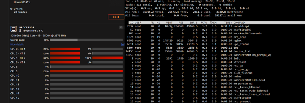

June 20, 20242 yr Community Expert another day, another problem can anyone explain to me why unraid dont stop the array ,dont reboot and show kernel panics? the only thing i did is plug a 3.0 usb external case, but even with he cables disconnected unraid dont work anymore. array dont do parity check no matter how many times i click ,the system dont respond and only can be shut down plugin the power or pressing the power button to the limit xDD tried safe mode and the kernel panics still happens. can anyone guess what is causing the kernel panics???? funny thing is dockers start and unraid boot up "properly" mercedes-diagnostics-20240620-1459.zip Edited June 20, 20242 yr by ARMITAGEIII grammar

June 20, 20242 yr Author Community Expert the only strange thing that i see is unraid api using 10.9 gb of virtual memory and 6 cores at 100% ,but in "top" , core ussage is 0.6% Edited June 20, 20242 yr by ARMITAGEIII grammar
June 21, 20242 yr Community Expert 10 hours ago, ARMITAGEIII said: and 6 cores at 100% ,but in "top" , core ussage is 0.6% That's because the dash includes i/o wait. Any hardware or software changes, including Unraid release, when this issue started?
June 21, 20242 yr Author Community Expert Just after plugin the USB enclosure from orico , the array cannot be stopped so i had to force power off with the button. In fact im pretty sure is not a hardware problem at all , more than 1 year stable and everything Crash when plugin an USB 3.0 enclosure? Pretty strange... Cant this driver be repaired??? Being honest, a lot off users have freezin or crashing unraid problems, It seems like the OS is not stable at all ,i just looked 3-4 forum Pages and they are pretty generic Im just running a full smart test in every Drive , but i Hope i Will be able to copy my tv and movies This machine is in a rack enclosure with only 1 power cable and 1 dac 10gb cable, so that rule out external changes. IF i boot with array stopped the error is gone , It only happens when i start the array ,even in safe mode.
