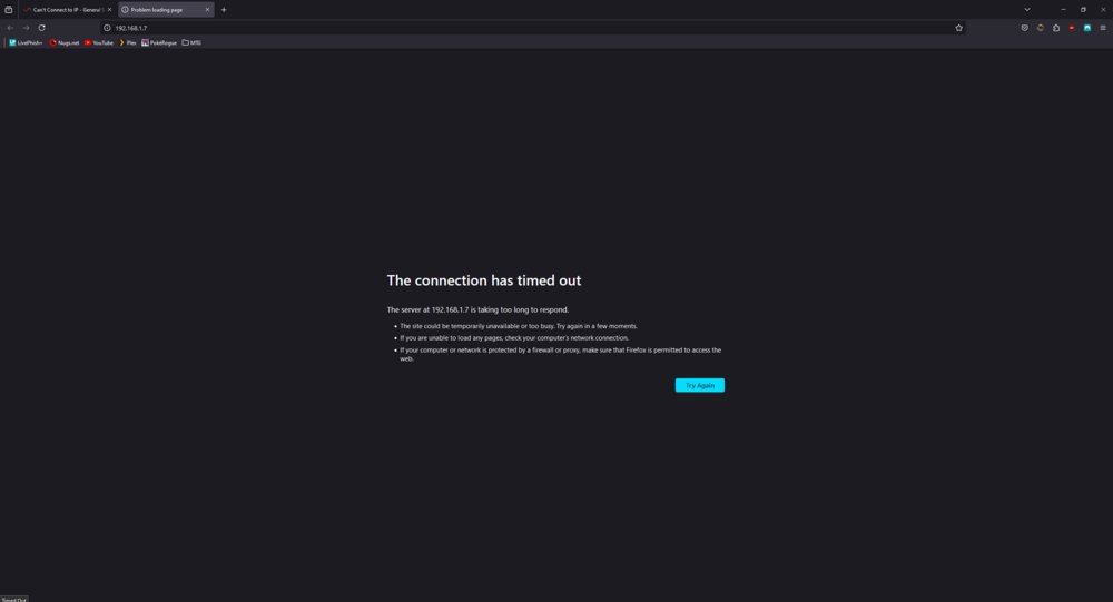

Everything looks normal to me, can you ping the server IP (192.168.1.7) from your desktop?

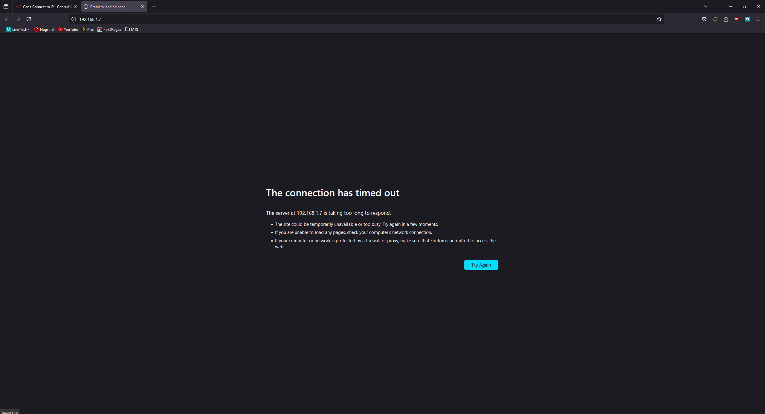

image.thumb.png.13fd382c857883a98bc45c0d7f9ab80c.pngimage.png.ed4622d30f1d1a2728e75d960826917a.png
This is what I see when I try to connect or ping.

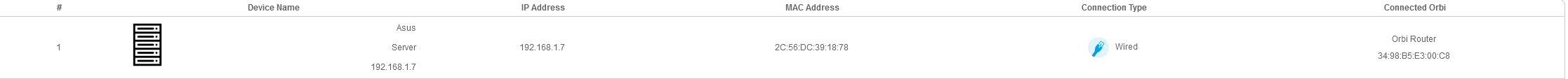

Edit to show my device on my router page. image.thumb.png.0d087c2f38049a624b5d1fa6a68e9d73.png

Any idea what devices 192.168.1.100 and 192.168.1.105 refer to?
Just now, itimpi said:
Any idea what devices 192.168.1.00 and 192.168.1.105 refer to?
Yes, sorry, I pinged the server without turning it back on. I replaced that image with the correct ping.
