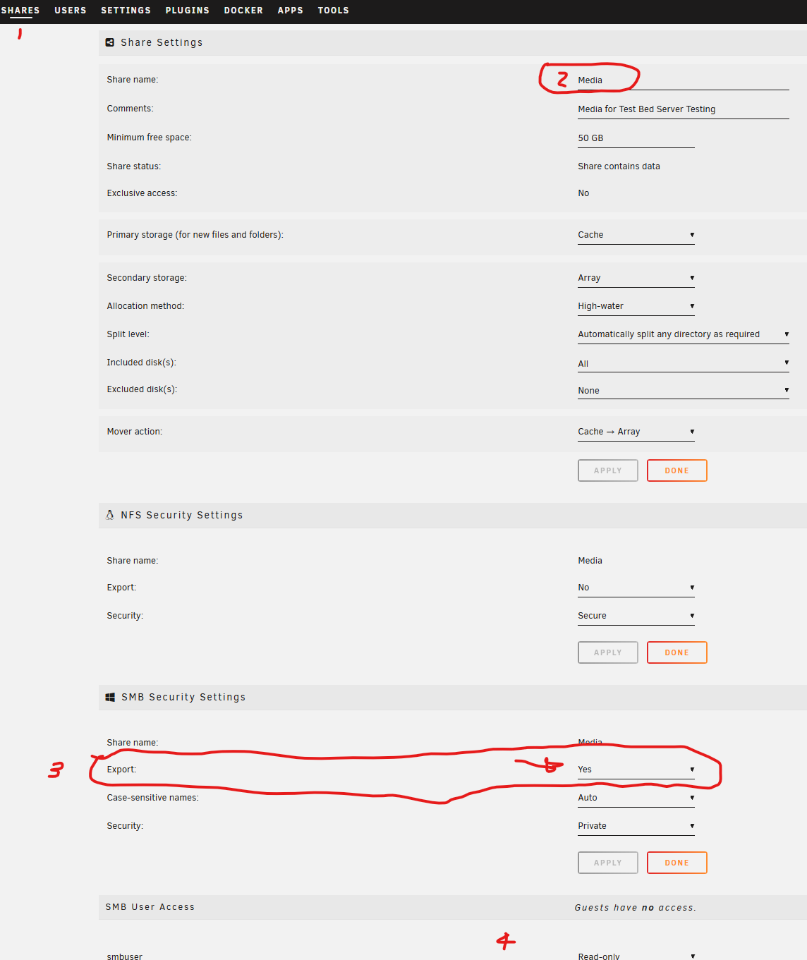

I had a look at the Diagnostics.  You have only one User share (t------r)  which has SMB export turned on!   Turn on SMB export via this setting for each share:
Click on SHARES tab-- step #1.  Then click on the Share 'Name'  (Media in this case) the in the User Share area-- step #2.  Then under SMB Security Settings, set 'Export' to "Yes"-- step #3.  The set the permission for the SMB User(s)-- step 4.

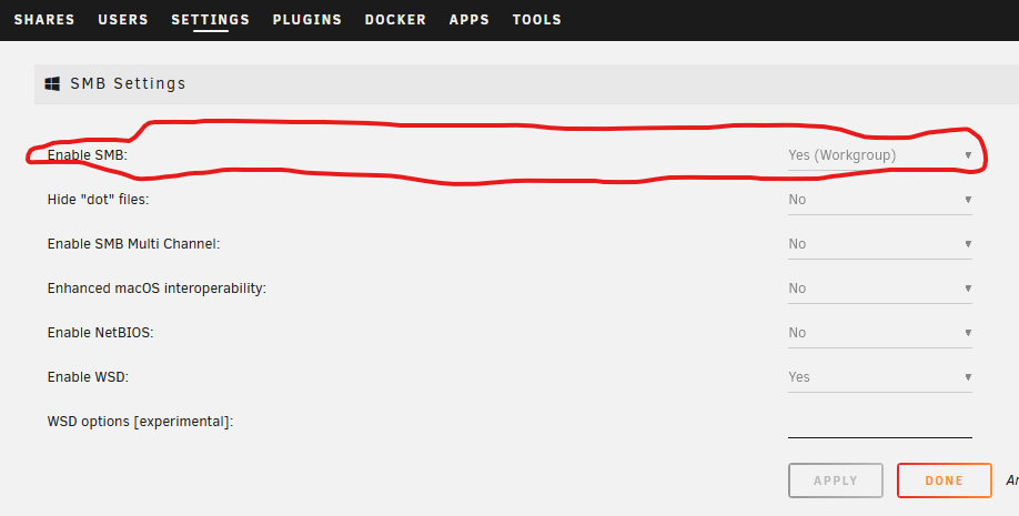

Also go to   Settings    >>>    Network Settings    >>>  SMB.  On this screen, make that this setting is set as shown:
The other settings in the section are set for use by Win 10 and Win11 clients.
