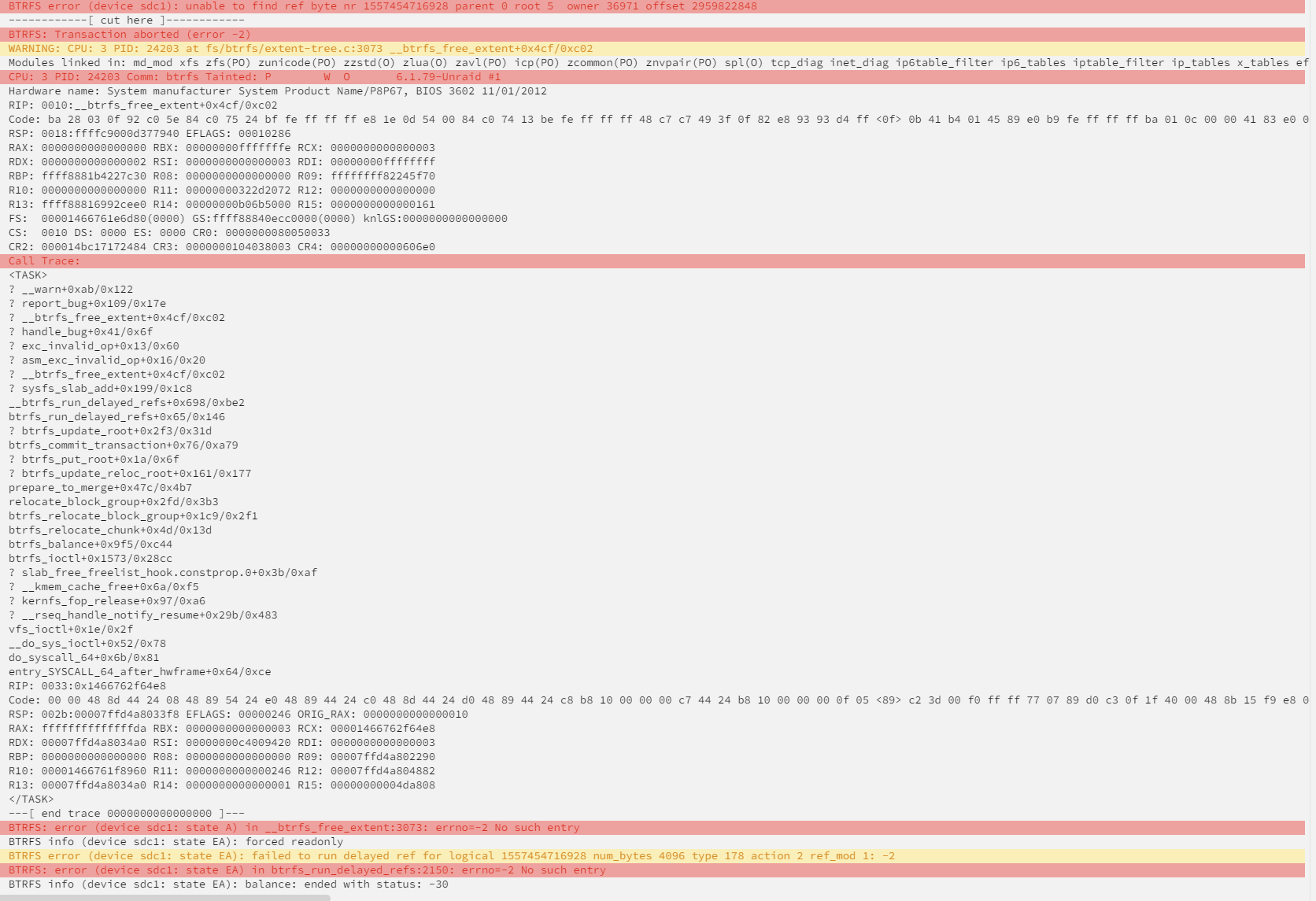

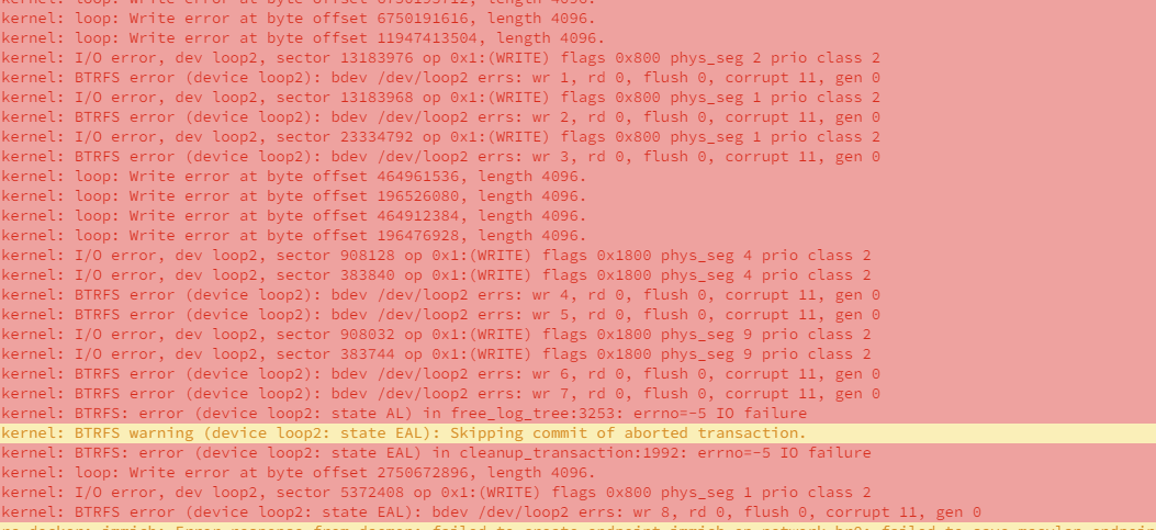

Hi, i still have massive issues, now the docker container wont start anymore and in the system protocoll i see a lot of BTRFS issues...
server-diagnostics-20240624-1703.zip
loop2 is where the docker.img file gets mounted so that suggests its contents are corrupt.  It could also be by-product of the pool containing it being corrupt.
You should consider deleting it; recreating a new empty file and then reloading its contents via Apps->Previous Apps.
Whatever I do it shows allways readonly filesystem... What can I do now?
That suggests the pool filesystem has other issues, suggest that you backup and then re-format.
