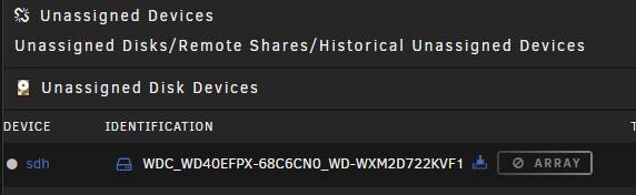

It is days like this that I think about going to TrueNas. I added a new SSD for a second cache the other day and then lost my parity drive and one of the Array drives. I got them back online this morning after a parity build and I rebooted then the other Parity drive and Disk 2 were showing as shown in the attached image.
I unplugged the new SSD rebooted and the second parity showed up but needs to be rebuilt. The Disk 2 still shows up like below. There are no NVME drives installed.

Getting lots of what look like connection or power issues on that drive.

Not sure where you got the 18TB drive from?    I am talking about the drive shown as sdh in your screenshot.

Sorry. My bad. I guess that is your setup at the bottom.... I thought you were listing my setup. I am thinking I may need to start with a new power supply and go from there. Any idea how to get the drive back from this weird place. I have not started the array yet. Should I just start it and add it back to the array?

I still need help getting the drive back online. Normally I just add it back to the array and let it rebuild but it doesn't give the option to add it back or even get to it for repair.

It is definitely still acting up as it still shows similar to the screenshot above but the drive designation has changed to SDF.
There seems to be no options here other than to preclear the drive.
