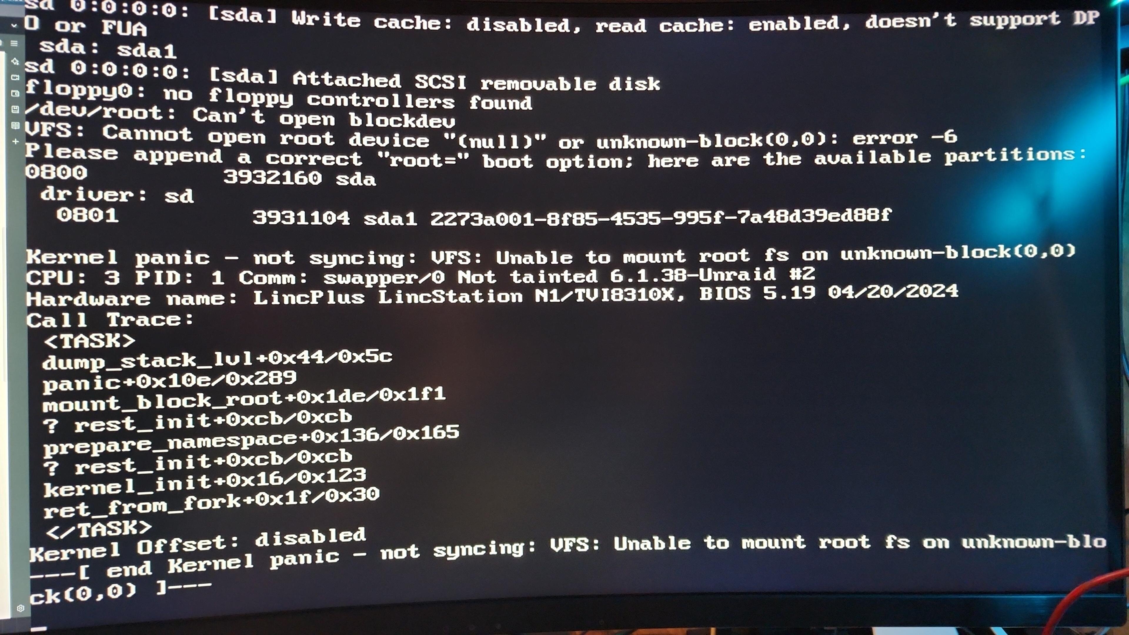

After several blackouts, I encountered this Kernel Panic problem and I wanted to share it to know if there is any process to correct this in LincStation N1.
Solved by itimpi
That is usually a flash drive problem, try recreating it.

Thank you for your response, but I would like more details on how to do it because I understand that it has an internal USB but how do I access it and how to reinstall the system.
The flash drive should still be a normal flash drive, and removable.
I seem to remember a  comment about the USB drive being inside one of the NVME bays.
The Linkstation home site has detailed instructions on how to reinstall Unraid once you have the USB boot drive.  They boil down to the same instructions that can be used when installing Unraid onto a flash drive for any other system.
Thanks, I found the micro USB in the NVME bay compartment and following this tutorial https://drive.google.com/drive/folders/1lbhNsvBLdCvVSMourHWkHf0HB7MiQjJ3 I was able to fix it.
