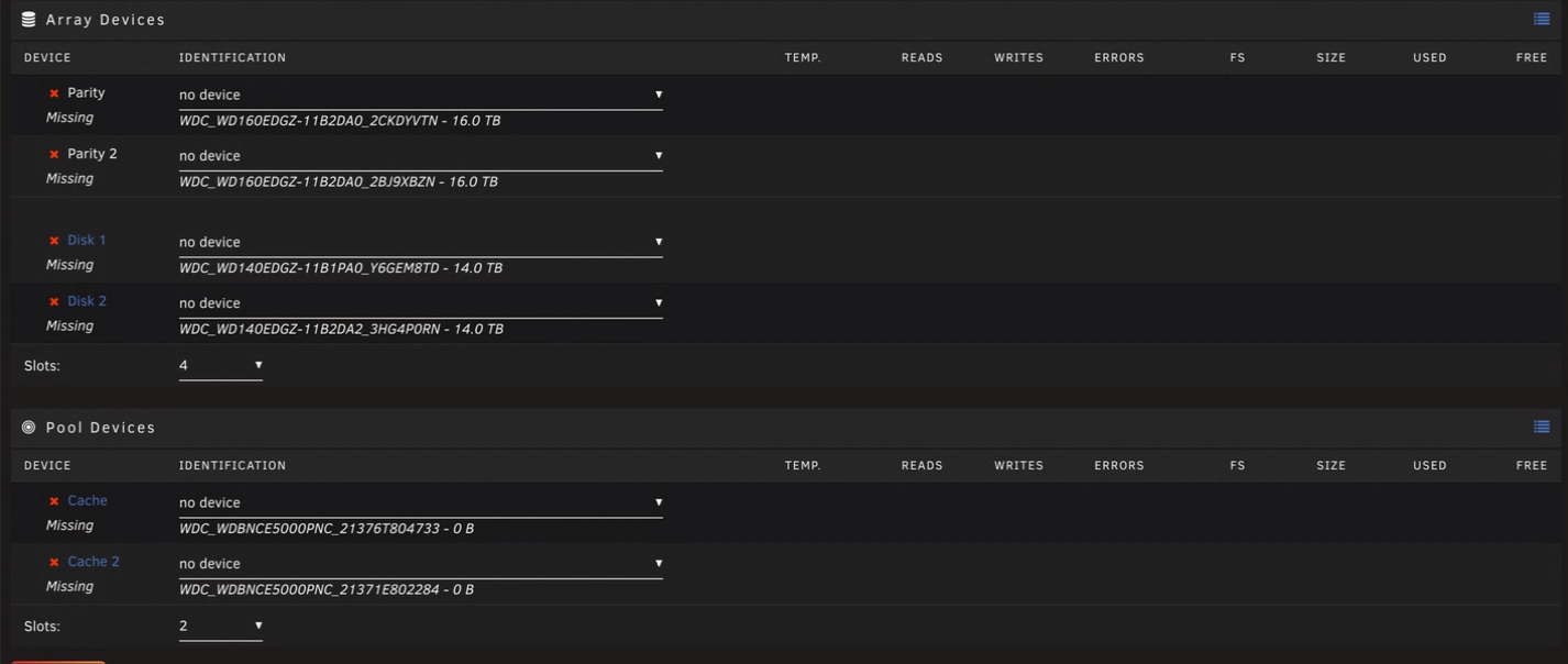

Unraid latest version array stopped working no disks present
Hello folks this is my first post in here and hopefully some one can help me on this one i am loving UNRAID till today :D failed i though was the drives but something else happened in here .. the server hasn't been touched like moving the hdd caddies or something like that .. one hdd migth fail but not all at the same time right ?? im attaching this pic so you can see ... the only one present is the USB :D but no HDD :(

Are the disks detected in the board BIOS?
Is there something that all the drives share that could have problems such as the HBA or the PSU.
Thank you all for responding after reviewing the server it was the raid card who was messed up just removing it from the board and reconnecting it again worked it all thank you all
