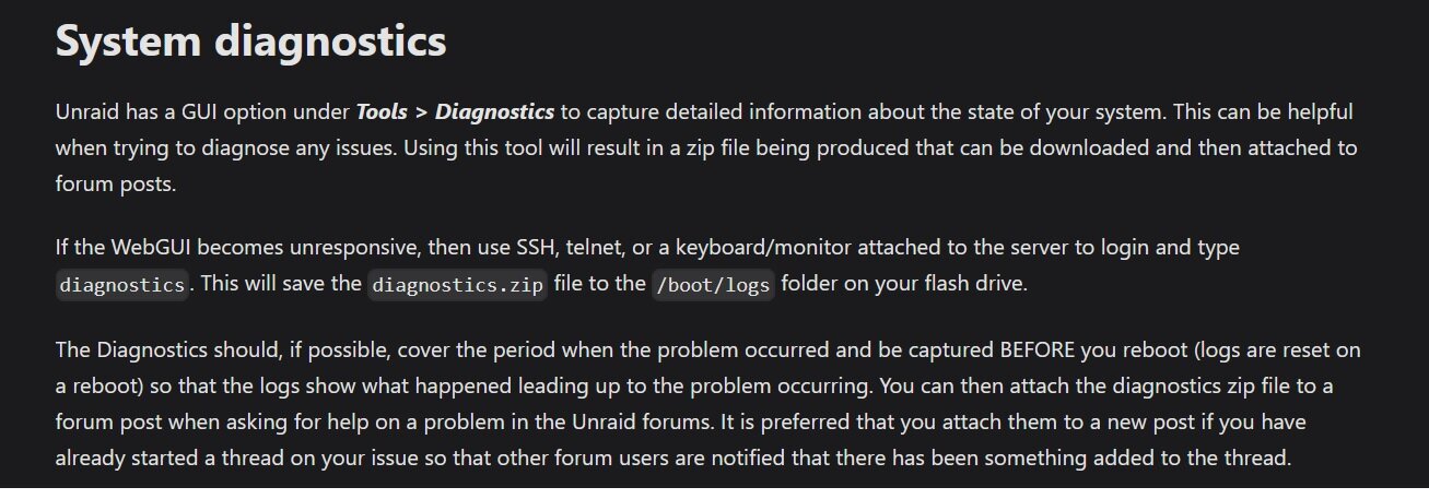

Reading the last paragraph in this screenshot leads me to believe that any helpful diagnostic data is lost after I reboot, which I have to do to get local or remote access to Unraid after it locks up.
That is the whole point of the syslog server - it allows for the syslog entries leading up to a crash to be captured.   The paragraph refers to cases where you have a problem that has NOT caused a lockup/crash
