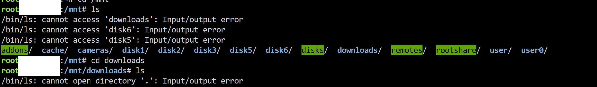

I'm waiting for rebuilt but already, samed disk 5 made same number of error again during rebuild. Waiting to see if it get worst, might also be a failing controller. I'll try putting one of the drive outside on aother power cable (hopping it doesn't split to the same upward) after the rebult
I think I have a controller problem...
disk 6 is being rebuild. disk 5 made the read error. downloads is another disk that never did any error... All on the same external HHBA card, 2 different set of cable

Ok so here's the "new" situation. 2 days ago, I took out disk 5 and disk 6 of the startech 4-bay unit and plug them directly into a power and sas->sata cable and rebuild. This morning, it's Disk 5 that is now disconnected and download disk has invalid path (like last time). download disk is still into the startech bay but I'm more concern about the disconnected disk.
It usually happen during night at the backup time (well, I think, all I know is that all backup fail during that time). I think this time it was during a parity check because I'm att 33% of parity check and it stopped.

edit: there's also the invalid path that I don't get. Now it's the download drive, last time it was download and another drive. The download drive is still in the startech with another drive though. Very weird.
