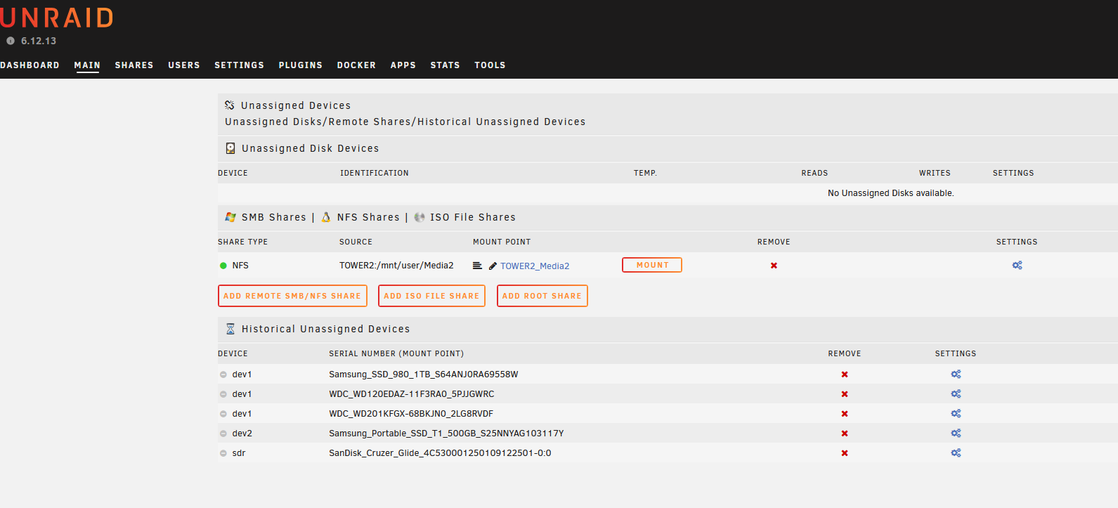

1. Went into the unassigned devices menu and found the server
2. Tried to load shares but they couldn't be found, so I backed up, came back in and manually loaded.
3. Everything said success and looked exactly like how Tower is mounted on Tower2 (see picture 1)

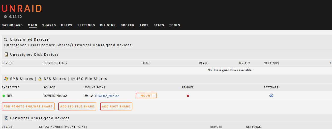

4. I click mount and get failure (picture 2)
