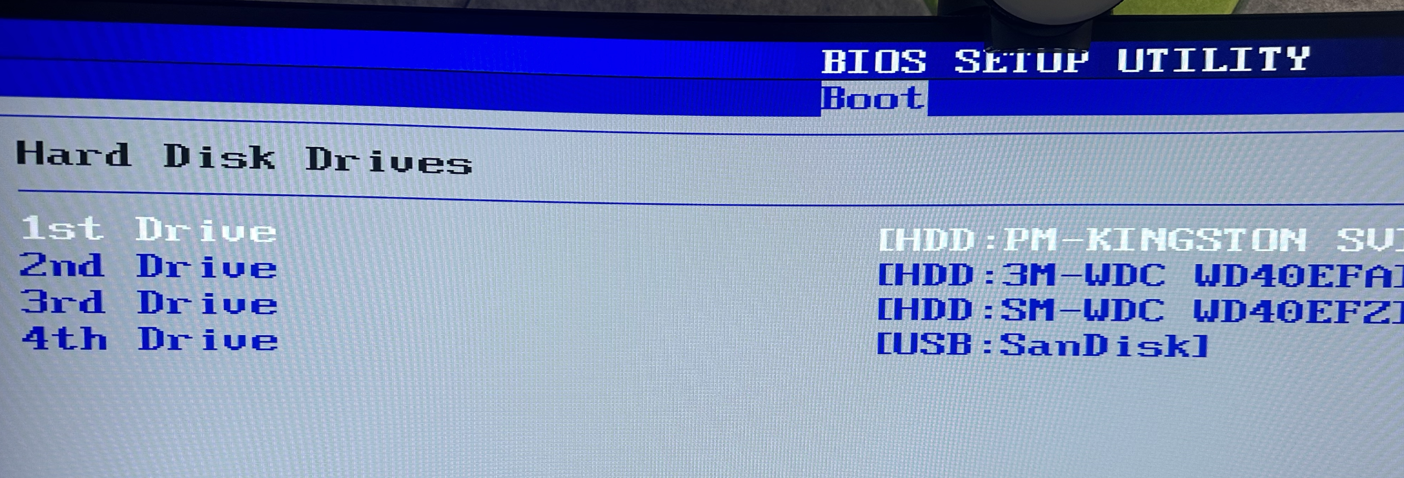

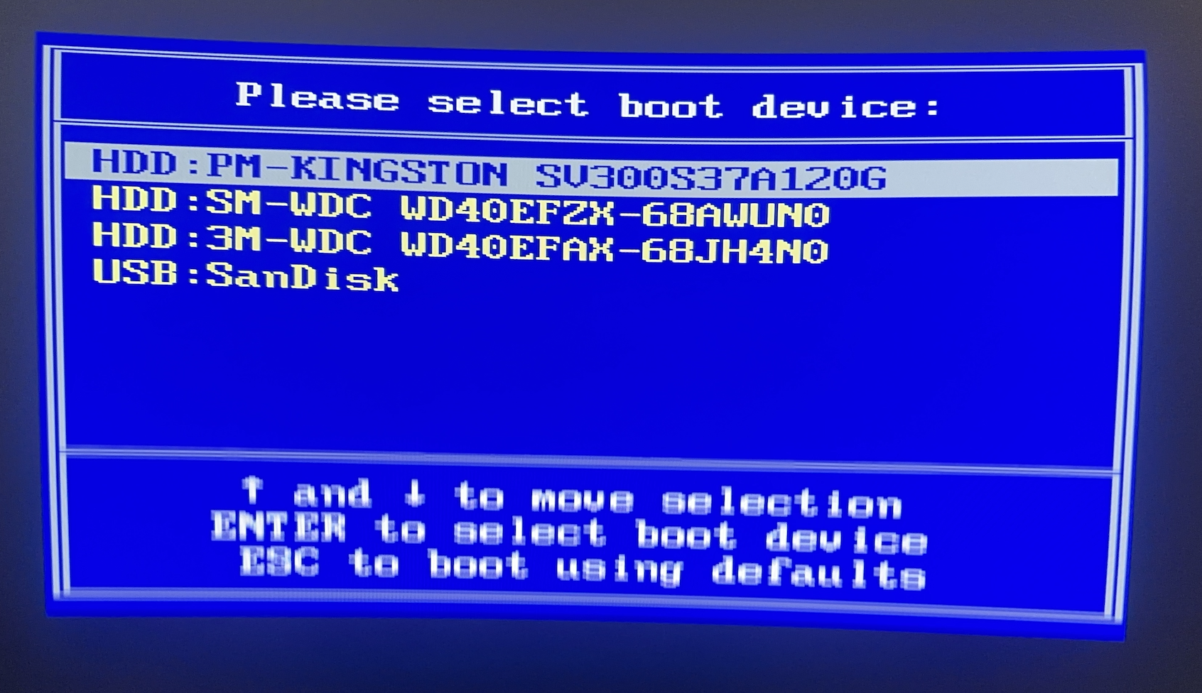

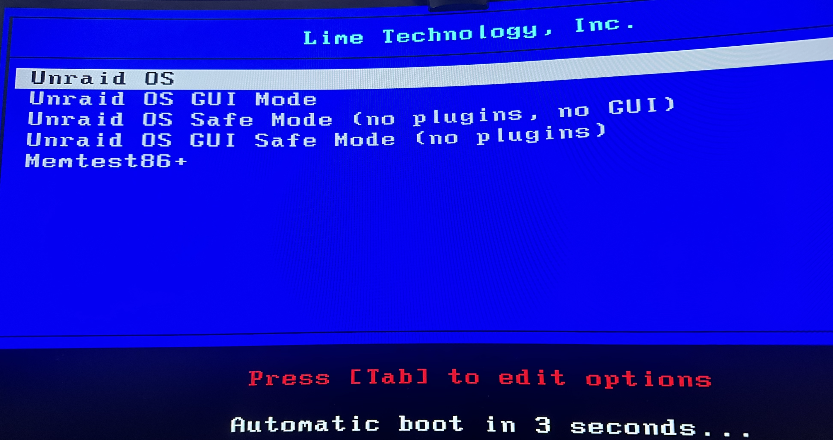

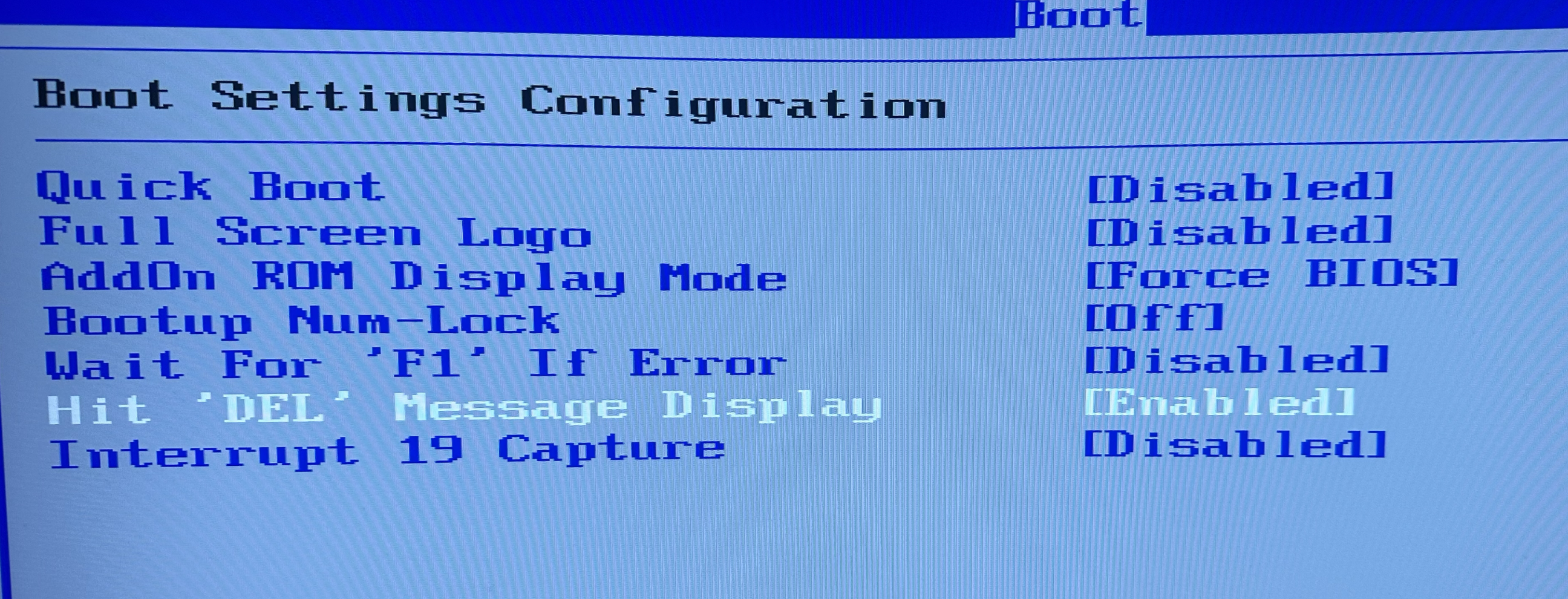

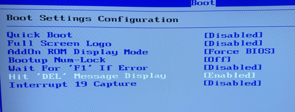

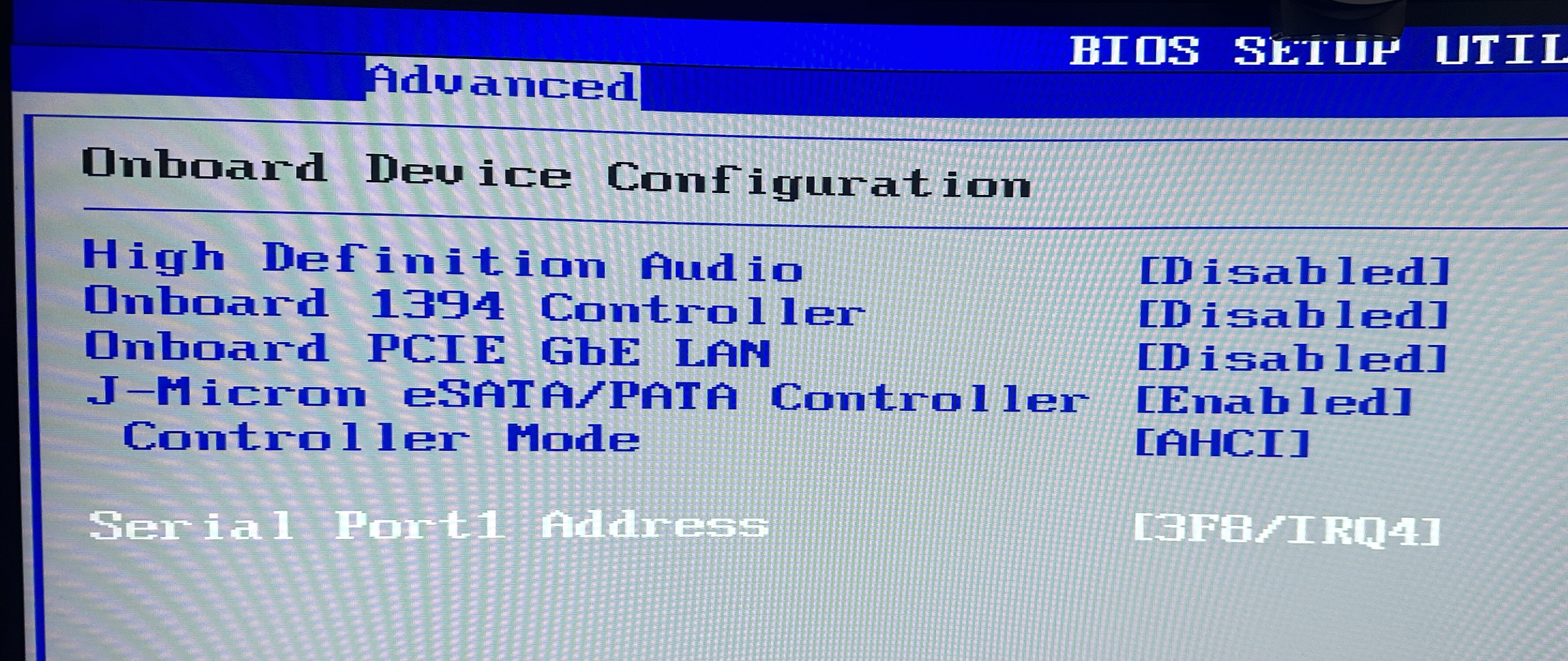

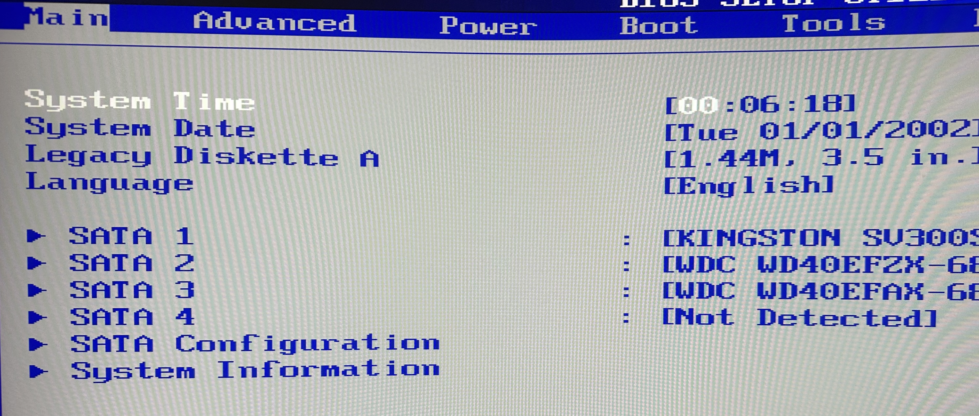

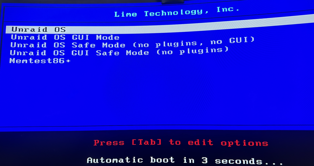

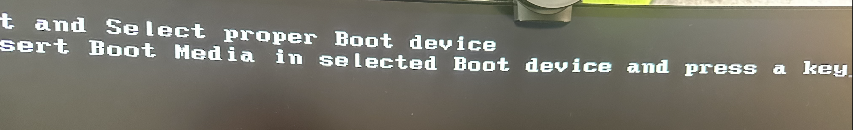

Here are some photos from the BIOS
when pressing f8, i get the menu, but it doesnt start automatically

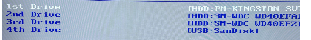

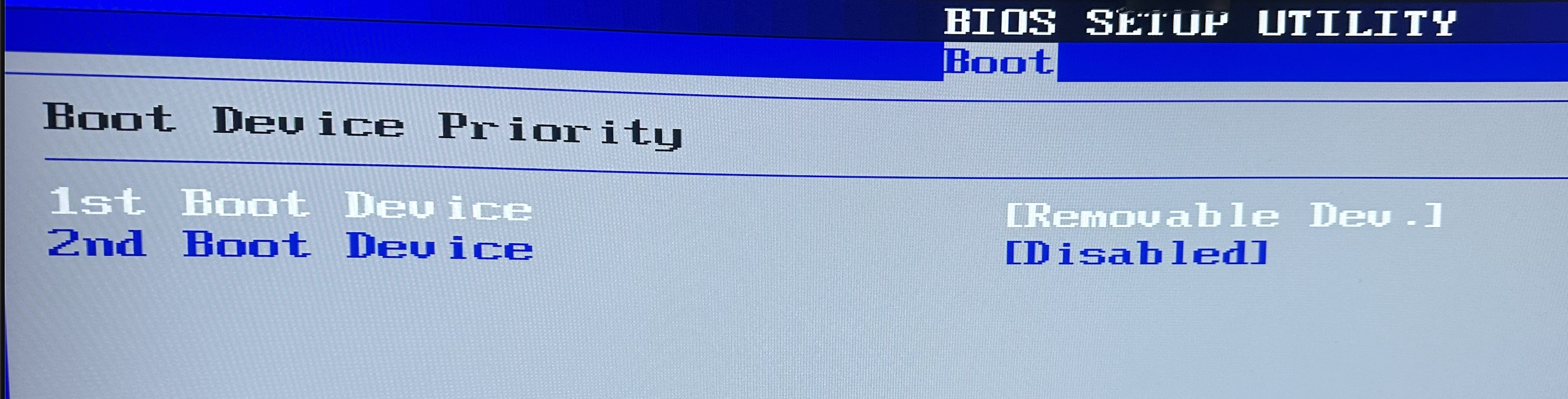

The Sandisk should be the first option here:
Then save setting and reboot
Grande Jorge!
Now I can select USB as boot device.
