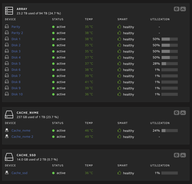

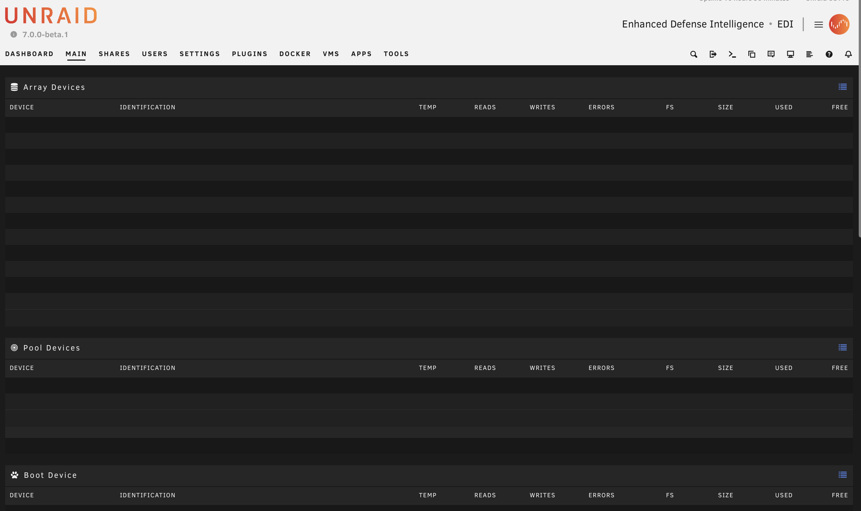

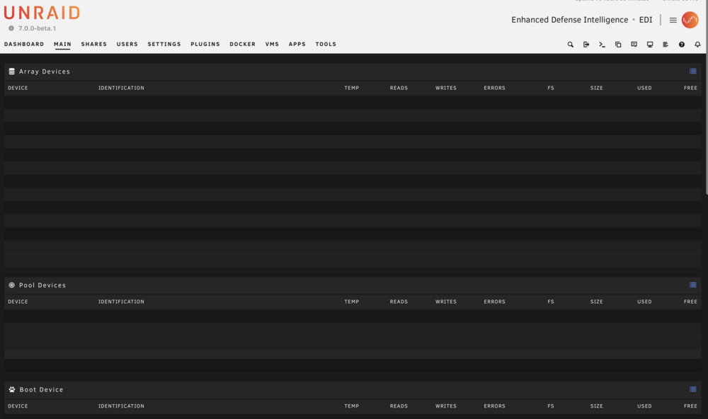

There is a weird issue though, the "MAIN" screen no longer shows any of my disc information? It was all there prior to starting the parity check and they all still show up in the DASHBOARD tab so I'm guessing its a UI glitch with 7.0?
image.thumb.png.a9026f3c1ae9caf869a52f372288a852.pngimage.thumb.png.7a1bda3e2c60d2cb1bf3859649fdf056.png
Just got this block of a kernal issue, and the parity check has stalled. I'll reboot and try doing one stick at a time. Though since this is talking about a kernel/driver bug is it a kernel issue? I'm more than willing to test anything out. For now I'll reboot and start removing mem sticks. I've also attached another diag, as far as I can tell there were no warnings or errors before this kernel issue.

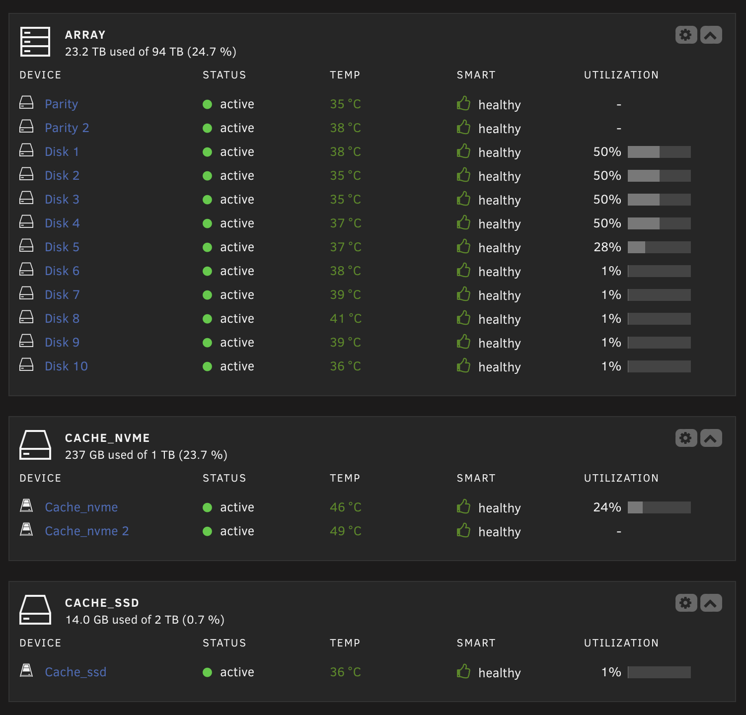

I was able to source another 14900k and swap out the CPU it's running a parity now hopefully this time it finishes. Though there was one weird issue after it booted back up the server name had reverted back to "Tower" I'm not sure why or what caused this? All of my other settings and things are still present just a pretty weird issue. I've attached the diagram just in case it helps.
Hopefully you were right and it was the CPU, fingers crossed that the parity check finishes this time.
tower-diagnostics-20240704-1847.zip
That could be a flash drive issue, possibly with all the crashing one of the config files got corrupted.
That makes sense, it looks like the cpu was the culprit after all. This parity check has been going for the last 21 hours and says it'll finish in 3 hours. If/when it does finish, besides renaming my server back to its original name is there anything else I should be on the look out for in terms of possibly messed up config files?
I also plan on having the server run at least 2 more parity checks and a couple reboots just to be on the safe side. Is there anything else you would suggest I should do before thinking the issue is fixed? Since with the last cpu it did successfully pass 2 parity checks last month before suddenly not working this month.
Should just need to rename.
Not really.
