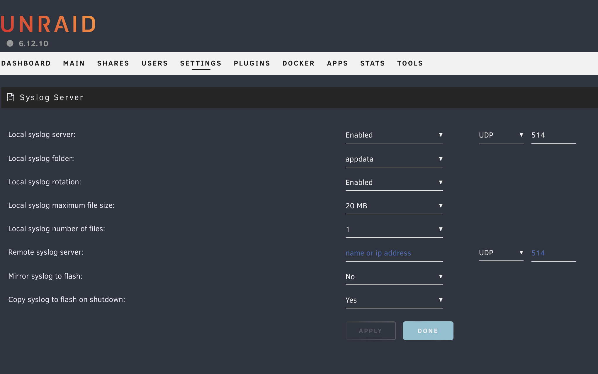

it should be already active
It's not, either set the remote IP (same as the local) or enable mirror to flash drive option.
ok thanks, now I can see the file in appdata.

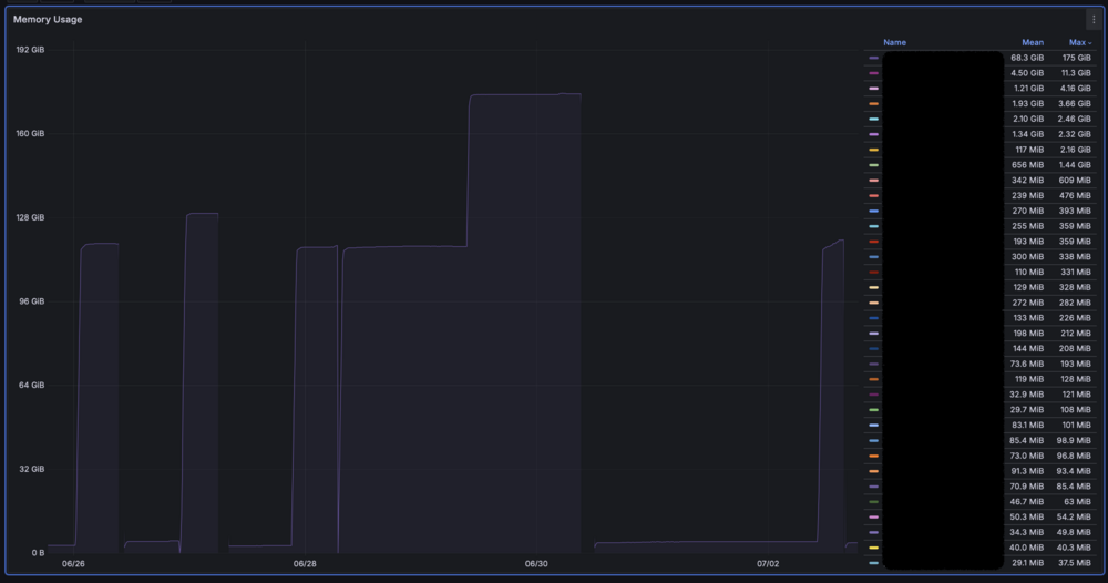

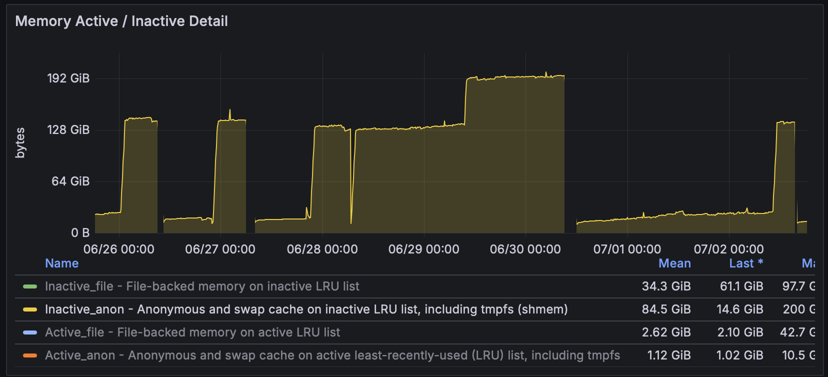

I know that is not a good analysis, but every time I had a crash there was an increase of use on TMPFS
how can I check what is using this space?

well.. I have a docker container with the same footprint.
is it possible to limit the ram usage of a container?
Yes. add to "Extra Parameters" for example --memory=4G
