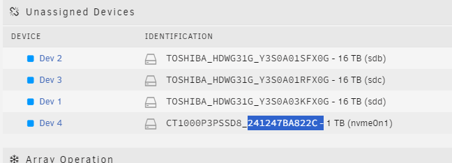

July 2, 20242 yr Author This gets stranger by the minute! So just after I sent you those new logs, I took the drives out - stuck them in a caddy and tested them on my Win 11 Desktop. Both came up fine, so formatted them as MBR and dropped test files on them both - work fine. Stuck them back in the new build, one is NOW showing in unassigned devices, but the other is still missing
July 2, 20242 yr Community Expert In the previous diags there were still no NVMe devices detected on a hardware level.
July 2, 20242 yr Author Here's the new Diag with the one showing (which is the bottom M.2 slot and not the one powered by the CPU, I think) thecube-diagnostics-20240702-1615.zip

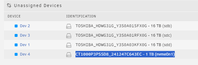

July 2, 20242 yr Author Swapped them around - and it does look like the top M.2 slot is fubar, as the bottom one is working fine again with the other NVME:
July 2, 20242 yr Community Expert 7 minutes ago, siron1992 said: Swapped them around - and it does look like the top M.2 slot is fubar That's a possibility
