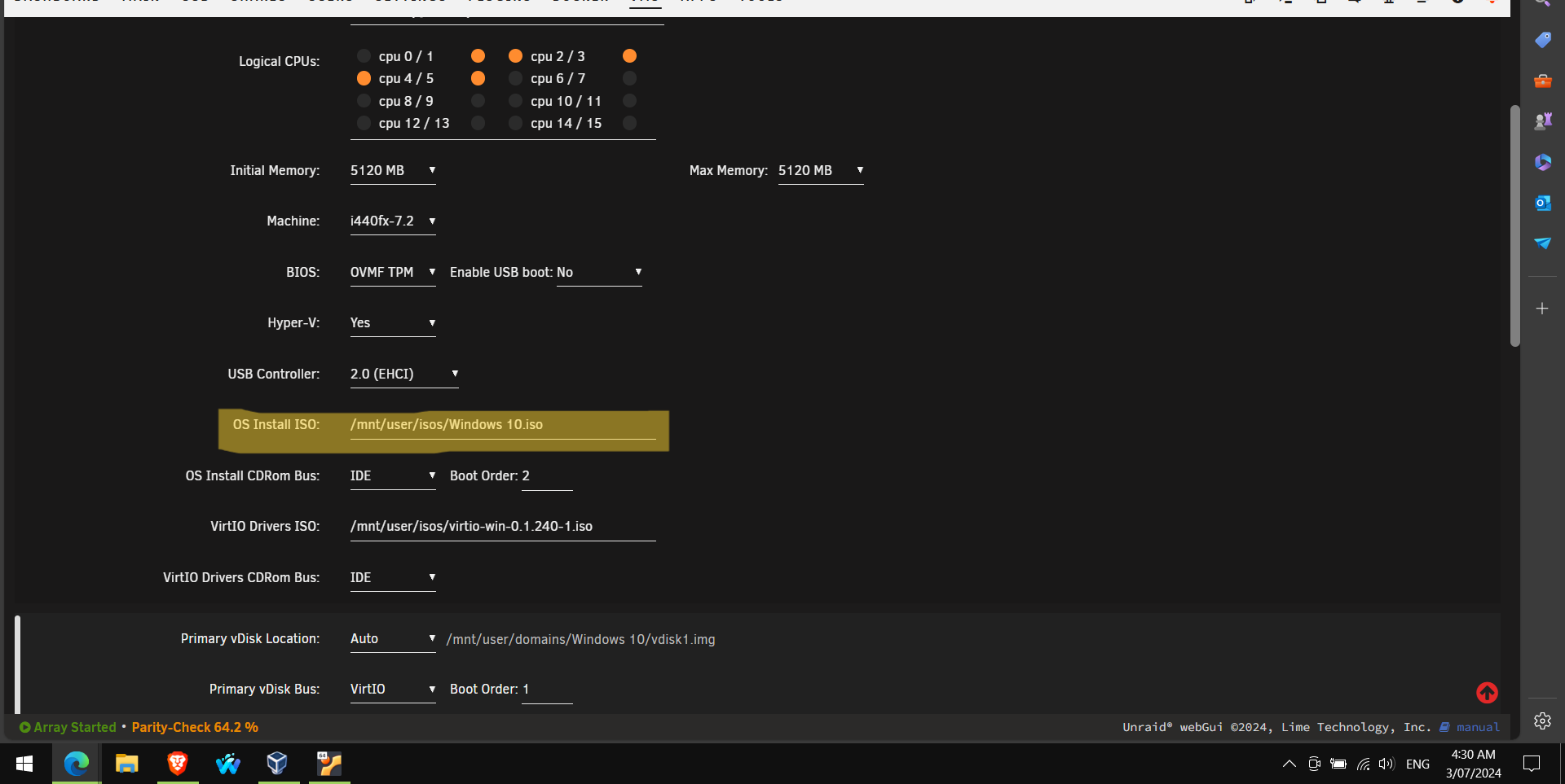

my windows vm wont boot into install menu
i dont know what the zuck did i just do to make that happen, i mean heck i have seen that thing on linux 'the Grub Rescue 'in case if iso don't boot up well here's thing right when i try to start up a vm with windows iso it come up with this bash thing sort of like seeing the grub rescue, i try to trouble shoot if i can get to work, i think it could be some bug on my unraid version 6.12.8 or something to do with virtWIN could have caused it or i could be just wrong, let me know if you had this problem ever accorded, 'and one thing i had already have put a cd iso file on vm before i even start it up so."Screenshot(29).thumb.png.ec841ad04c3762c941c295e771ecac33.png

Did you set boot order for CD? type reset + enter you may then see press any key .....
2 minutes ago, mr_syd20 said:
yes i did i can proof with this, it had already have iso file and it did just what i discribe on my first postScreenshot(30).thumb.png.369ebff0db8fc53dc783a5ee7f3620a4.png

type reset and press enter you should see press any key. or exit will take to bios screen when you should be able to select boot device
ok i just did that thanks man it worked out well thank you for fix this problem:DScreenshot(35).thumb.png.fb53531c7a183728b7f8b687ece6aea1.png
