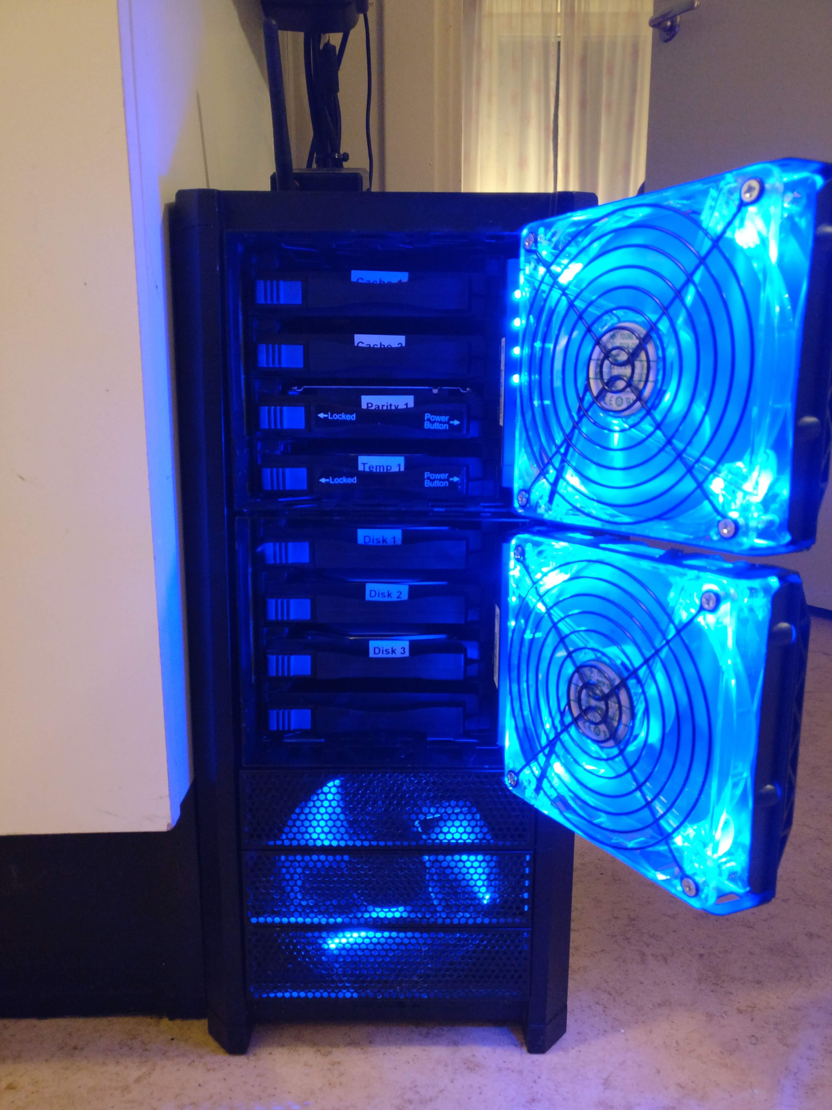

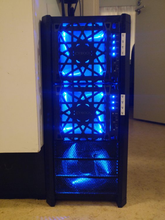

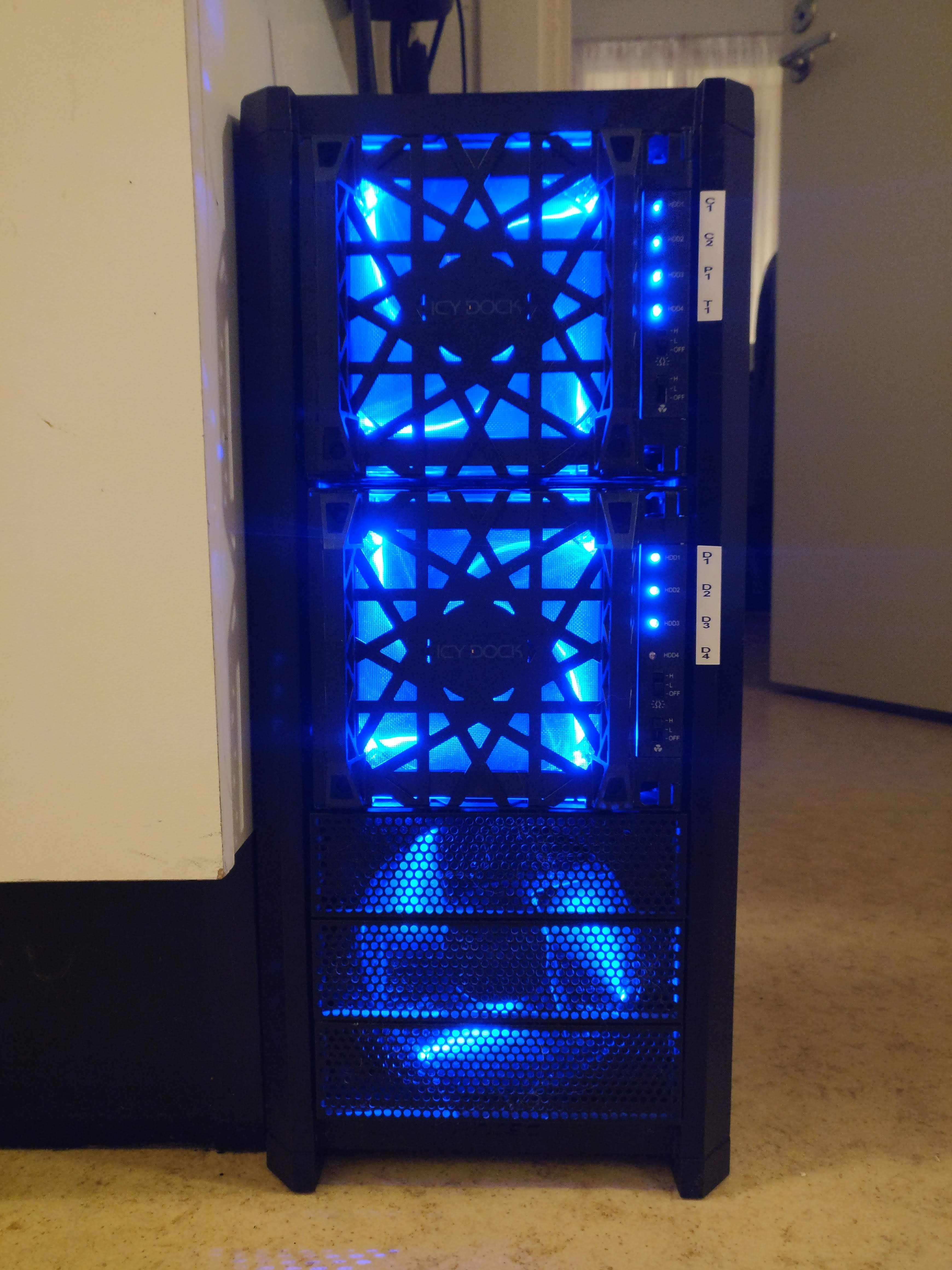

  • Recently bought a Sharkoon REX8 Value Edition case for  3 x RaidSonic ICY BOX IB-565SSK   Used a dremel to remove the usb hub thing from the frame, and put a power switch on the back of the

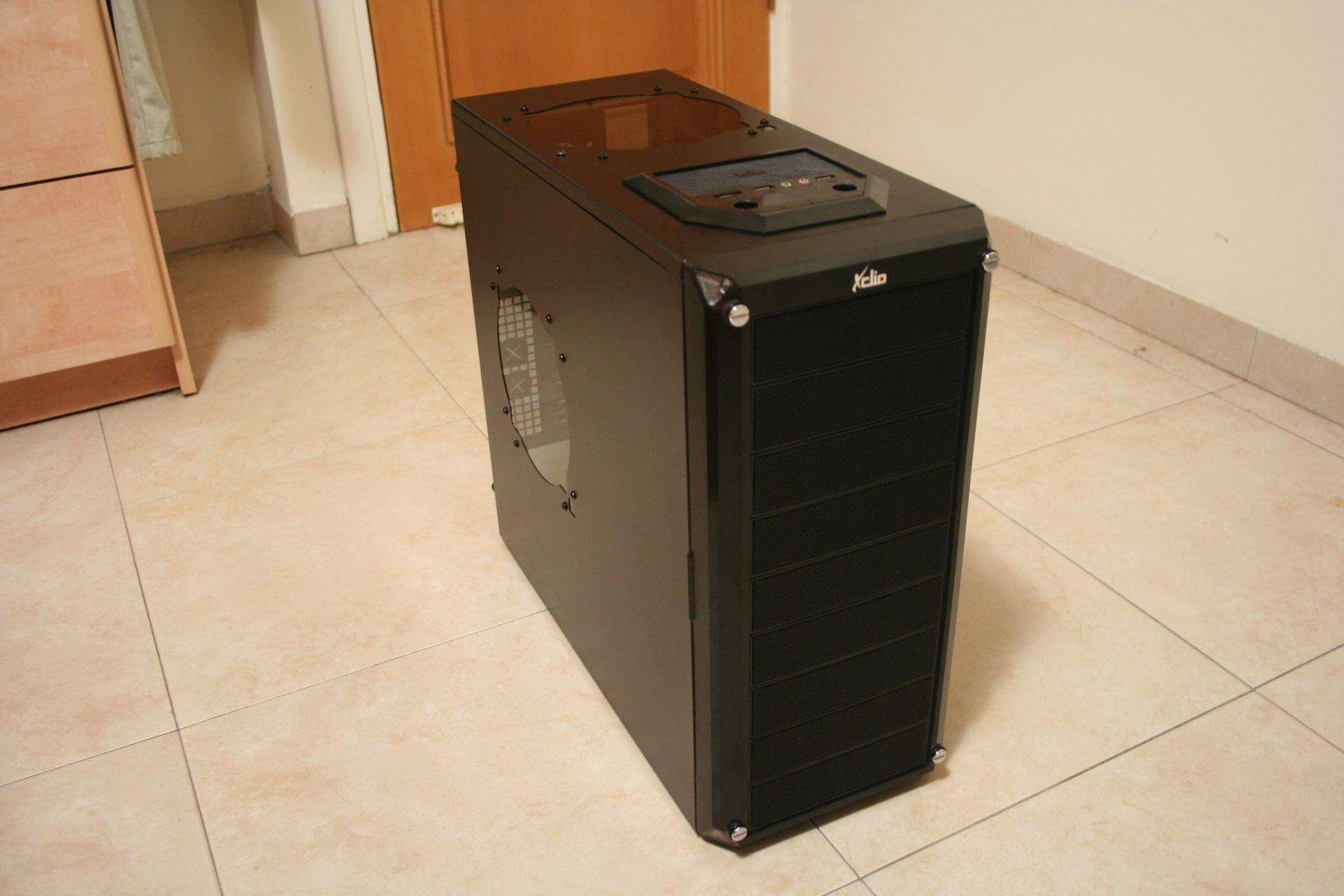

Thanks for the list! it has been very helpful! I was able to find a Xclio Nighthawk for a really good price,
I have replaced the hideous side and top fans with a transparent gray acrylic sheet (3 mm), so now the case is slightly thinner and more elegant.
The shop that provided the acrylic material and did the laser cutting only charged me 20$ for the two transparent panels (I'll be happy to share the file that was fed to the laser cutting machine).
The built-in 4-in-3 cages are surprisingly good because when you open the front cover you can see the serial numbers of the drives and pull each of the drives separately
(my Lian Li EX-23NB has a fan in front so you can't see the serial number of the drives, and you likely have to pull the entire thing out to get one drive out)
(p.s. It took me a while to realize, but the metal pins in the drive trays pop out, and you can use screws instead of the tool-less configuration which requires too much force to use)
The case is not very deep (473 mm including the front panel, 440 mm without the front panel),
I'm now waiting for a right angle molex power connector because without it I can't fit one of my Kingwin KF-3001-BK racks, I have 20 mm clearance from the motherboard power connector so a right angle connector is a MUST for me.
Xclio Nighthawk with side and top acrylic panels
Edited by tal.aloni
This case is discontinued?
Aplus, as a manufacturer, is also not present on the net anymore?
You could fit a third of those "build-in-cages" as far as I can see from pics?
AFAIK the Xclio Nighthawk case was never marketed under the A+ brand (other Xclio cases were), in any case, the manufacturer is no longer in business.
Yes, the case has 9 x 5.25" bays so you can fit an additional 3 x 5.25" cage for 3.5" hard drives.
Edited by tal.aloni

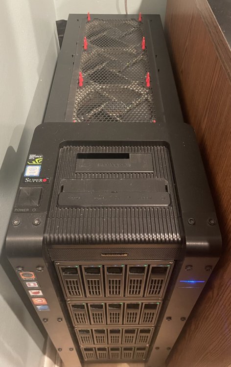

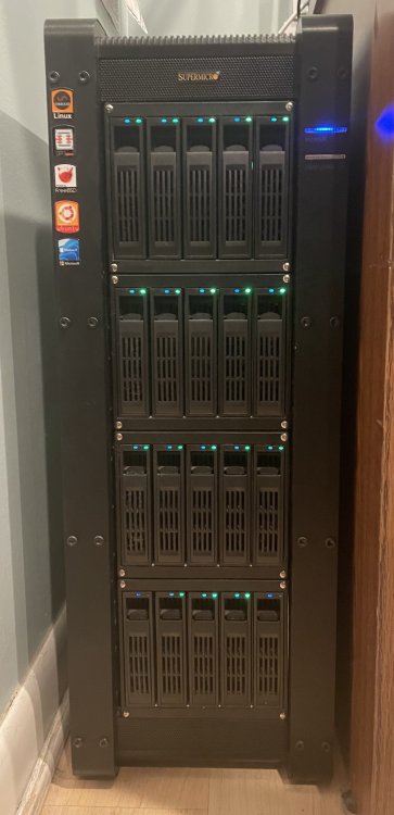

Are there any Antec Nine Hundred (900) with Supermicro 5 in 3 cages owners still out there? I'm looking to do a build later this year with that setup (3 cages). I just wanted to see if the overall length of the cages interferes with an ATX motherboard. I know the fans on the back of the Supermicro cages poke out quite a bit and probably overlap the board. Anyone have any pictures of the cages inside their Antec 900? I don't want to purchase everything and then have problems getting everything plugged in.
