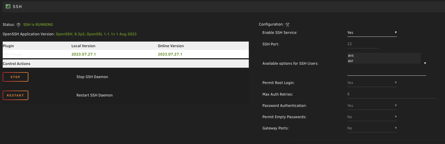

My ssh is configured to allow user avs to ssh...Tried rsync with similar results…
