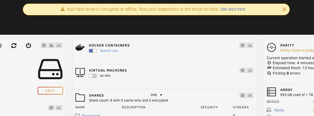

Whoops, I felt lucky too early. Right after docker activation the messages are back
Post new diags.

@JorgeBThe error just accured again
copied log.txt
Edited by Cypher01
It doesn't show the start of the problem but it does confirm that it is flash related, probably dropped offline, try using a different USB port, ideally USB 2.0, if it still happens replace the flash drive.
