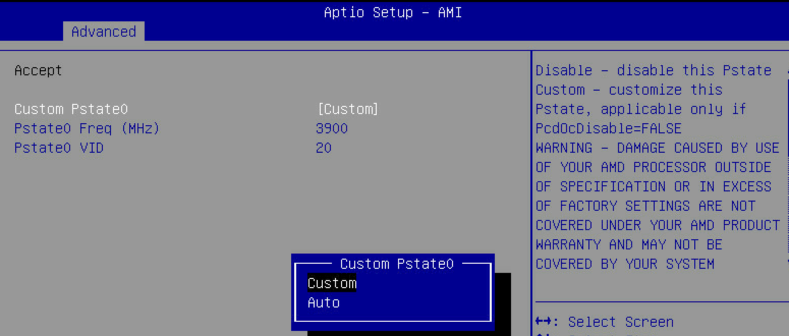

July 20, 20242 yr Author While waiting for the ram sticks I have been running memtest 24/7 and the rig has passed dozens of cycles without issue, so I continue to suspect idle power management and not memory timing, though I know this is not definitive. However, while continuing to hunt through the bios for typical idle current, which still doesn't seem to be a supported option even in the new beta bios, I did come across something called pstate0, which after some research appears to be about idle power and cpu/gpu settings, including voltage. Am I crazy to think this could be similar? My options are custom, and auto, and these are the default settings for custom. I suspect the 20 might be too low, but am hesitant to just try random higher values.
July 22, 20242 yr Author Can anyone confirm if I have got this right? The server has survived all weekend, but it did have to do a parity build so I am still not confident I have solved this.
August 8, 20242 yr Author Confirming that changing the pstates from AUTO to Custom and leaving this as the default settings fixed the problem.
