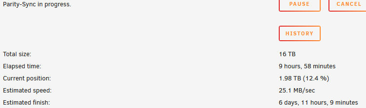

But! It was syncing really slowly. It's been running at only 25mb/sec overnight. See pic 1.

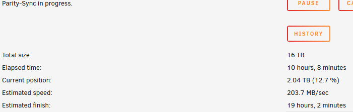

Then i re-checked the sync status and it's now running at ~200mb/sec. See pic 2. Ok.. good. but why was it slow before?
Any ideas what's going on?

The only obvious thing I can think of was when it was running slow there was reading/writing going to some other disk in the array.   This would dramatically slow down the parity sync speed until it completed.
Ok thank you. But I am not sure that'd be the issue. If anything, overnight it would get less use I would have thought.
I'll keep an eye on it I guess
