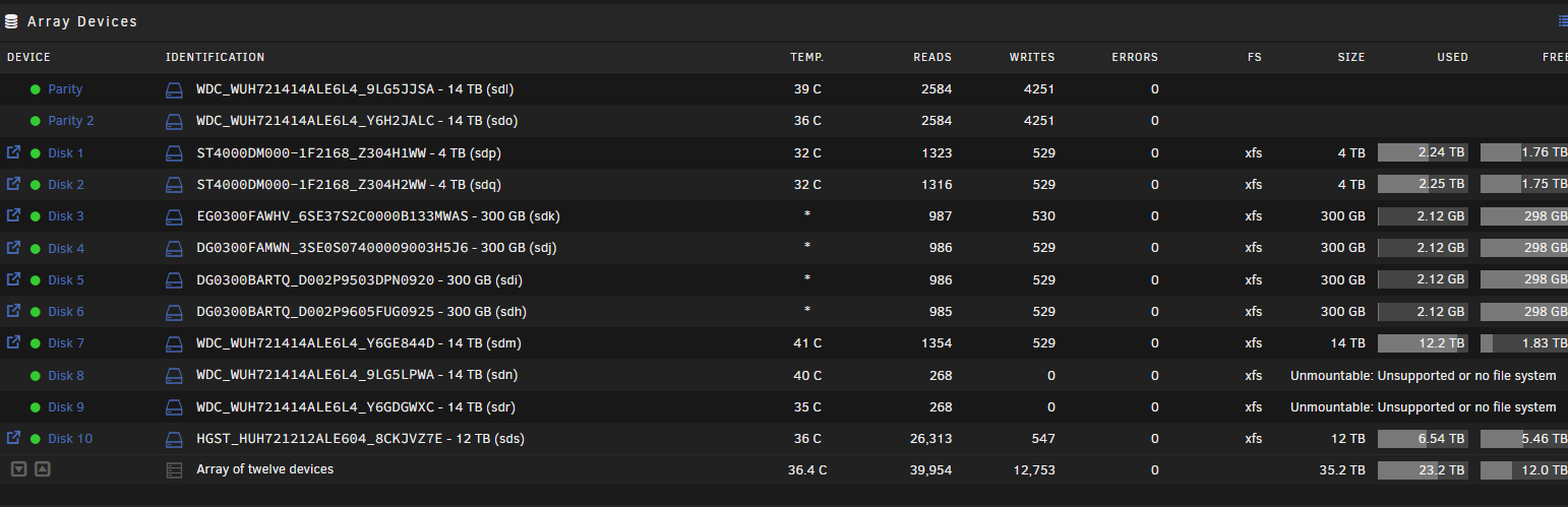

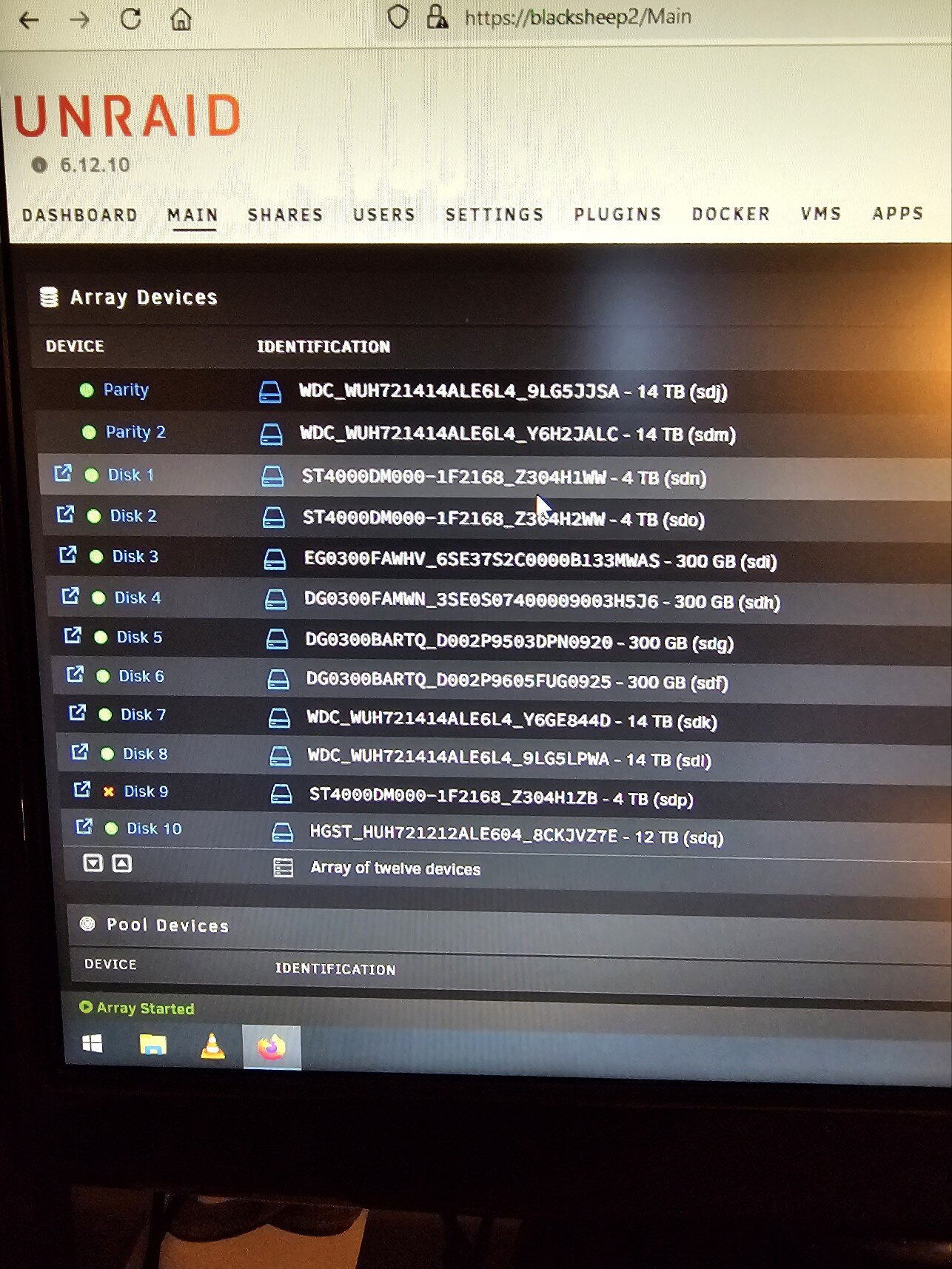

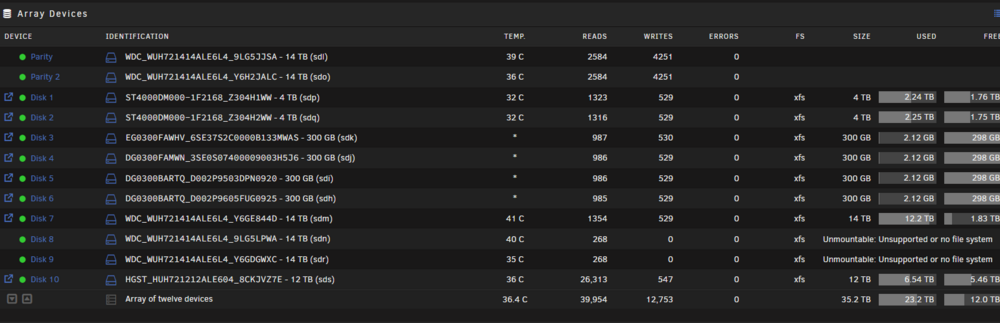

i recently had an emulated failing drive error.  swapped out the drive (disk 9) with a larger new hdd.  when adding disk9 back in the ID had changed on disk8.  the system wanted me to do a rebuild on both drives, which i did.  now all my drive IDs have changed including both my parity drives.  in addition, both disk8 and disk9 keep saying unmountable or unsupported file system.  i havent formatted anything, etc. so i'm hoping all my data is still intact and just need to re-arrange things back.
before swapping the the bad drive out i had added two new controllers to an empty riser card i had in my pci express slot for my array, but the IDs were fine at this point so i proceeded to swap the bad drive out.
in addition, i noticed one of my 400w psu had failed on the disc array, i'm currently waiting for a replacement as i'm not sure if this is the real issue or caused the issue or both.
i have attached a before ID screenshot along with an after ID screenshot of the hdds in the array.  is there a way to put the array back to the old ID system.  i'm afraid to do anything because i dont want to lose data.

in case anyone else has similar situations.  i used the wiki.
https://docs.unraid.net/unraid-os/manual/storage-management/#drive-shows-as-unmountable
i decided to use the command line to check the drives.  it spit the above post error out.  i stopped the array in the maintenance mode and then started the array up normally and noth disk8 and disk9 are now mounted and showing all the data.
