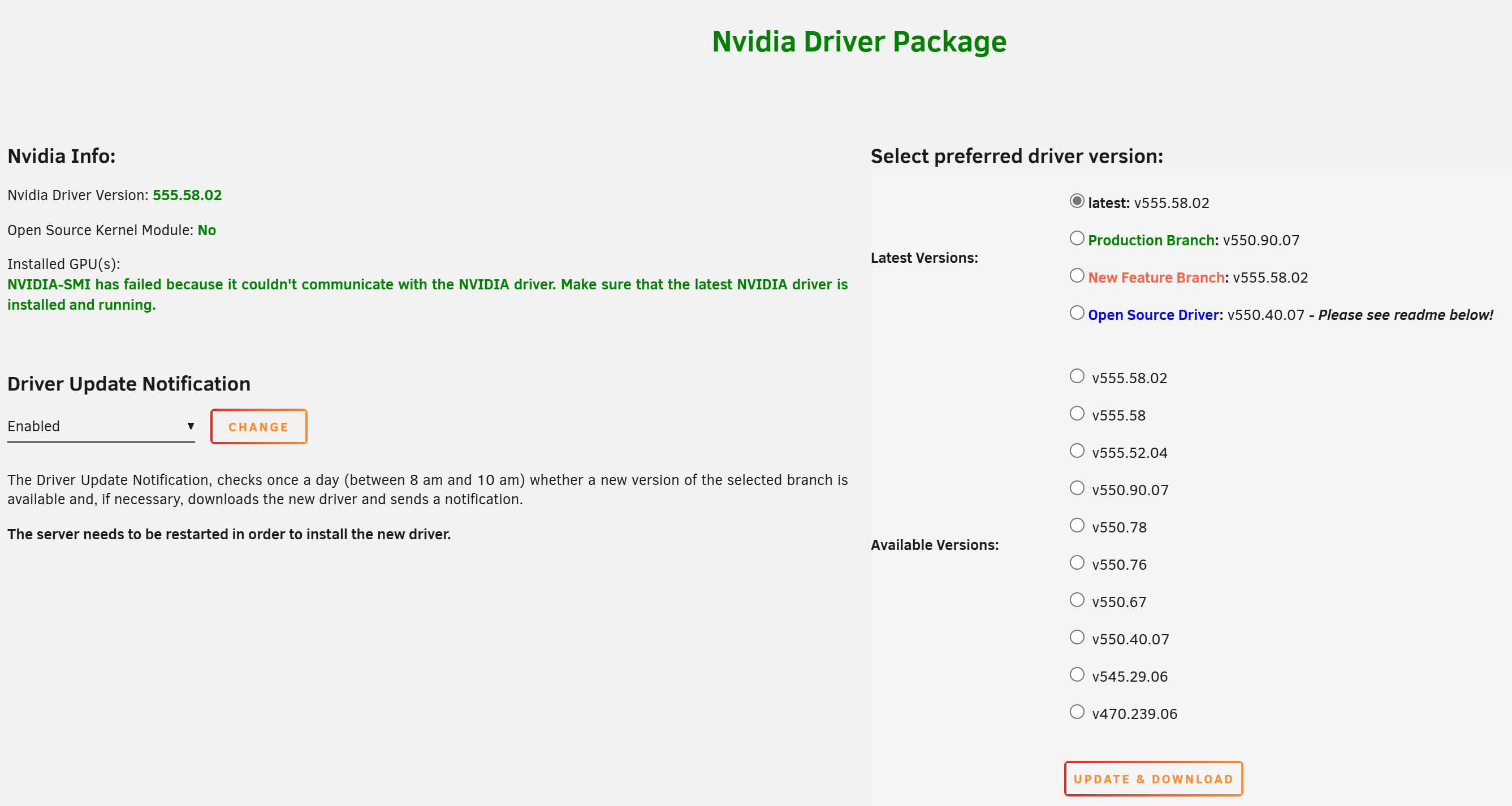

July 6, 20242 yr Author I have tried installing the Nvidia driver plugin from CA but it leaves me with the following error: "NVIDIA-SMI has failed because it couldn't communicate with the NVIDIA driver. Make sure that the latest NVIDIA driver is installed and running" I also tried installing different branches and restarting multiple times with no success. After restarting the docker service, rebooting the server, and adding --runtime=nvidia to my docker containers Extra Parameters, still no GPU is available.
