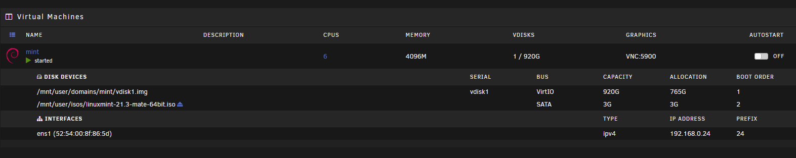

I've set 'Unraid Share Mode' to 9p Mode, and specified the share that I want to see in the VM.image.png.d0974a80e0d58390cb1c8c4f90d3db91.png
Network source is br0, network model is e1000, and I can see an IP has been assigned.

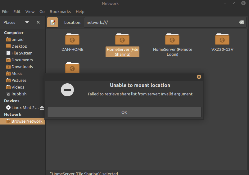

When I jump into the network section of the Linux file explorer, I can see the server as a whole, but can't access it.
I also can't mount it if I manually enter the network location (ip-address/mnt/home/user/VM).
