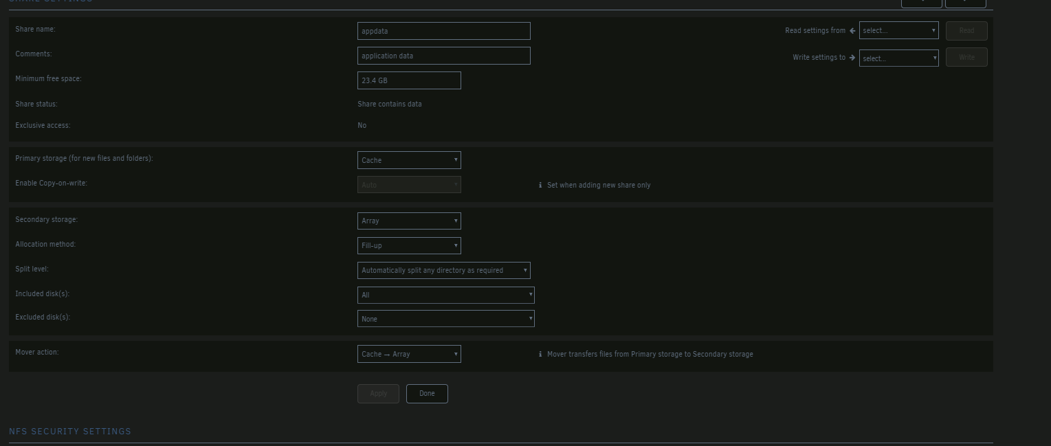

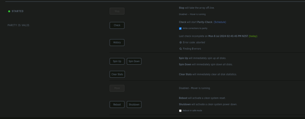

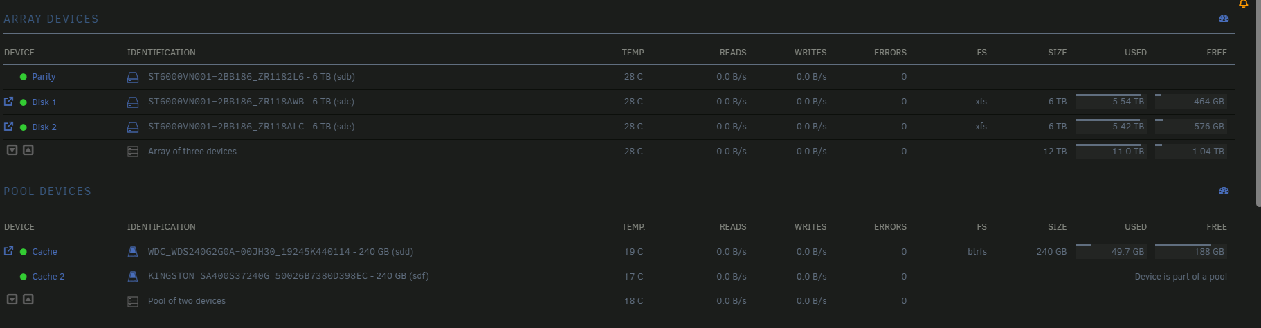

Hey, so I'm currently trying to move my cache drive to the array so I can replace the SSDs with 2 larger ones, however after multiple restarts and settings checks It just sits stagnant and won't move app data, I have docker turned off, and I don't use VM's that is also turned off, and looking at the arrays read and writes its sitting at zero, and isn't moving any data
I've gone into the index to confirm what data is still to be moved and it's just appdata
I have appdata setup as
Primary - Cache
Secondary Array
Mover Cache>Array and still no luck
any help would be appreciated

The diagnostics show that share as:
appdata                           shareUseCache="prefer"  # Share exists on cache
Which disagrees with your screenshot.   I can only suggest you make a trivial change and hit Apply to see if it rectifies the problem
The settings for each share are stored in an appropriately named .cfg file in the config/shares folder on the flash drive.   You can examine this file to see if the Use Cache setting has changed after taking the above action.
