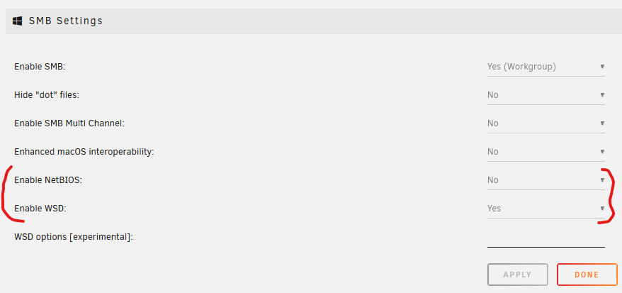

July 23, 20242 yr 56 minutes ago, Elmojo said: But to answer your question, the old Win7 server is running SMBv2 and a lightweight sFTP server for our our large format scanner. You could try this: SETTINGS >>> SMB and in the 'SMB Settings' section, make sure the two marked setting are as shown: This basically turns off SMBv1 support on the Unraid server. It will force the server to SMBv2 or higher.
July 23, 20242 yr Author 3 hours ago, Frank1940 said: You could try this: SETTINGS >>> SMB and in the 'SMB Settings' section, make sure the two marked setting are as shown: Yep, mine looks like that, with the exception that I also have SMB multichannel and the macOS thing turned on. Otherwise, it's the same.
July 23, 20242 yr 17 minutes ago, Elmojo said: SMB multichannel As I recall, this being enabled has given problems in the past... (I assume that you have macOS computers on the network otherwise its use can cause be problematic.)
