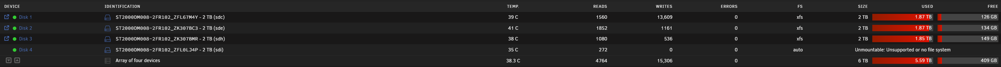

What would cause this message? Did I accidentally ruin the filesystem on this disk?
Edited by nrgbistro
Looks like there's no valid filesystem on that disk, post the output of:
