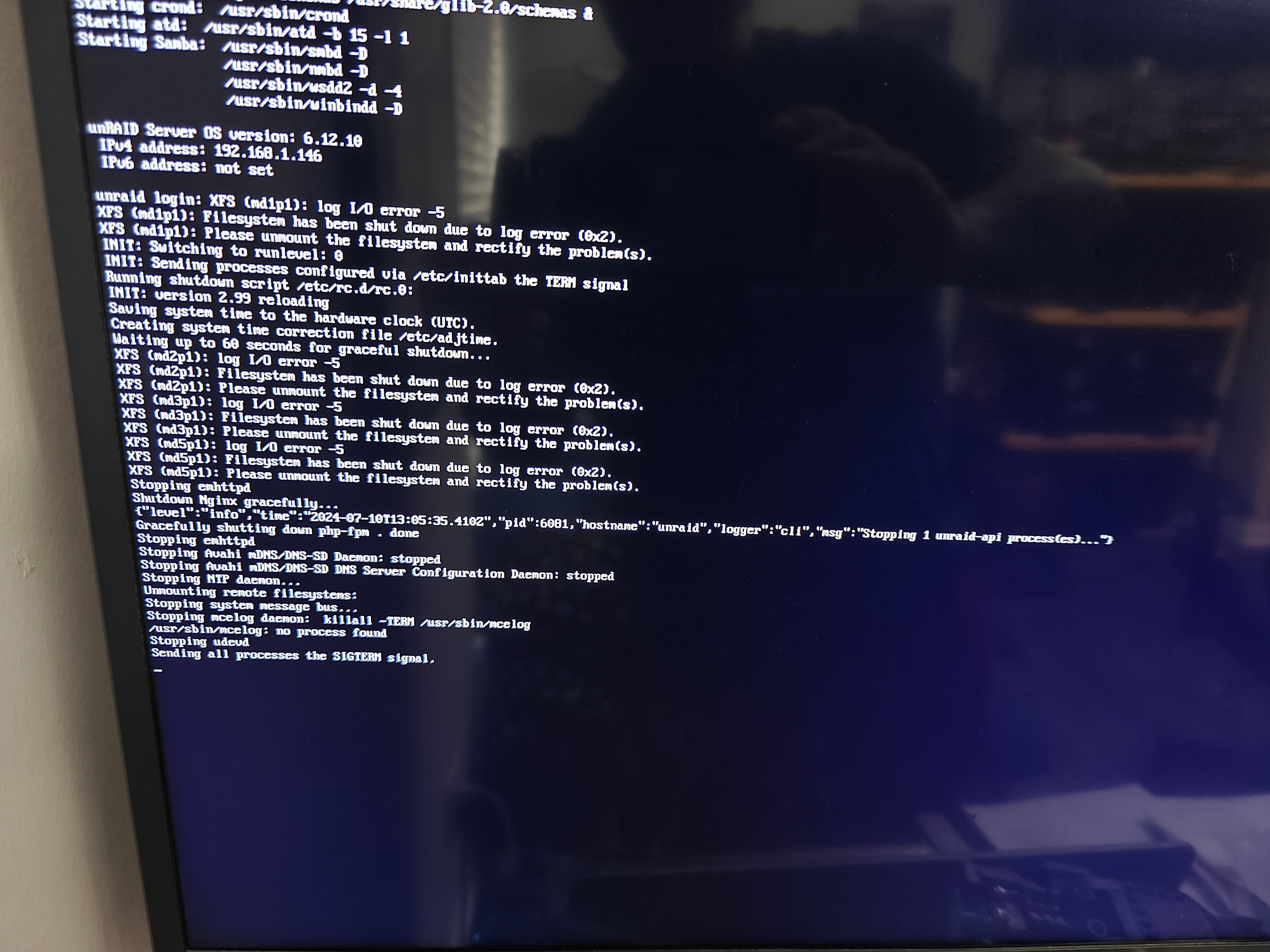

I've had this server for approximately 10+ years without issue, and this is a fresh mainboard CPU etc from about 4 years ago...  Any help is appreciated.  Upon boot up this morning I noticed something odd in the screen logs (unraid.4.jpg) - any help is appreciated.

Jul 10 06:02:26 unraid kernel: r8169 0000:08:00.0 eth0: rtl_chipcmd_cond == 1 (loop: 100, delay: 100).
Jul 10 06:02:26 unraid kernel: r8169 0000:08:00.0 eth0: rtl_ephyar_cond == 1 (loop: 100, delay: 10).
### [PREVIOUS LINE REPEATED 5 TIMES] ###
Jul 10 06:02:26 unraid kernel: r8169 0000:08:00.0 eth0: rtl_eriar_cond == 1 (loop: 100, delay: 100).
Looks like a NIC problem, try with an ad-don NIC if available.
Thanks, moderator.  I was trying to find a URL for the hw recommendations.   I350 Intel chipset, but I'd love some recommendations.  I assume the disk disablement is because of this, and I have to do a rebuild once I get the new NIC?
