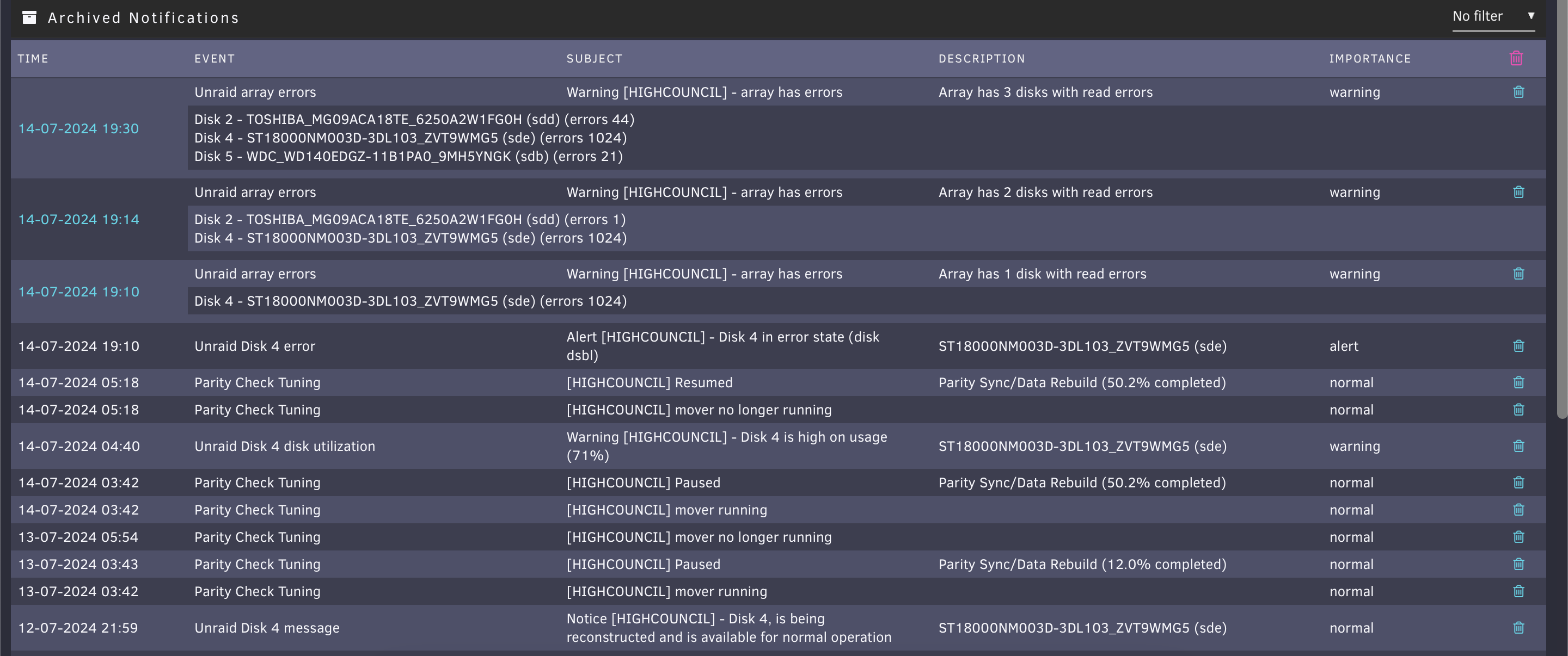

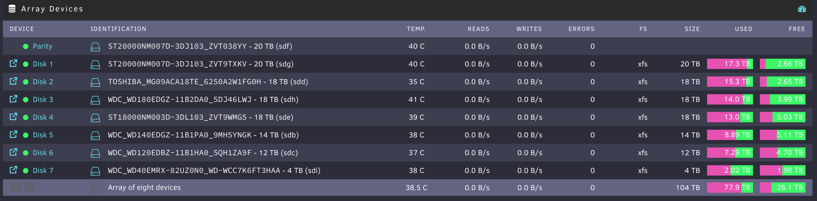

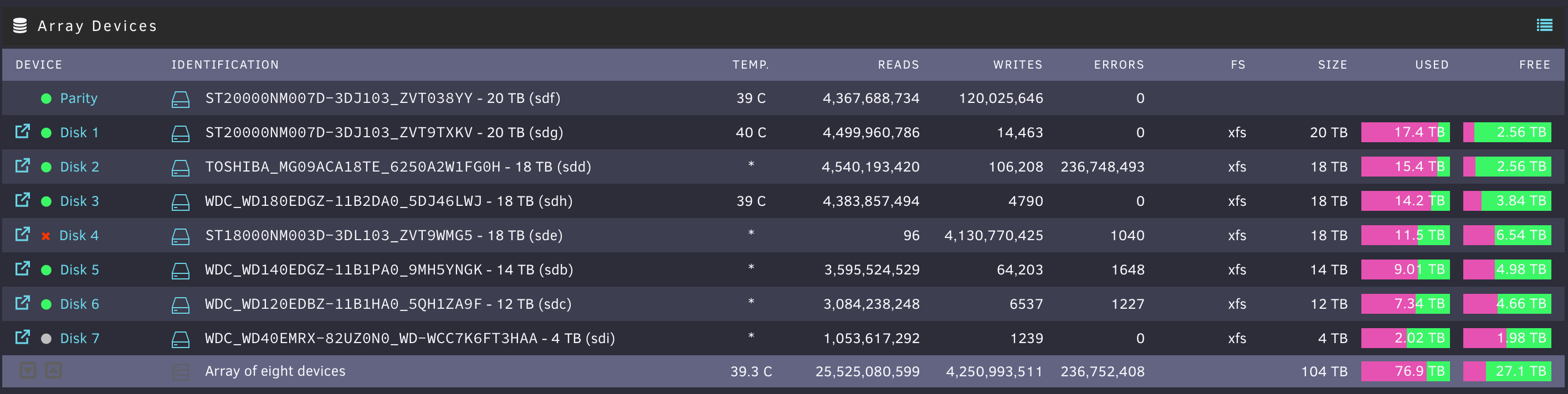

July 12, 20242 yr I've attached the diagnostics. I moved states and have had some significant issues with all of my hardware since. The NAS was running just fine for about 15 days when suddenly I got the following email: Event: Unraid Disk 4 error Subject: Alert [HIGHCOUNCIL] - Disk 4 in error state (disk dsbl) Description: WDC_WD160EDGZ-11B2DA0_2CJW32SN (sde) Importance: alert One day later Disk 4 has gone fully offline with this message: Event: Unraid Disk 4 SMART health [199] Subject: Warning [HIGHCOUNCIL] - udma crc error count is 12887 Description: WDC_WD160EDGZ-11B2DA0_2CJW32SN (sde) Importance: warning I tried to reconstruct (hoping it was not too far gone and that instead some sort bit flipping occurred during the move (I'm not a scientist), then all the others disks started yelling at me: Event: Unraid array errors Subject: Warning [HIGHCOUNCIL] - array has errors Description: Array has 3 disks with read errors Importance: warning Disk 2 - TOSHIBA_MG09ACA18TE_6250A2W1FG0H (sdd) (errors 1182331) Disk 5 - WDC_WD140EDGZ-11B1PA0_9MH5YNGK (sdc) (errors 1098564) Disk 6 - WDC_WD120EDBZ-11B1HA0_5QH1ZA9F (sdb) (errors 1141679) Then a moment later it seemed fine Event: Unraid array errors Subject: Notice [HIGHCOUNCIL] - array turned good Description: Array has 0 disks with read errors Importance: normal But that was obviously a false positive because it quickly turned back around: Event: Unraid Disk 4 SMART health [199] Subject: Warning [HIGHCOUNCIL] - udma crc error count is 13091 Description: WDC_WD160EDGZ-11B2DA0_2CJW32SN (sde) Importance: warning I decided to replace Disk 4 since it was the first to cry wolf, but I'm not sure that was the actual problem because here we are again: 7/9/24 Event: Unraid Disk 4 message Subject: Notice [HIGHCOUNCIL] - Disk 4, is being reconstructed and is available for normal operation Description: ST18000NM003D-3DL103_ZVT9WMG5 (sde) Importance: normal 7/11/24 Event: Unraid Disk 4 error Subject: Alert [HIGHCOUNCIL] - Disk 4 in error state (disk dsbl) Description: ST18000NM003D-3DL103_ZVT9WMG5 (sde) Importance: alert Event: Unraid array errors Subject: Warning [HIGHCOUNCIL] - array has errors Description: Array has 4 disks with read errors Importance: warning Disk 2 - TOSHIBA_MG09ACA18TE_6250A2W1FG0H (sdd) (errors 7245) Disk 4 - ST18000NM003D-3DL103_ZVT9WMG5 (sde) (errors 1040) Disk 5 - WDC_WD140EDGZ-11B1PA0_9MH5YNGK (sdb) (errors 1645) Disk 6 - WDC_WD120EDBZ-11B1HA0_5QH1ZA9F (sdc) (errors 1227) Is the cable for my HBA bad? Or did the TOSHIBA_MG09ACA18TE_6250A2W1FG0H go bad simultaneously with Disk 4 and cause problems? Right now it's completing a read-check on the 20 TB parity drive and moving at a rate of 29.5 MB/s (it raced up to 80% and has been moving at a snails pace since.) highcouncil-diagnostics-20240711-1805.zip Edited July 12, 20242 yr by MrSaiclops Needed to add version number in title
July 12, 20242 yr Community Expert Problems at the same time with disks 2, 4, 5 and 6, they all dropped offline, so power/cable/controller are the main suspects.

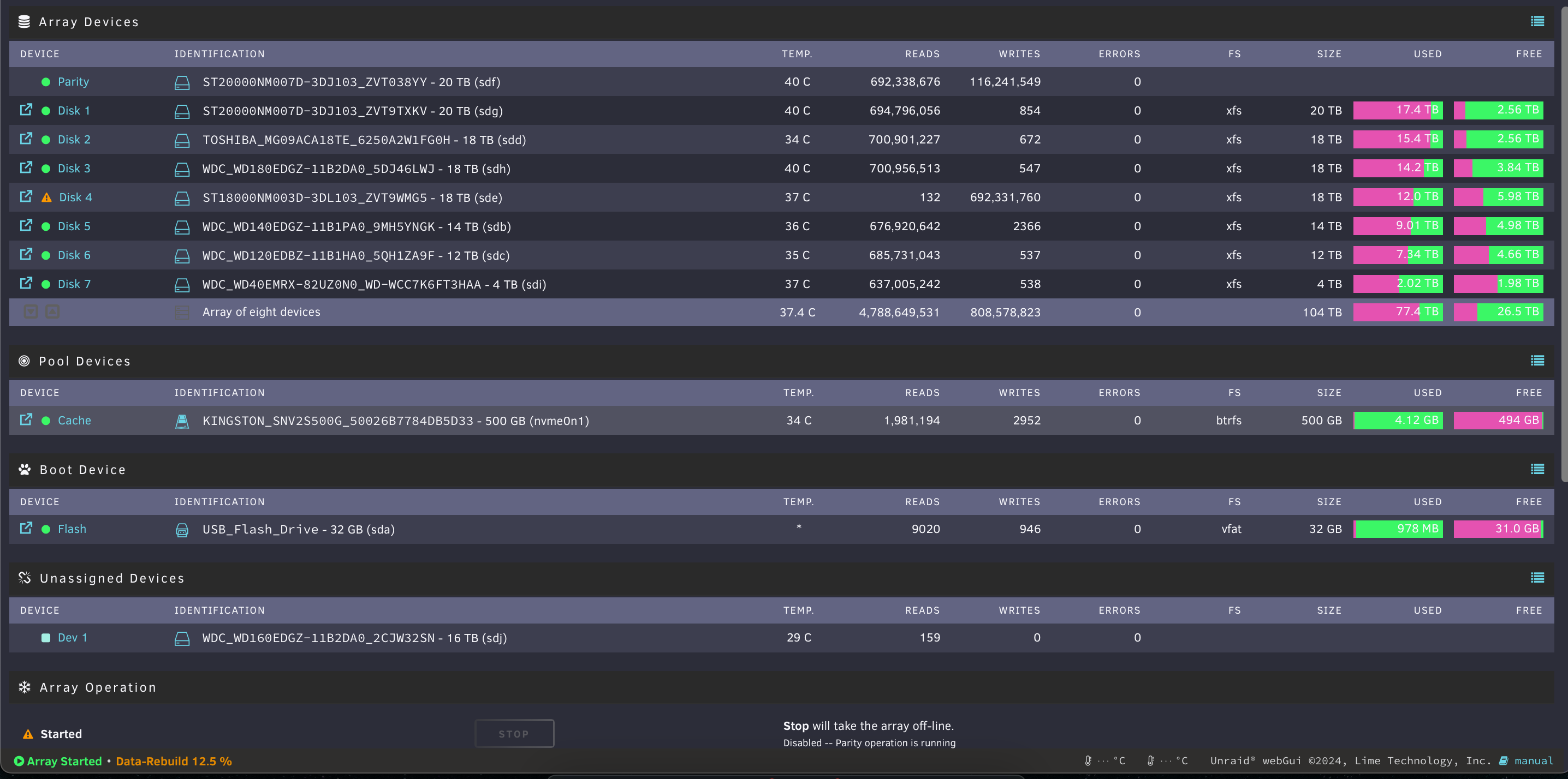

July 13, 20242 yr Author 12 hours ago, JorgeB said: If you didn't yest reboot since the first diags, you need to do it, do bring the dropped disks online. Alright, here it is with the old disk 4 plugged in as well. Should I stop the array and attempt to rebuild with the new drive? highcouncil-diagnostics-20240712-0759.zip
July 13, 20242 yr Author 5 hours ago, JorgeB said: ... wrong ones? Here are some from this morning. If it's still not correct then I'm not sure. highcouncil-diagnostics-20240713-0610.zip
July 14, 20242 yr Community Expert Everything looks good so far, see if the rebuild finishes without any errors.
July 15, 20242 yr Author 18 hours ago, JorgeB said: ... see if the rebuild finishes without any errors. Got to ~70% and then encountered errors again. I have the alternate SAS cable, should I shut down the array and try swapping it out? Diagnostics attached highcouncil-diagnostics-20240714-1934.zip
July 15, 20242 yr Community Expert Looks like all four disks dropped again, It may be a controller issue, or power
