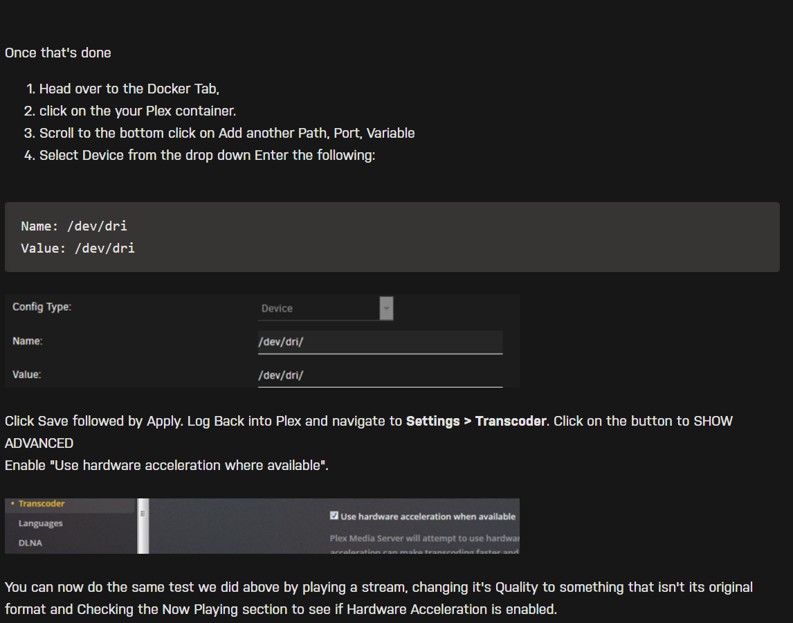

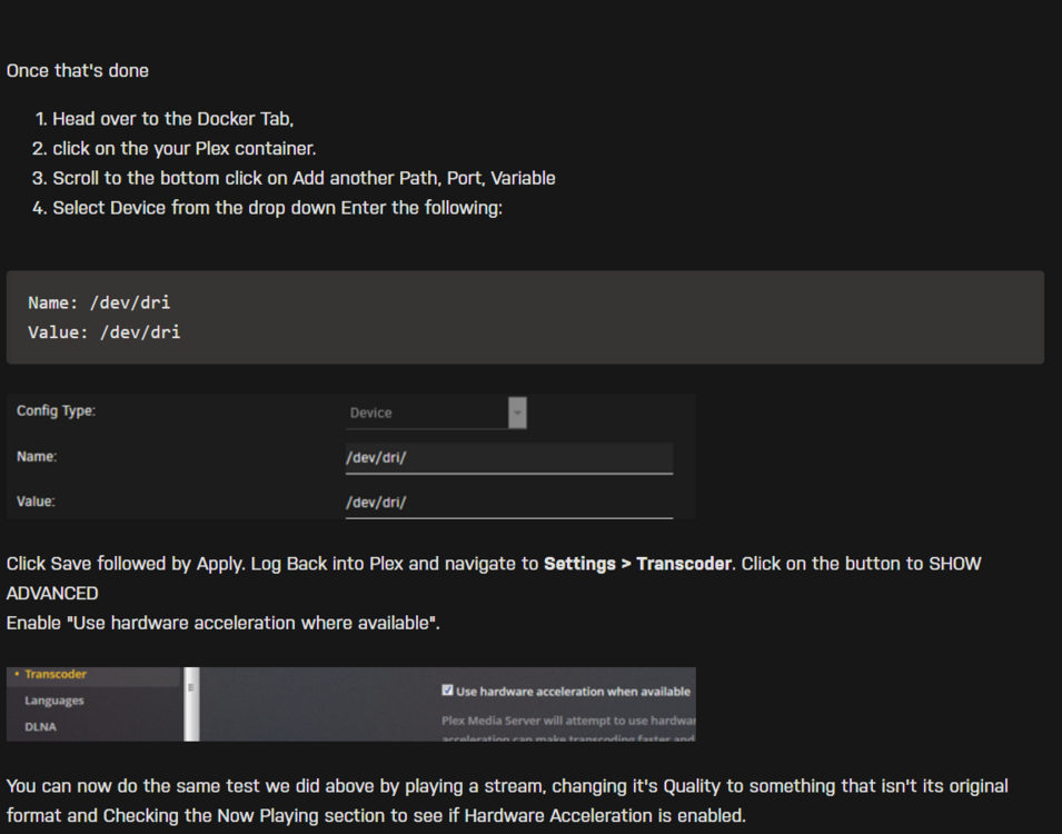

July 14, 20242 yr Community Expert Solution 13 minutes ago, BaronvonOttobat said: Through the Transcoder settings in Plex, there is a dropdown box for choosing which processing unit will do the work. Currently only "auto" is selectable. Are you using a Plex docker? What do you have defined in the docker template. Maybe in extras etc.
July 14, 20242 yr Author That's got it, thank you! I hadn't set it as "device" when I added the "/dev/dri"
