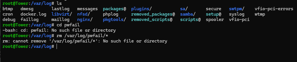

Thanks for the response, but unfortunately that directory doesn't exist.

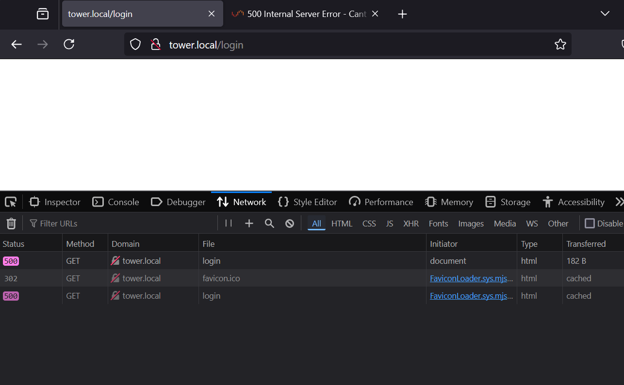

Oh, not the problem I thought then.
Thanks for the screenshot. Can you clarify, are you trying to access http://tower.local or https://tower.local ?  If you have disabled SSL then only the http url will work
Also, try clearing your browser cache or using Private/Incognito mode after disabling SSL.  Sometimes browsers remember things they shouldn't.
