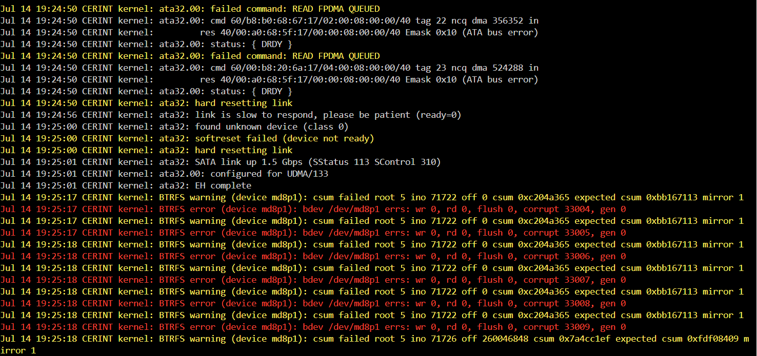

July 14, 20242 yr I am getting the logs filled with errors all of the sudden. kernel: BTRFS error (device md8p1): bdev /dev/md8p1 errs: wr 0, rd 0, flush 0, corrupt 32996, gen 0 and failed command: READ FPDMA QUEUED something very odds that I can not find what device is md8p1. its not listed in the tools-> system devices page. I can find the ata32, i think, its the [32:0:0:0] disk ATA ST4000NE001-2MA1 EN01 /dev/sdi 4.00TB but no idea what the md8p1 could be. Also a prity sync is running at the moment and the speed varies from 140 MB/sec to under 5 MB/sec. Any help figuring out what the problem is would be greatly appreciated. Diagnostics are attached. cerint-diagnostics-20240714-1923.zip Edited July 14, 20242 yr by [email protected] added more info
July 14, 20242 yr Community Expert md8 is disk8 on the Main tab. The /dev/md? type devices are created by the Unraid driver for each disk in the main array when it is started.

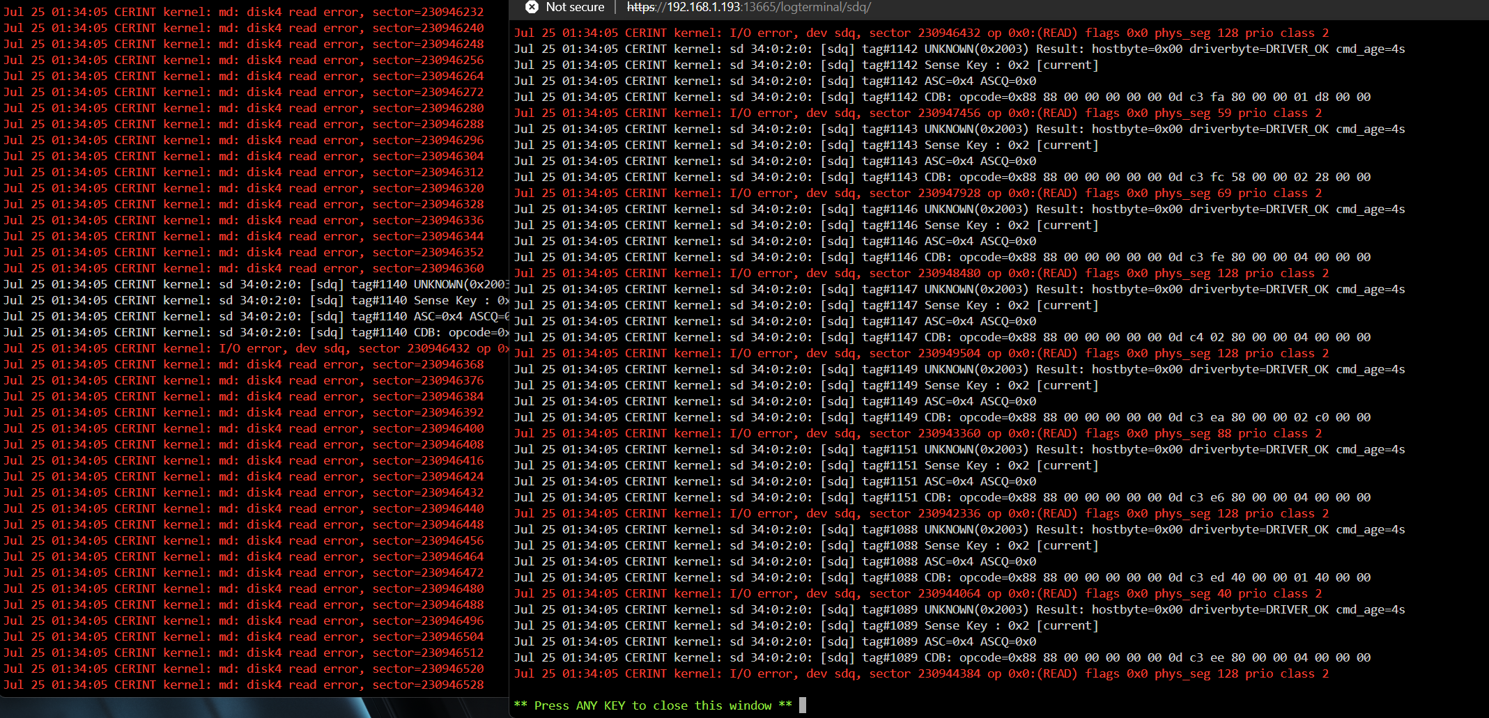

July 25, 20242 yr Author SO i removed all the drives and started adding them back in one by one. Each time doing a "new config" and re-creating the parity. I am at the point where i added drive number 6 and during the parity sync it started showing read errors. I moved the drive to a different slot in tha case and got read errors again. So its not the cables as each slot is connected to a different port/cable. Any other thoughts? Thanks, G

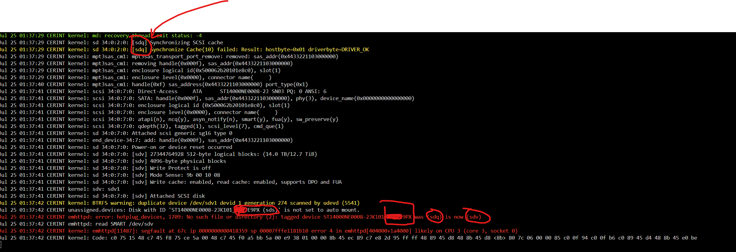

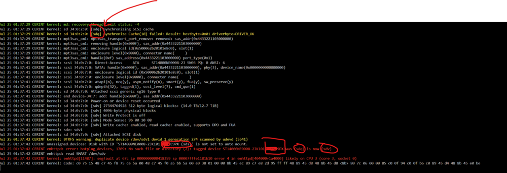

July 25, 20242 yr Author Pausing and resuming the sync and pausing again created the following log: sdq is the drive in the array that now was the read errors. no idea what this log actually means and why it is saying that sdq is now sdv when in the array its still sdq
July 25, 20242 yr Community Expert If you have used different cables/slot and the errors persist it may be the disk.

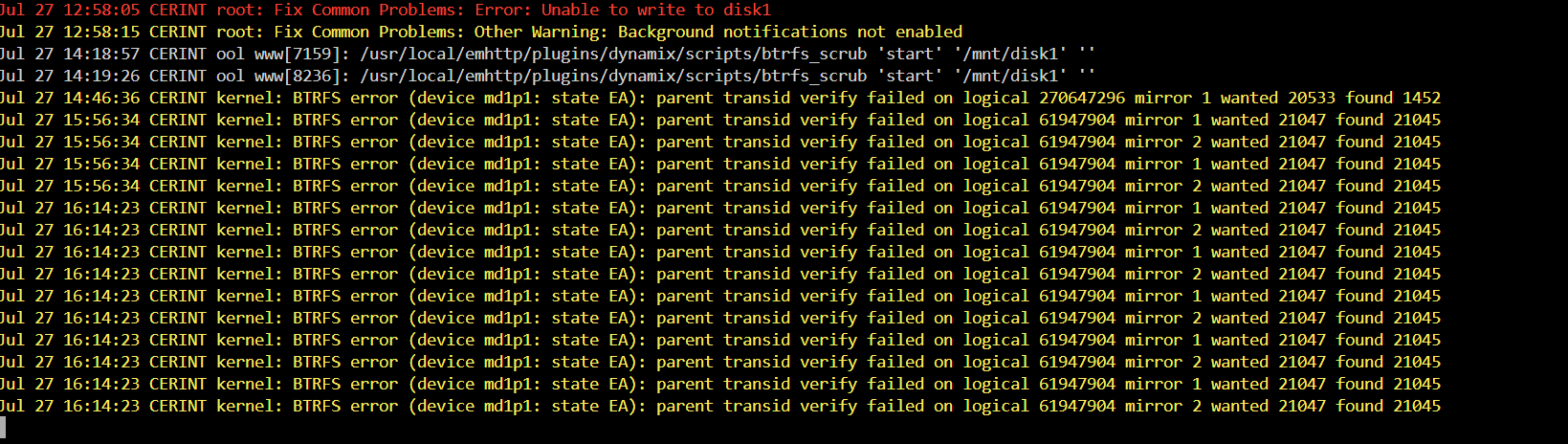

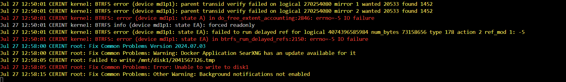

July 27, 20242 yr Author I did a reboot and got some new errors now: For some reason disk 1 is now read only

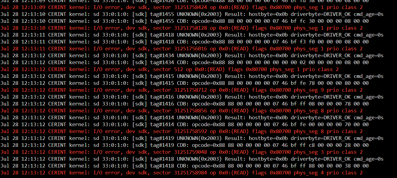

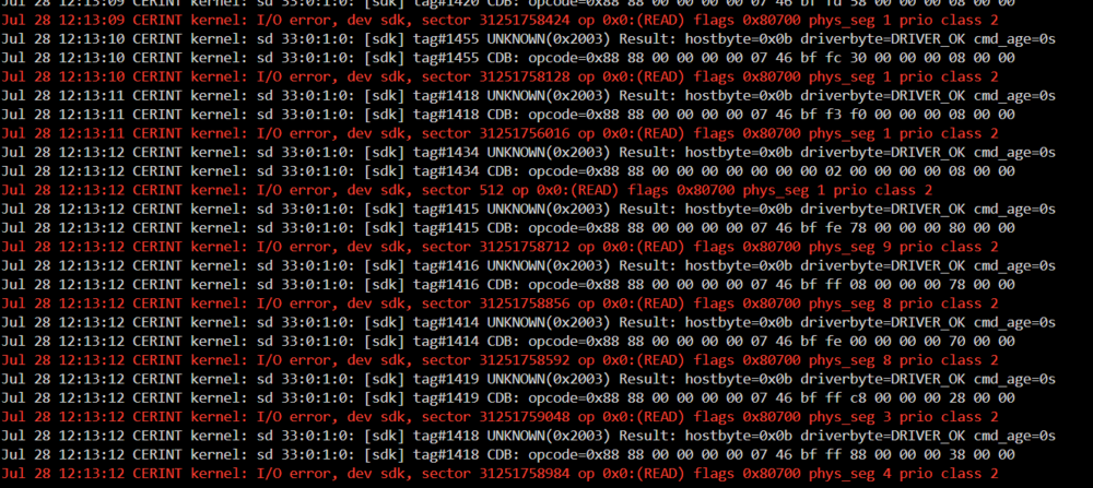

July 28, 20242 yr Author 20 hours ago, JonathanM said: Maybe the power got overloaded? How many drives do you have on each PSU lead? What size is your PSU? Any splitters? What kind? Molex-SATA or SATA-SATA? Got a corsair 850watt brand new. in total its 12SSDs and 12HDDs 2 power leads from the PSU, 1 molex and 1 sata with adaptor. Also i run a parity sync the day before and was fine (no read errors, and no errors in logs) and today with the same drives same config, run parity sync again and i am getting : kernel: I/O error, dev sdk, sector 31251758424 op 0x0:(READ) flags 0x80700 phys_seg 1 prio class 2 on an array drive that never before had any errors. can figure this out. from the moment i build this new server it has been a pain. I may need to scrap it and start new at this point.
