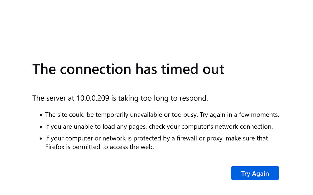

Please provide a screenshot of the error message your browser gives when you access this url:
  http://10.0.0.209
(note, the url must start with http not https)
It looks like you might have tried tailscale at one point? There are some remnants that could be causing networking issues
From SSH type:
rm /boot/config/network-extra.cfg
reboot
If there are still issues please provide fresh diagnostics after the reboot
