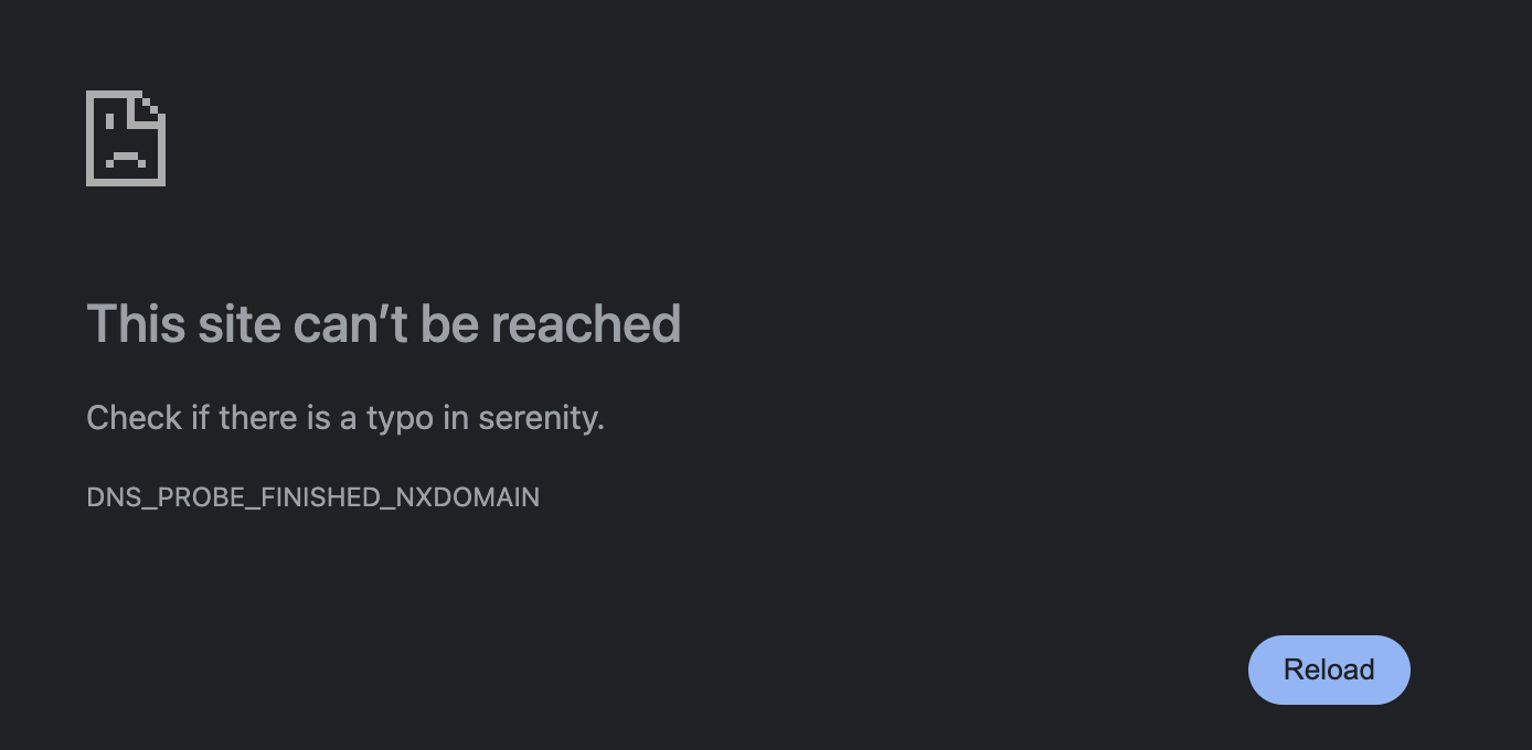

Last night i could access my login screen and login (all functioning correctly), this morning i could not.
Symptoms/details:
  • When accessing via ip my browser window just hangs, no error, just nothing
  • When accessing via server name i get error in screenshot (serenity is the server name)
  • have tried http and https for both
