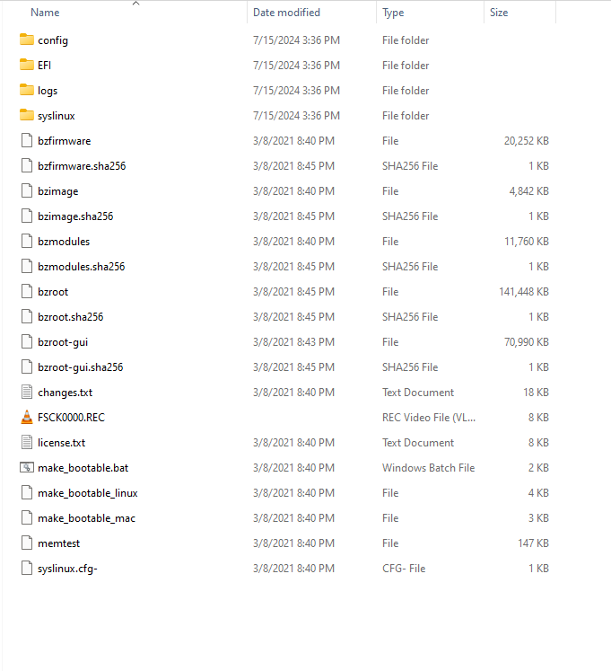

July 15, 20242 yr Ihave a sandisk USB drive that was 16gb and I think it went kaput. Can't boot unraid. I tried to use a backup of the USB but the only backup I have is like 6 years old. When I boot my server it first tries to run the ssd (Cache drive) but I stop that and go to my backup usb and it still says no operating system. I don't have a complex set up only thing really important is Plex and a foundry server. I just want to be able to access my drives. Is there any way to fix this. Worried as there is a but of data I don't want to lose. I'm assuming it's still there it's just my startup that is borked and I can get the data. I am a novice here but Unraid has always been pretty good so I hope someone can assist. I basically can't get unraid to start.
July 15, 20242 yr Author I shoudl add the back up USB created I can plug in and see files. The old one says it can not be read.
