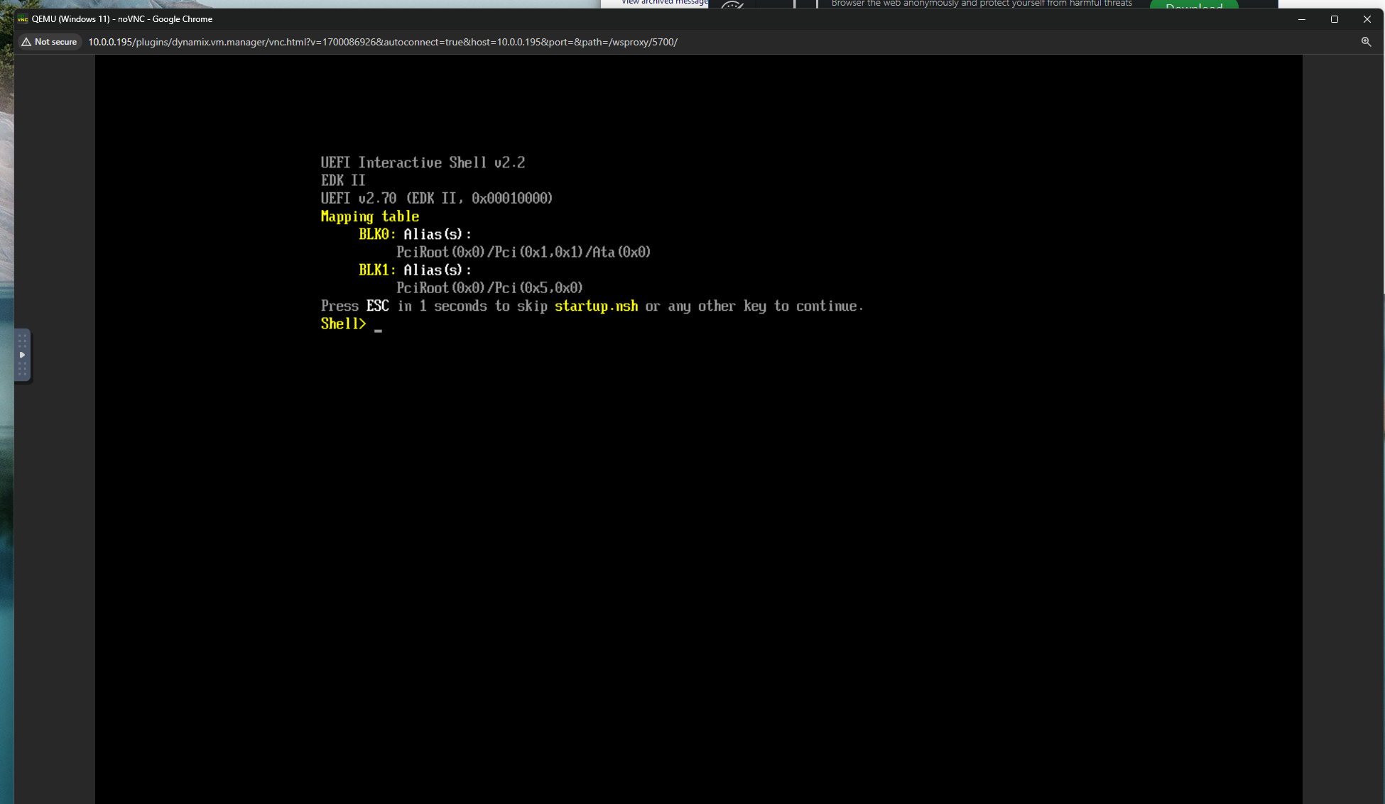

So i set it up according to several videos i watched. and......it won't install the os.
I'm not sure how to post my screen shot, but it says.
Assuming you have attached cd, did you set bus to sata? if yes type reset and the press any key should show and load the cd.

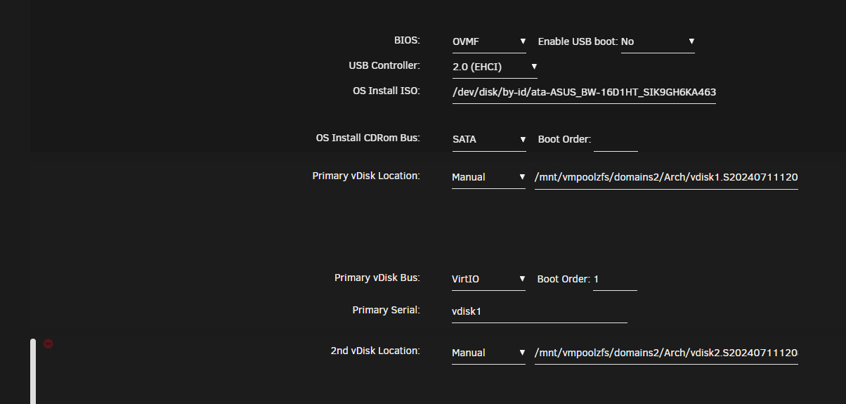

Actually when I type in reset, it will not allow me to press the enter key to execute anything.  I have tried pressing both the escape and other keys, neither works..  But a thought did occur to me, maybe i got the boot order reversed?   how would I check that?
Next to each of the lines. But should not make any difference if no bootable system on HDD should goto CD.
After double checking, it turns out I had put the vertio twice, but I am still getting the exact same screen, and it will not let me enter anything into the terminal window
You should make sure that the cd has 1 in the boot order field.
