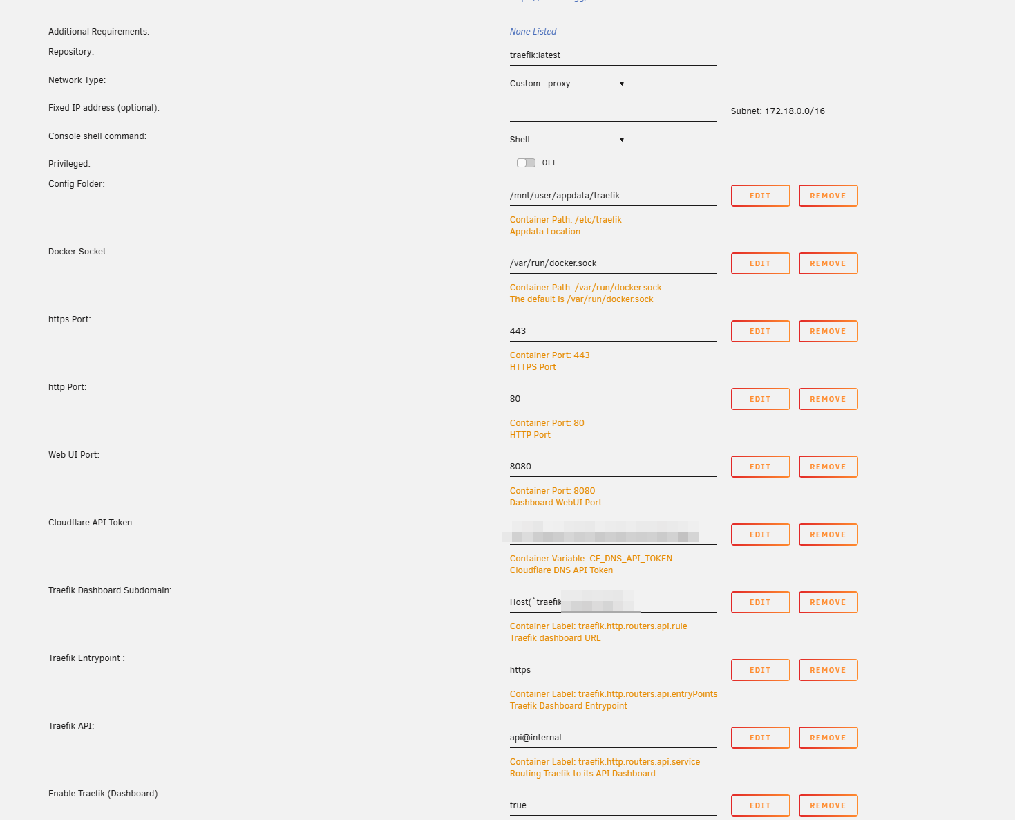

Docker config :

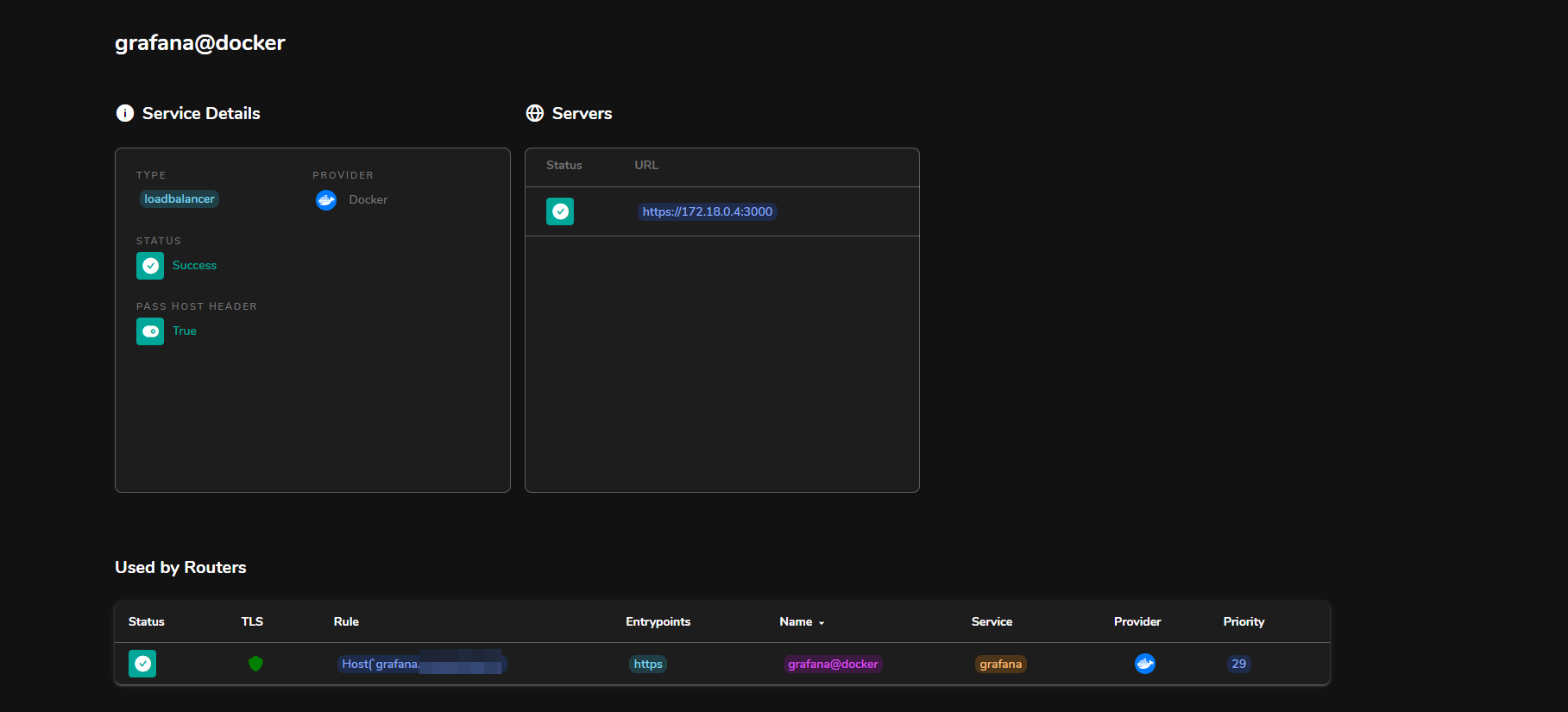

Traefik dashboard showing grafana service:
