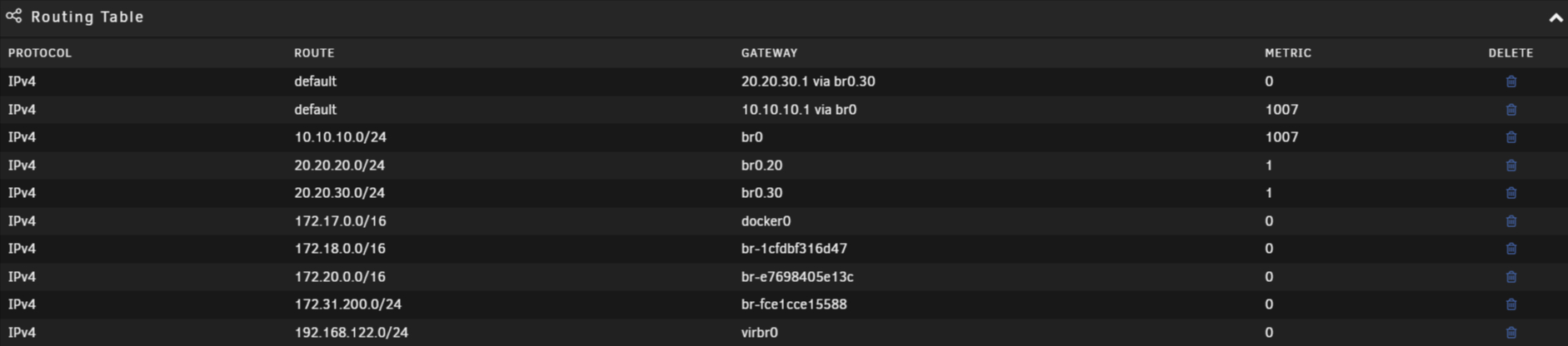

How I go back to the default gateway?
I don't know how to return it to the default gateway 10.10.10.1 via br0.
Currently, all of my Internet traffic with Unraid goes through the wrong VLAN (20.20.30.1)
Solved by JorgeB
You can go back to defaults by renaming/deleting /boot/config/network.cfg and rebooting

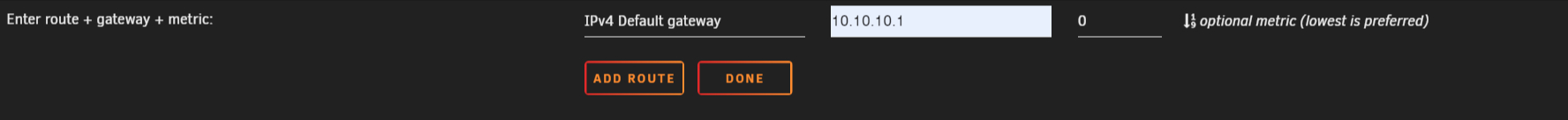

Instead stop array, go to network settings and edit the preference number of the gateways
"The lower lance wins" they say, so give the 20.20... entry a value like 5000 and make 10.10... 1 or so.
Thats all.
With your "0" you have think you have disabled the entry currently, but there is a bug in UNRAID, 0 means highest priority of all....
Somebody should change the misleading info text someday.

When I want to enter a new gateway this way and press ADD, nothing happens
And when I click on the trash icon, nothing happens.
How to change the Metric value, when "20.20.30.1 via br0.30" is already set to "0"
I told you: Stop array, go to network settings, edit entry for 20.20...
I did that, and nothing happens
I solved with rename file /boot/config/network.cfg.
But I'm very interested, why it doesn't work from the GUI.

I think you actually have to disable the Docker services in the SETTINGS  >>  Docker
